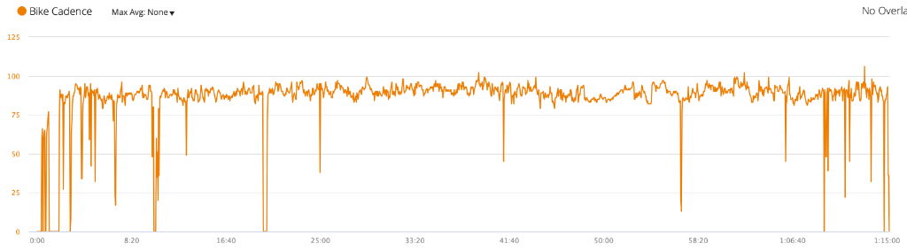

I purchased a Garmin Cadence 2 sensor. I installed it on my crank arm and then I did a sensor pairing with my PowerPod. The new cadence sensor was found; I confirmed this by checking the wireless IDs in my unit..
I did a ride and had no problems with cadence signal.
So, I am stumped.
So, I am stumped.
Re: Powerpod V3 causing drops in estimated cadence
Thank you for the followup.

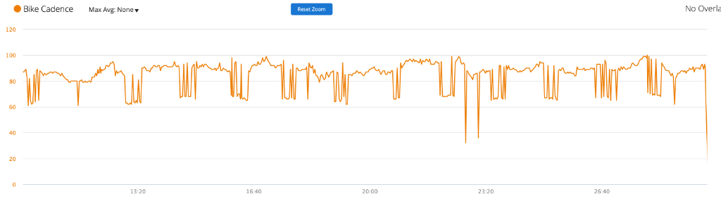

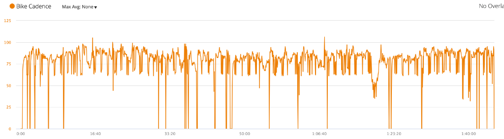

I've since recalibrated and paired without the cadence data going to the PowerPod (also tried recalibrating with cadence: still had a problem). Garmin Connect cadence looks right.
I looked at a few other rides. Looks like T ~= 90 s, sometimes dipping down to ~30 seconds, with typical displayed values between 64-67 (though Garmin Connect shows occasional local minima of 61).
One thing I just noticed: when I recalibrated, I neglected to change the profile to get HiDef recordings. Possibly something there?
- Zoomed in to show periods (PP was recording cadence)
- zoom.png (58.26 KiB) Viewed 31458 times
- PP wasn't recording cadence
- no_cadence.png (67.51 KiB) Viewed 31458 times
- PP was recording cadence
- cadence.png (97.85 KiB) Viewed 31458 times

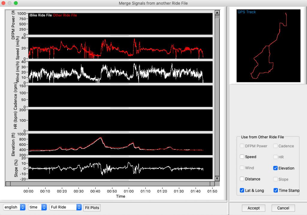

...and also just noticed I can't merge the cadence and heart rate data with one of the non-HiDef files. Is that expected?
...and also realized I don't know how I got HiDef files in the first place.
- Screen Shot 2020-08-14 at 9.09.27 AM.png (242.46 KiB) Viewed 31458 times

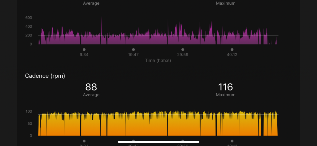

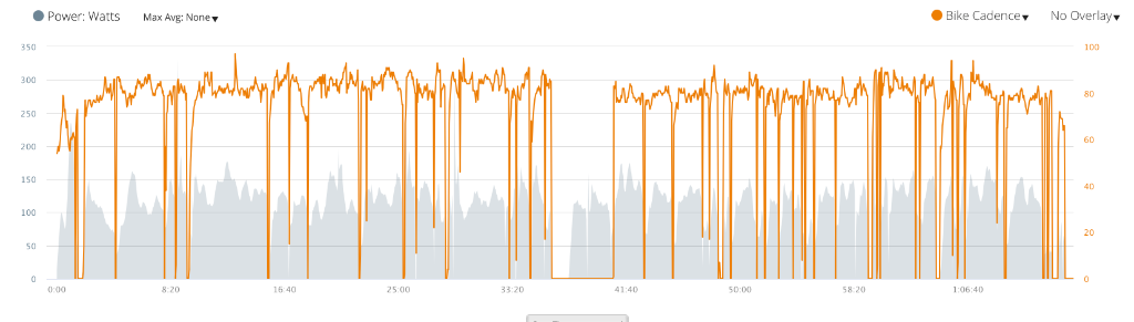

So I finally have an example of this issue.
I have a screen capture of Garmin Connect output from the ride - showing cadence lost at about 36 minutes for ~4 minutes - but power (only coming from PP3) that lasted about 1 minute - so I think there is some evidence that PP3 was seeing cadence ===
However on the Isaac output, at the 36 minute mark, cadence drops to zero for the full ~4 minutes, and power for only about a minute.
Trying to repair the missing cadence in Isaac turns into a mess.

SilasGreenback
- Posts: 49
- Joined: Fri May 22, 2020 11:55 am
Exposed a bug or is the bug?
Not convinced PP is the problem. Here’s my cadence 2 paired directly to my edge 1030. Check out the regular drops. I just think the garmin handles the drops better than PP and hides it better when theres a signal break.
I’m going back to magnets....just as soon as i can find the damn thing in my bike parts stash.
- 2B82633B-3934-49CE-A063-EA7280D8DA36.png (257.49 KiB) Viewed 31068 times
