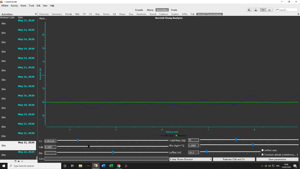

I was really hoping to be able to do this, and here's why ....
I've been using AeroLab for years. I ride a traffic free dedicated cycling circuit for my aero tests. The undulations every lap give me a good pictorial view for lining up traces and seeing and spurious data. See attached example (that's SRM data via a PC8 with a rear wheel speed sensor).
Last year I did a set of tests and got one result that was obliviously an outlier. Looking at the data it was clear that I had a bit of tail wind down a straight but I was not getting the corresponding head wind on the other side of the track (sheltered by trees / bushes). I manually (painstakingly) adjusted the speed for the tail wind sections of the test laps, and hey presto the CdA came back to what it should have been.
So I figured I'd get an AeroPod as that would give me wind speed data that I could use and / or compare to ground speed data. I undertaken a series of test session in the past 10 days. Data all looks good but when it comes to exporting the .txc file it contains ground speed from the wheel sensor.
I will try pairing / calibrating and then taking the wheel sensor off but I suspect that is either going to result in no speed or just no data at all.
Anybody got a solution for exporting DFPM data and wind speed please?
Incidentally on Zwift I am FloatAero (Rob). My aero blog is FloatAero.
Thanks Rob
Screenshot (616).png (91.96 KiB) Viewed 7605 times

Have you tried exporting a csv file from Isaac?
Re: Exporting DFPM and wind speed data
texbiker wrote: Sun May 24, 2020 11:41 am Have you tried exporting a csv file from Isaac?
csv file does have wind speed data in it.
