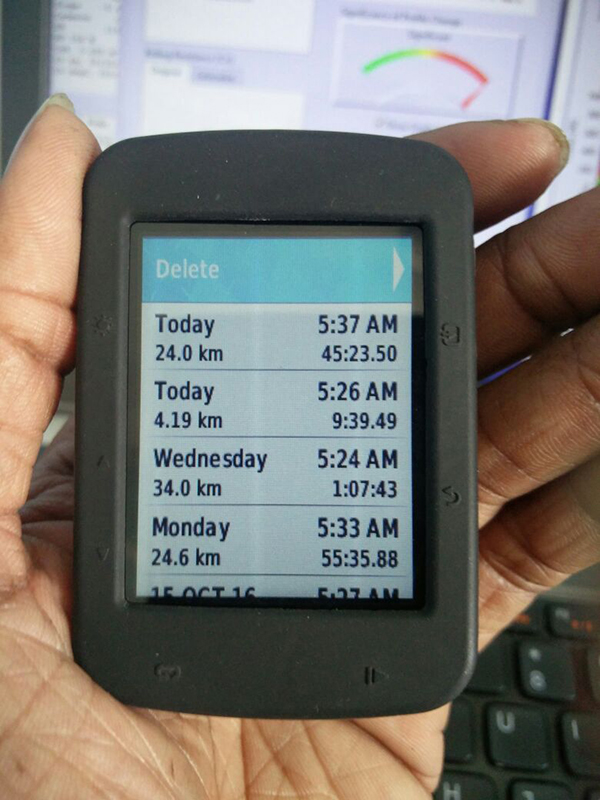

Things didnt go smooth today.
I started the ride today for FTP assesment and for close to 20 mins i didnt not get power values from PP to garmin. Even before start of ride I spun the wheel and cranked manually to see the symbols of cadence, speed n HRM on Garmin an then connected PP to Garmin. PP also showed stable green light. No power values came though. And green light too went off and there was no light on pp. on pressing PP button each time it was stable green light. I thought something was wrong and had to stop my ride 2 times and i tried to re pair my sensors and garmin again and still in the final ride for 10 mins i didnt get power values and all of a sudden the power values show up on the garmin and from there it was showing for full ride....Any idea on this weird behaviour?
I am enclosing 3 ride files here first 2 are ones where power values dont show up at all where i had to stop and repair the garmin and 3 one is 34km ride where after 10mins powervalues show up in issac. Still the wind info says i predominantly rode in tailwind which is not the case. It was a solo ride to estimate FTP and i rode only on hoods of my bike
Kindly Please help me

Re: Newbie to Power Can someone help me set up PP correctly
Patience is what is needed here. Your PP recalibrates itself during the first 8 minutes of each ride.
Your "0km" ride files show zero power for the first 8 minutes of the ride.
Your "34km" ride shows proper power after the calibration period. HOWEVER, your unit is struggling "hard" with its internal slope correction algorithms. This needs to be corrected by resetting your device and doing a new master calibration.
Please do the following:
1) Attach PP to your mount, following the instructions that requestyou gently rotate it forward so that it is locked into position. Tighten the screw so PP cannot rotate.
2) Loosen the mount screws, and rotate your mount so that the word "PowerPod" is reasonably level (+/- 10 degrees) to the ground beneath it. Eyeball estimates are fine. Tighten the mount screws, and confirm that the mount and PP cannot rotate.
3) Attach PP to Isaac. Reset your profile using the command "Device/Setup/Reset Profile-Device". Then, reset Profile 1 (I assume this is the profile you are using). This will restore this profile to factory conditions
4) You will now have to re-pair the sensors, and do another five minute calibration ride. Do these things, and then a short ride thereafter.
5) Post the ride file here and i will check wind calibration

Ride information I did 2 rides
First one 4.19 Kms for calibration and it was out and back ride to same spot. Solo ride, No drafting. But calibration finished just after i "U" turned to return back to the starting point
Do i have to make a strict OUT and BACK calibration ride in such a way that it finishes at 100 at the start point when i return back?...Please let me know if i have to do that
The second ride was for 24kms, Solo ride, no Drafting Predominantly in Zone 3 and 4 of my Heart Rate which was also a Out and Back ride to same spot.Rode predominantly on hoods very marginally on return on drops due to head winds.
The powerpod unfortunately recorded both rides as one file despite me saving 2 separate rides in garmin and clicking on powerpod button( probably i did not press it enough)
So the ride file shows 29kms ride. Here is the file below for your use
Sorry, I looked at this yesterday and failed to make a posting.
You need to load a corrected profile into your unit, attached. Do another ride and then post. All should be well.
By the way: as you discovered, PP records one long ride file, even when you have two files in your Garmin. Making multiple files in the Garmin does not change PP file structure.
drashkum102316.ibp
(525 Bytes) Downloaded 486 times
I used the "Analyze/Check Calibration" command to correct your wind scaling factor.
PP records one long ride, unless it is asleep for 20 minutes, after which it automatically starts a new ride. So, you'll have to split things in Isaac.
