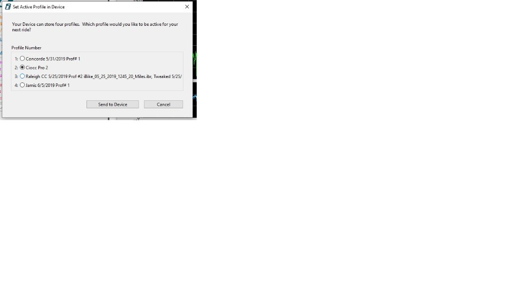

Device Profiles.jpg (21.8 KiB) Viewed 7766 times
THanks John, Ill give that a try. This is whats showing now.
Re: Setting 4 profiles in my Upgraded PP.
Please post the .ibp files

Ok John, I think I mis-understood the intruction.
