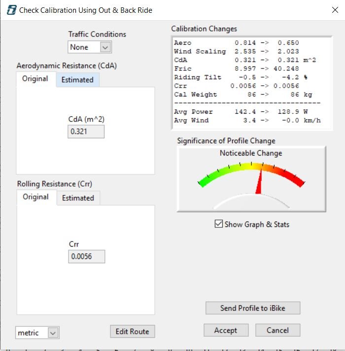

Realized the Fric will be changed drastically and tilt also change quite a bit. Is that normal? Please see pic attached. thanks.
Re: Greetings from Singapore
Yes it is OK
