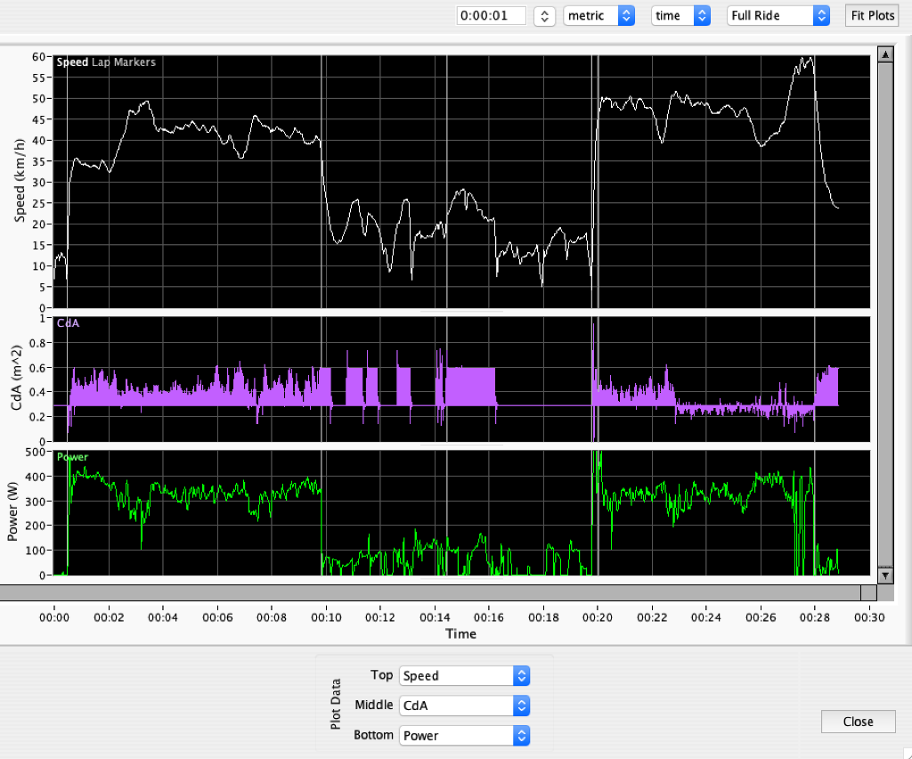

Normally when I do the analysis I see the CdA vary:
The attachment 3 is no longer available
When on the last ride it is just constant (this what i'd like to re-calculate):
Screen Shot 2019-03-30 at 7.32.07 AM.png (110.93 KiB) Viewed 7895 times

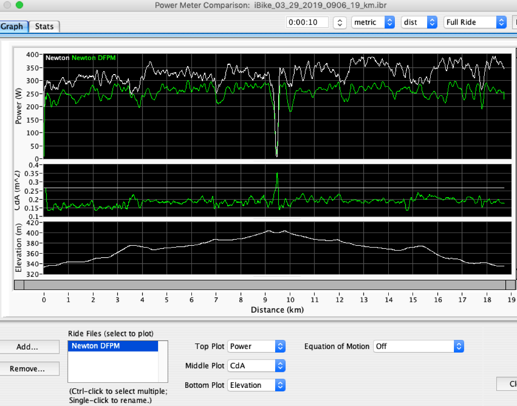

On the Power Meter comparison I see this:
Screen Shot 2019-03-30 at 7.34.17 AM.png (111.36 KiB) Viewed 7895 times

We'll have to see if one of the Velocomp folks has any better insight, but just so we are comparing apples to apples what happens if you use the same data for both the power meter comparison and CdA analysis charts? The screen shots you posted for the ride on 3-29-19 show different sections of the activity and also have different data smoothing settings. So, what do you see if you do the CdA analysis for the entire activity with the data smoothing set to 0:00:10 to match the Power Meter Comparison chart?

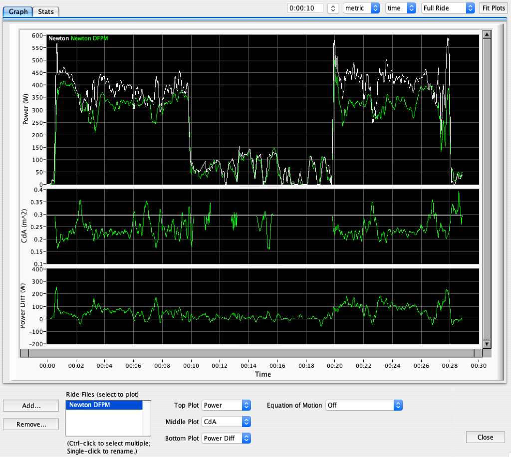

I'm trying to make sense of the CdA measurements, is the Calbulated or DFPM power taken for calculations?
It's been windy today. On the first image CdA looks strange, nothing really changed on the second run, but the CdA is dropped to what I would expect to be normal range:

Actually, I think things are fine (though there may be a bug in Isaac).
1. It looks like you're not on profile 4; I say this because it looks like your HR data is being shown, not your CdA data

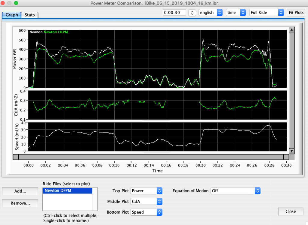

2. There is a separate window called "Tools/Power Meter Comparison" which also calculates CdA. This window shows that your "out" CdA and "back" CdA are about the same.
Power Meter Comparison with CdA = 0.296
Screen Shot 2019-05-15 at 6.25.25 PM.png (136.63 KiB) Viewed 7653 times

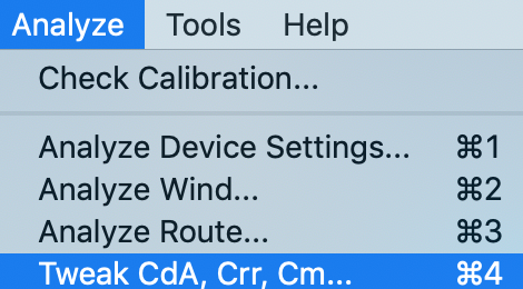

It looked to me that your CdA was about 0.23, and when I used that number in the "Analyze/Tweak CdA..." screen
Analyze CdA command

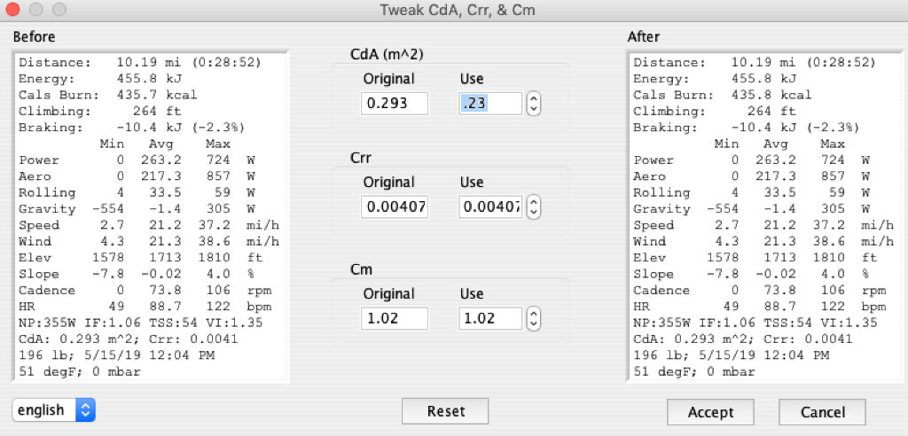

Analyze CdA command
Screen Shot 2019-05-15 at 6.27.33 PM.png (177.19 KiB) Viewed 7653 times
Change CdA to 0.23
Change CdA to 0.23
Screen Shot 2019-05-15 at 6.28.08 PM.png (151.62 KiB) Viewed 7653 times

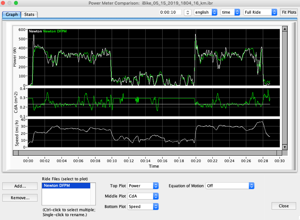

I got great results!
Power Meter Comparison with CdA = 0.23
Screen Shot 2019-05-15 at 6.28.46 PM.png (140.84 KiB) Viewed 7653 times

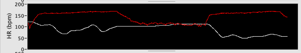

1) I was on the Profile 4, it's the same wonky readings from HR as I had on my Garmin with Connect IQ. (see the comparison with real HR in the attach.

When you merged your TCX data, I suspect you over-rode the HR values. Don't import HR data from your TCX file.
