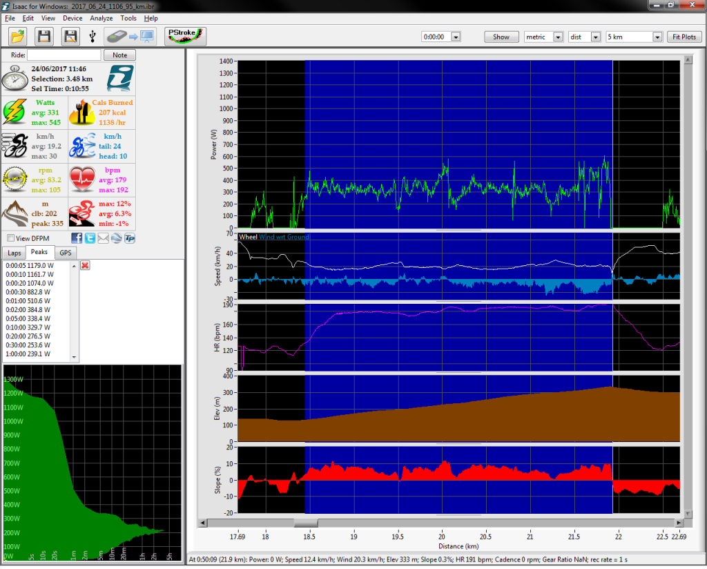

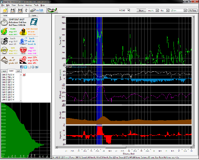

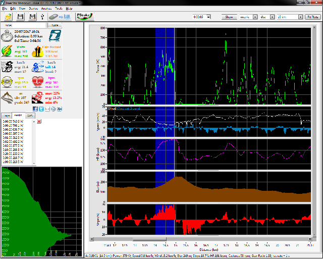

I posted the other day about how I felt the PP was overestimating my power output uphill due to a tail wind. Following positing it seemed that actually the numbers were correct, however I still was a bit surprised I was able to ride at ~450 W for 5-minutes, quite a bit higher than I thought I was capable of.
I looked again at the file and ran the ‘Analyse Route’ option and this had the effect of reducing my 5-minute by 53 W or 12% (from 444 W to 391 W), with the average gradient for that section changing from 10.5% to 9.1% (looking at mapping data the 9.1% figure is much more accurate, 115 m of altitude gain in 1.3 km). Also the 391 W value is much more believable based on other longer efforts of mine and comparing my time with other similar peoples time and their associated power on this hill; to be honest I really do not think I was riding at 450 W.
The ‘check calibration’ option for this ride suggest that the riding tilt should be -0.5%, whereas it was set to -0.4%, this doesn’t seem like much difference, plus I thought the PP was constantly ‘calibrating’ and I had been riding for over 20-minutes before this effort?
Is there a problem with my PP? It seems the PP was initially basing the power calc on a gradient which was too high. To be honest it’s a bit frustrating as I don’t have confidence that the reported numbers are accurate to within +/-10% :(
The relevant file is attached again.
iBike_07_23_2017_1057_23_km.ibr
(243.94 KiB) Downloaded 646 times

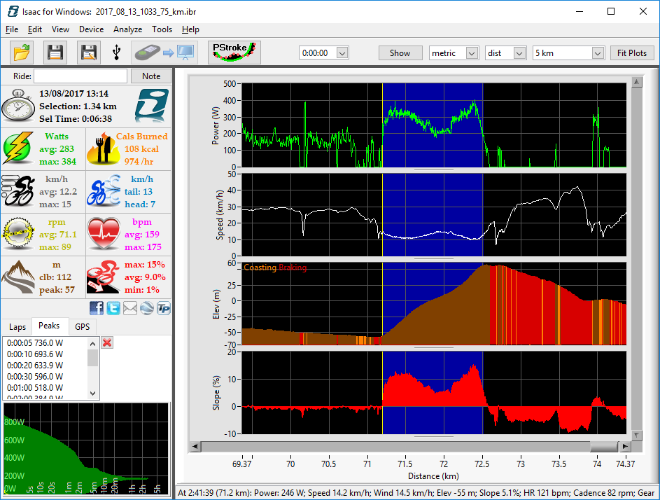

I am just looking back at other ride files and am seeing this issue crop up quite often. basically the PP is significantly out in the gradient used to calculate power.
I have attached another ride file with several hill efforts.
1. Around 15 km for 1 km, the PP average gradient says 13.2% but the actual altitude change is 107 m over 930 m i.e. 11.5%.
2. Around 25 km for 500 m, the PP average gradient says 16% but the actual altitude change is 67 m over 460 m i.e. 14.5%.
3. Around 34 km for 1.3 km, the PP average gradient says 10.9% but the actual altitude change is 127 m over 136 m i.e. 9.3%.
4. Around 37 km for 1.3 km, the PP average gradient says 10.2% but the actual altitude change is 128 m over 136 m i.e. 9.3%.
The ‘check calibration’ option for this ride suggest that the riding tilt should be -0.8%, whereas it was set to -0.4%.
iBike_07_20_2017_0927_64_km.ibr
(558.65 KiB) Downloaded 537 times

John thanks for your detailed response, I think I understand what you are describing, but I have to say that I find that a bit frustrating, if unavoidable and I'm not convinced I am getting solid power measurments; basically the steeper the hill the less accurate the reading. Is there no way to factor in what seems to be an inherent issue with the way the slope is calculated, maybe apply an arbitrary correction that depends on the slope gradient?
I have looked at another ride file which included less steep hills (5 to 6%) and you are right, these do correlate better, but there is still a discrepancy on the average gradient with the slope/accelerometer showing a gradient of around 0.3% to 0.5% greater.
For instance the first main hill @18 km ascends 200 m in 3.48 km with an average gradient 5.7% but the slope/accelerometer average gradient is 6.3%; my power is based on riding up a hill 10% steeper than what it was.
In this case my average reported power was 331 W for ~11 minutes but in reality it was closer to 310 W which is ~6% out, maybe within the acceptable range of accuracy? So for me it seems, at the speeds I ride at, on a ~6% slope the accuracy is within ~6% and for a 11% slope the accuracy is around 14%. I will just have to factor this in when riding I guess.
2017_06_24_1106_95_km.ibr
(763.7 KiB) Downloaded 629 times

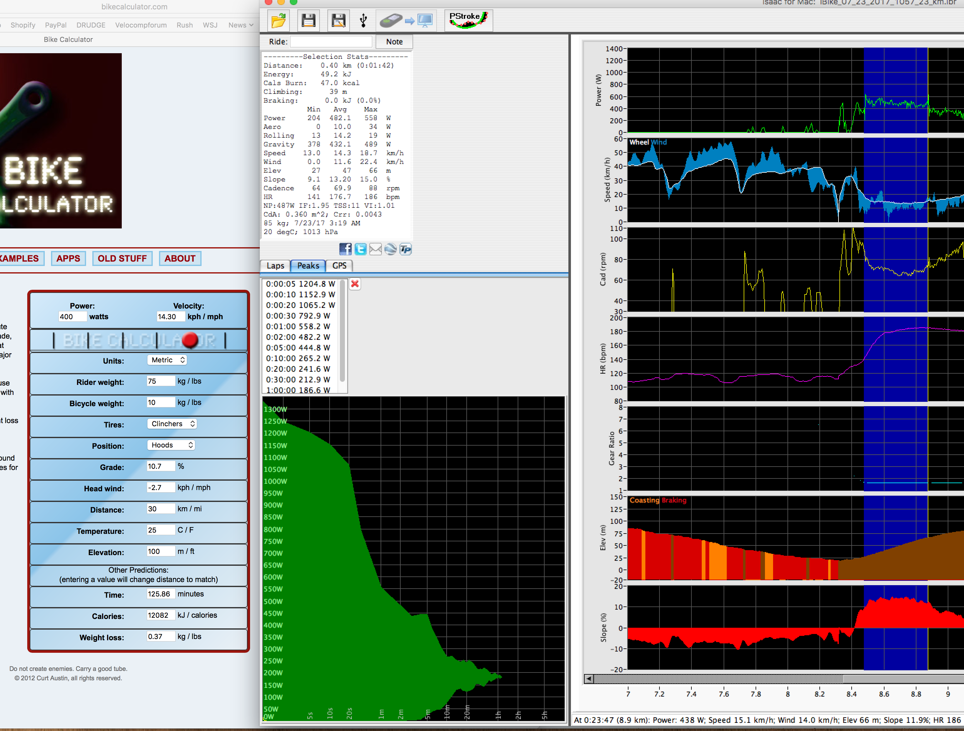

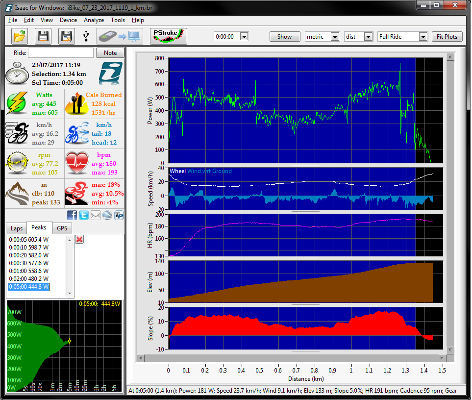

Again thanks for taking the time for a detailed reply I now appreciate that the power value is a function of total acceleration (and speed etc.) only, and not the slope value itself.
However there still seems to be an issue for me here, and that is that the reported power for me uphill appears to be too high, maybe 20% too high.
The first hill I really noticed this on (the one originally mentioned) is basically 5-minutes long and climbs 110 m in 1.34 km with an average gradient of 8.2% (the Isaac/PP average gradient is 10.5%).
For those 5-minutes my average speed was 16.2 km/h, the total weight is 80 kg (me and bike), I have a CdA of ~0.36 m2 and the Coefficient of rolling resistance of my tyres is around 0.004.
Based on the data above and doing a ‘simple calc’ (https://www.gribble.org/cycling/power_v_speed.html) my average power for the 5-minutes should be ~350 W (believable), of which 88% is overcoming gravity, whereas the reported/PP average reported power was 445 W (unbelievable); a significant 95 W/22% difference. However if the average gradient was 10.5% then the average power, based on the simple calc, would be ~435 W (only 10 W/2% off what PP said).
Could the reason for this be due to the fact on steep hills I am out of the saddle and there is more ‘side to side’ bike movement?
Edit: in fact in the image above (and file attached) you can see @1min53s where my power drops instantly by ~100 W, likely where I sat back down on a 'flatter' section, then @3min31s where my power jumps up by ~100W around when I would have got out the saddle again on a steeper section.
iBike_07_23_2017_1119_1_km.ibr
(61.27 KiB) Downloaded 638 times

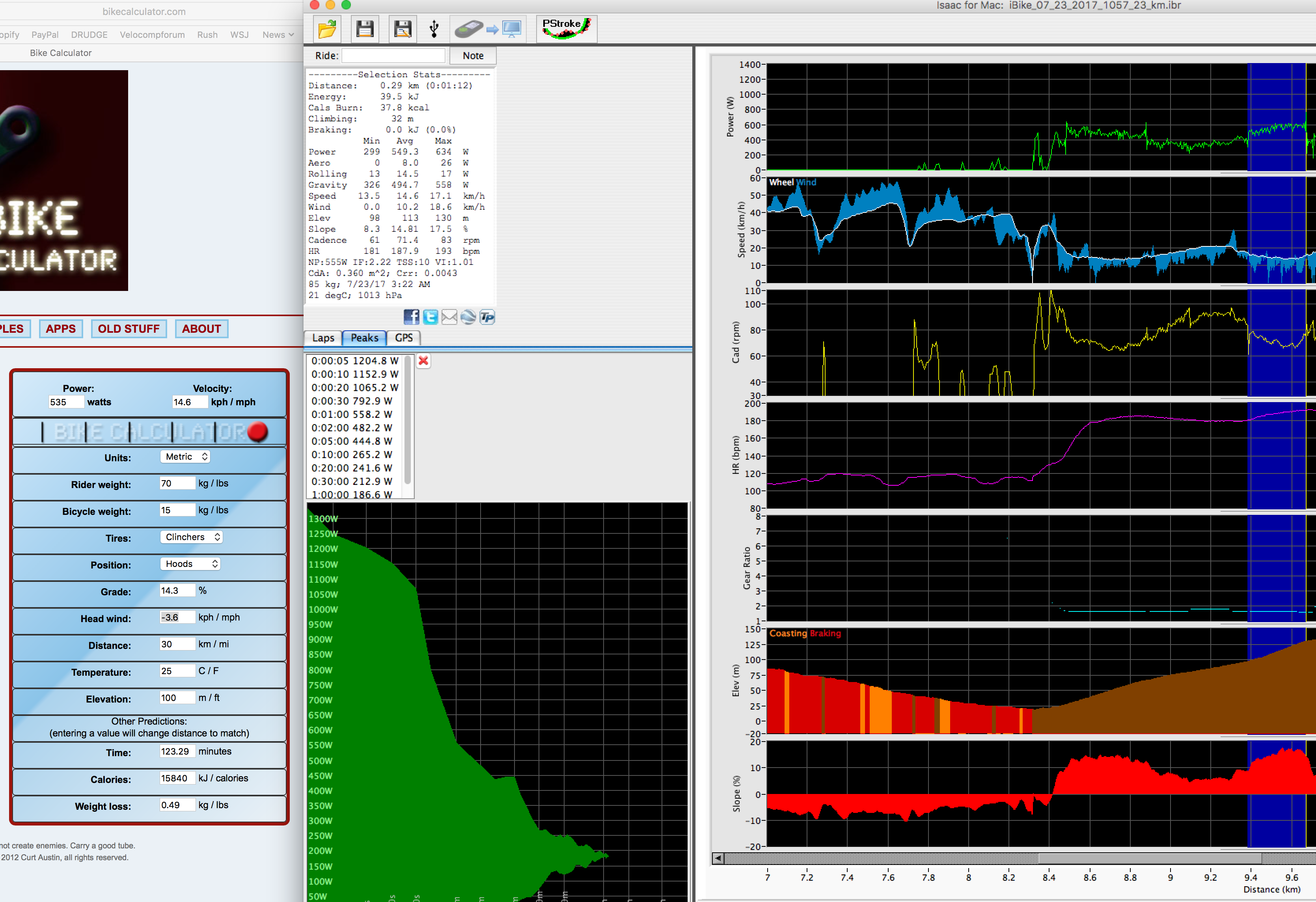

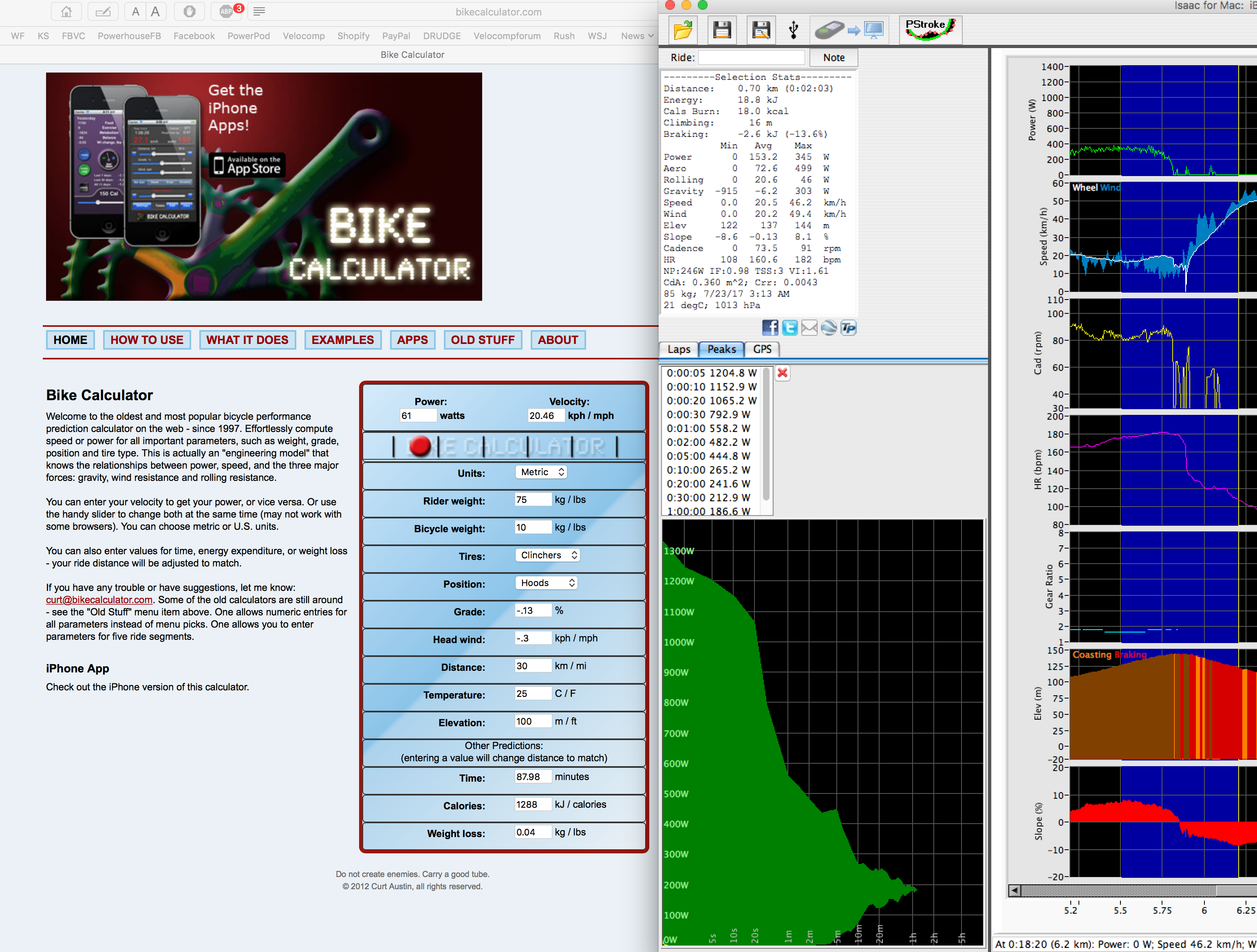

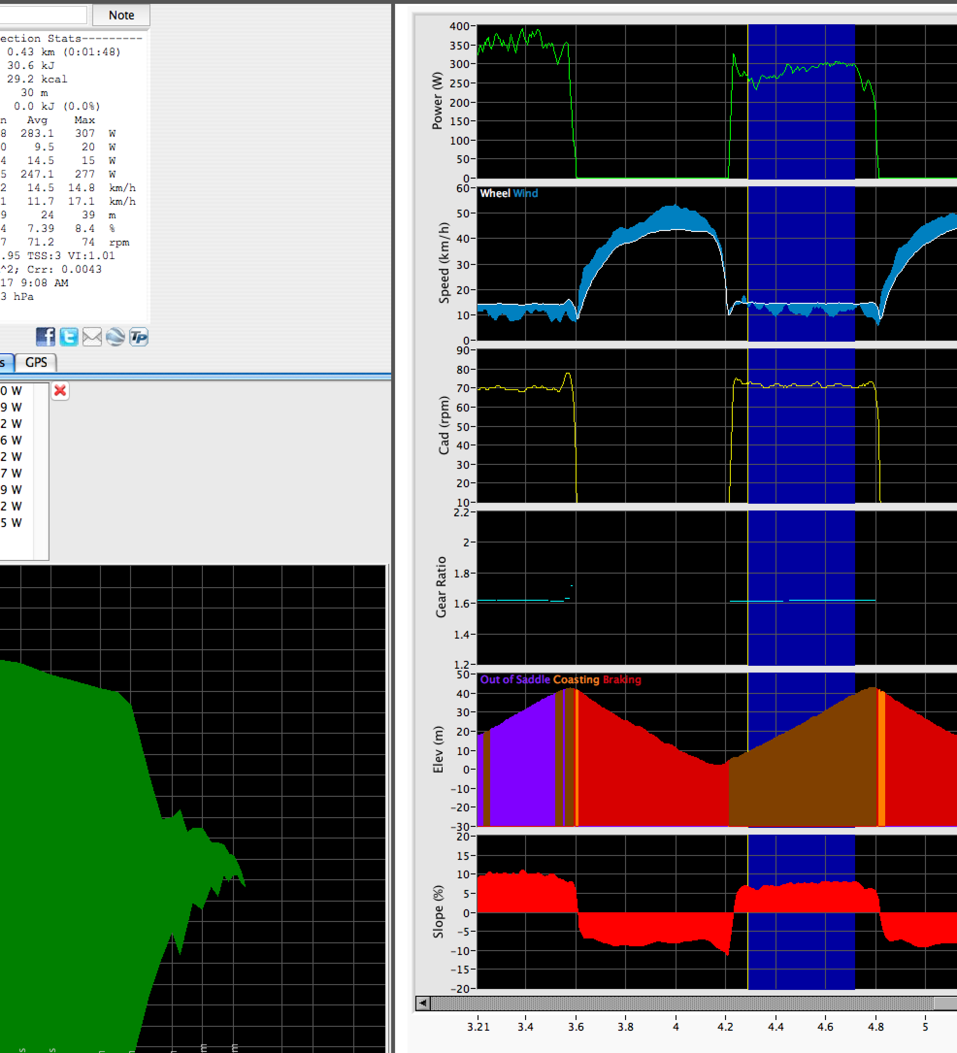

Posts: 8005
Re: Still not confident regarding accuracy

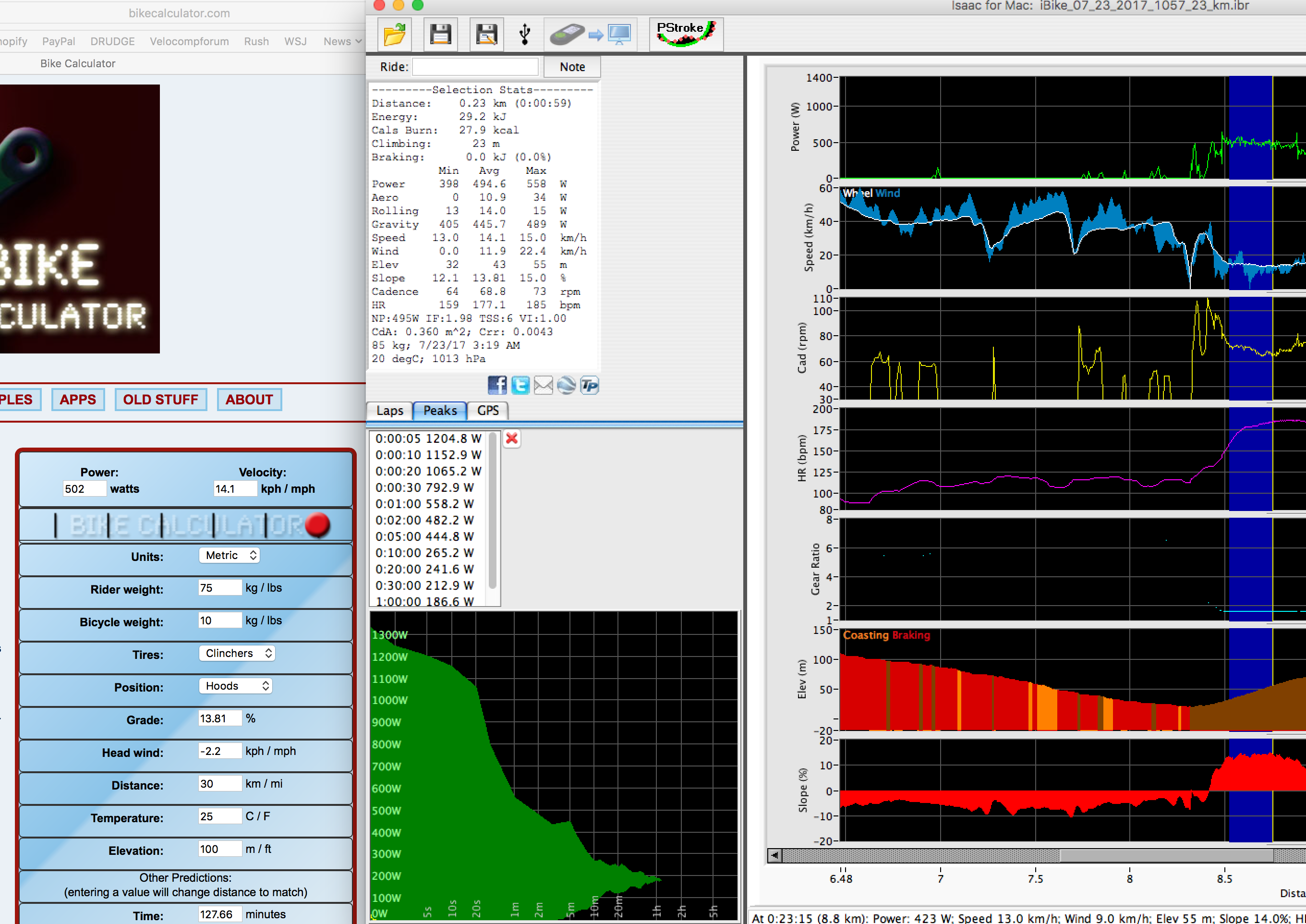

Bike calculator apps like Gribble use inputs such as speed, slope, rider weight, etc. to compute power.
To use these apps properly you have to be very careful to feed them data consistent with their assumptions. The critical assumption in these apps is that the numbers you input are unchanging.
On the interval you showed below, there is a significant decrease, then increase in the slope of the hill during the climb. Similarly, speed drops, then increases, then drops. These changing input parameters are inconsistent with the app's critical assumption, so the app's power analysis won't be correct.
What I did is use your interval, but selected just the portion of it, where slope and speed are relatively unchanging. Basically, this is the first slope "bump" of your interval. Your reported slope is a pretty constant 13.8%, and speed is a pretty constant 14.1KM/h. I also entered the appropriate values of weight and wind speed (note: at these low bike speeds, wind speed is pretty irrelevant).
Your bike speed is low, which as posted above, can create inaccuracies for bike acceleration measurements. However, because the section I selected has almost-constant bike speed, your bike acceleration in this section is nearly zero. This means that the accelerometer's measurement is driven almost completely from hill steepness. So, PowerPod slope measurement can be pretty accurate.
I used my favorite program, bikecalculator.com (it allows for CdA adjustment) but I'm sure gribble would produce similar numbers.
The result? bikecalculator.com: 502W. PowerPod: 495W
I am very confident that, if you had a DFPM on your bike, you'd get results nearly identical to your PowerPod.
I'm beginning to wonder if the "real" problem here is that you are a much stronger cyclist than you might think! :-)
Screen Shot 2017-08-11 at 6.48.26 AM.png (1.02 MiB) Viewed 23554 times
Posts: 8005

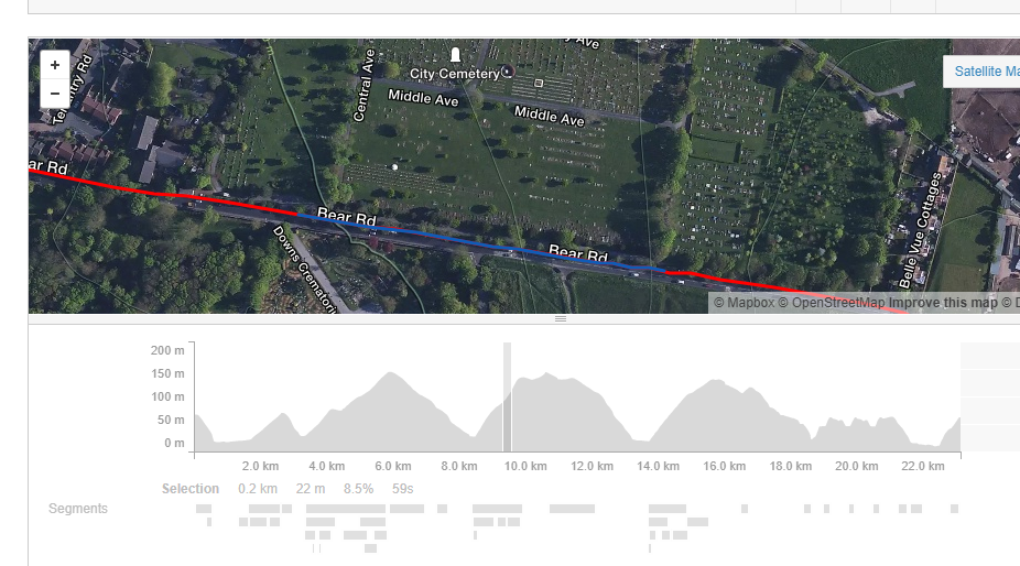

To illustrate the point about apps requiring constant values for the section analyzed, I had a bit of fun.
I selected a place with an uphill, then downhill, for equal distances.
On this section, average slope is about -0.13%, and average bike speed is 20.5 km/h There is a slight tailwind of -0.3 km/h
PP reports 153W for the section, but bikecalculator reports only 61W. Why the huge difference?
The app assumes that speed, slope and wind are unchanging. It gives the "right" answer for these assumptions.
The app has no clue that there is a big climb, followed by a big descent. It has no idea that bike speed is much greater on the downhill. And it does not know there is not any pedaling on the downhill section.
So, the app is wrong...not because it can't do math properly, but because the data was fed with data inconsistent with its assumptions.
Screen Shot 2017-08-11 at 8.00.49 AM.png (1.97 MiB) Viewed 23547 times

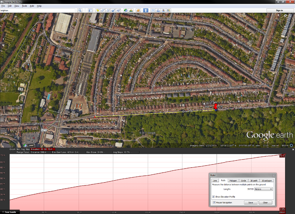

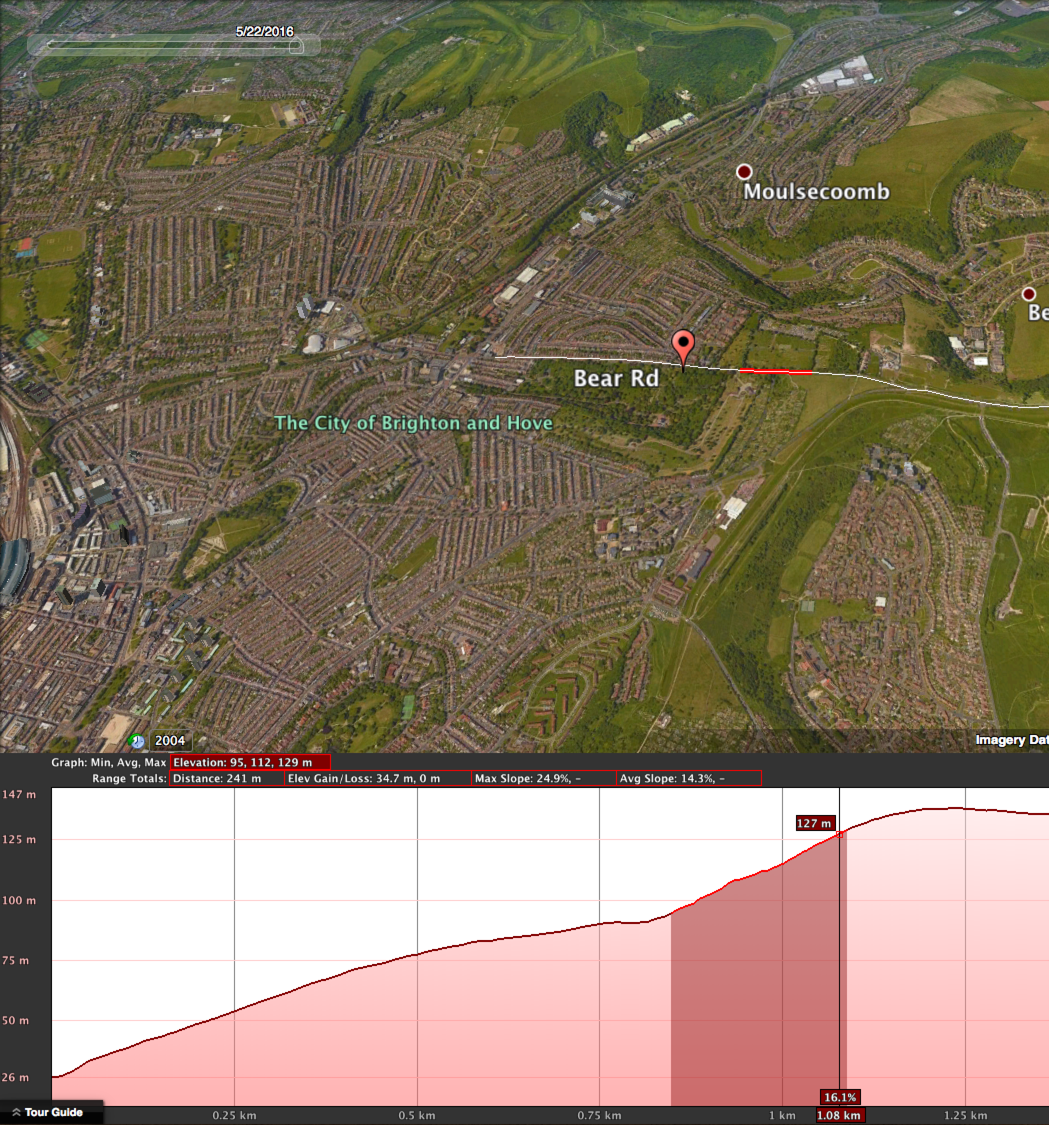

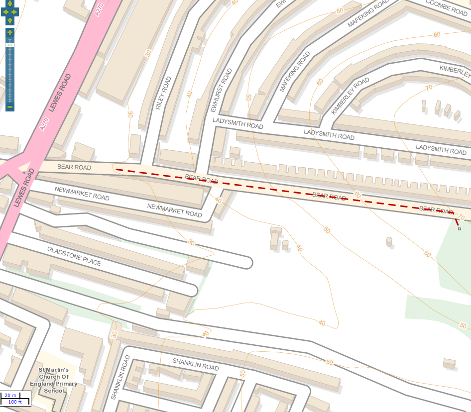

Hmm, I am still not convinced! You are using the reported slope of 13.8% to calculate my power for that section, if that is the actual gradient then my power would rightly be ~500 W.
However over that distance of ~400 m I have only ascended ~40 m, going from 30 m to 70 m above sea level, see the image below, so the average gradient is actually much nearer to 10%, and my power ~370 W.
The 40 m in 400 m corresponds with the Isaac elevation and distance numbers, and also Ordnance Survey mapping data, and also looking at my Garmin ride fie also that elevation data, I am pretty confident that this is correct?
I appreciate that simple power calcs have limited use, but for one short hill effort only with no downhill gradient, they should be
In case you want to look yourself at this hill its 'Bear Road', in Brighton UK.

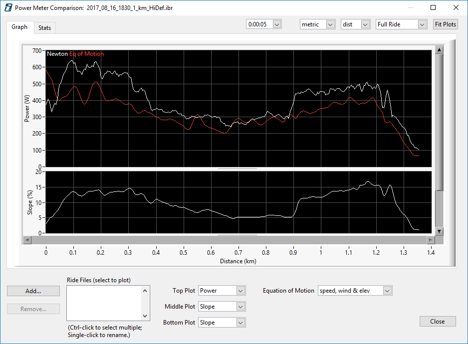

I was out today riding and I was thinking about this problem. I work with accelerometers to measure ground vibration, so have a basic understanding of them. We use triaxial accelerometers with a manufactures sensitivity of 1,000 mV/g, however we do get these calibrated regularly to ensure we get accurate data and I know that the sensitivity is never 1,000 mV/g, on the one I normally use (Dytran 3233A) the three axis are all slightly more sensitive, maybe around 5% to 10%, i.e. a sensitivity of 1,050 mV/g (in fact the manufactures stated sensitivity for this model is +/-10%).
Could it be the case that the accelerometer in my PP is more sensitive than it 'should' be and therefore there is more voltage than there 'should' be and the PP thinks there is more power being generated than there is?
Incidentally I appear to have the same issues on today's ride, that is the reported power appears to correlate well with the reported slope value, not the actual gradient and my power uphill is not correct and the steeper the hill the more off it is.
ronpei
Posts: 120
Joined: Sat Jun 08, 2013 7:47 am
Post by ronpei »
it is more than likely a mass market accelerometer like the ones in phones and PP would not be 100% true.. however the one thing that people get head over heals about is accuracy... it is very difficult to prove that any power meter is accurate since power is a derived measure and not a direct measurement. So unlike a weigh scale where you can take a calibrated mass place it on the scale and directly calibrate the scale, that is a direct measure, however since all power meters must take several measures to mathematically calculate power if any of these measures are in accurate then the result is inaccurate. So called direct force power meters still have to measure speed and distance as well as angular force (another multi factor measure) to calculate power. If any of these drift for any reason then so does the result. The more important issue is precision, or how well it measures the same thing day after day, and for anyone who is training with power that is far more important. This is the only way you can determine if your training is benefiting you. If the precision is poor then there is a possibility that your decision regarding training could be flawed. So whether the accuracy going up hill is true is nearly impossible to determine, all one can say is that if 2 meters on the same bike during the same ride are relatively the same then they compare well, it is impossible for normal people to determine if they are accurate. Even calibrating a DFPM is only a close approximation and is very dependent on what you use to calibrate and how accurate that is. So it becomes a circular argument. Your comparison of an online power "estimating" tool is the same as counting cricket chirps to tell temperature, it might work but all assumptions must be met. So the bottom line is that all power meters are challenged to be accurate, and the precision is a cost factor, to get better sensors cost money so if you want more precision your gotta pay for it. I think the PP is a good device and the cost/ benefit is 100% in line. I know there are a number of assumptions that may not be met 100% on every ride but at the end of the day it works and seems to provide the measure at a fair price to performance ratio. So it may be true that your PP is not 100% accurate going up hill, but the real question should be is it precise?!
pb21

Sorry for the delay in responding; I have been traveling.
Yesterday afternoon I spent a fair amount of time investigating this situation. Thanks to Google Earth I've become a bit of an expert about the elevation profile of Bear Rd... :-)
I also found, separately, a topographic map of the area!
And I looked at the ride file, in detail.
After looking at all this information, it appears to me that, for the 400 meter section of ride pb21 has posted (first part of Bear Rd climb), the PP accelerometer slope reading is higher by 2.5% compared to the GE slope of 10.7%. The PP measured 480W for this section; bikecalculator.com calculates 400W, a 20% difference.
first section of Bear Rd climb
Screen Shot 2017-08-12 at 2.36.07 PM.png (1.28 MiB) Viewed 23457 times
I note, however, that in the second part of the hill climb, which according to GE is even steeper (14.3% on GE), PP reads 14.8% for the same section--very close, with watts within 2.6% of each other (549 vs 535).
GE elevation profile of second section of Bear Rd climb
Screen Shot 2017-08-12 at 2.20.11 PM.png (2.65 MiB) Viewed 23457 times
power for second climb
Screen Shot 2017-08-12 at 3.02.59 PM.png (1.19 MiB) Viewed 23457 times

I think the Google Earth numbers are wrong for that section. Based on Ordnance Survey elevation data for that section noted above the elevation gain is ~23 m (from 96 m to 119 m), this also corresponds with the PP barometer, my Garmin barometer and my perception riding it! This section is ~200 m so the average gradient is ~11% not the 14.8% reported by PP (or the 14.3% based on GE numbers). On the basis of OS survey data, and the PP and Garmin barometers I am very confident that the gradient is ~11 % and my power should be much closer to 390 W and not 550 W.
I will head out later and ride the hill twice, once sitting the whole way, once standing the whole way. I will also try and maintain the same speed for both efforts...

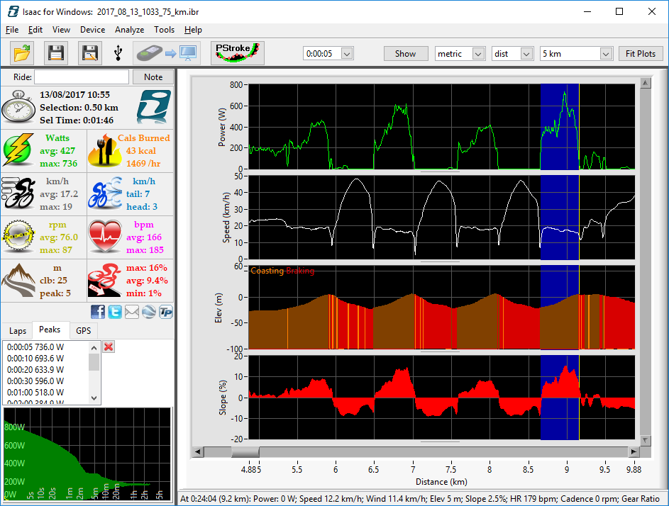

So I have just been out and I did a couple of 'tests' and to be honest the results aren't very encouraging. The first was a short 500 m hill with an average gradient of 5.2%. I rode it four times, seated, standing, seated and standing, each time I tried to ride it at a similar speed, this occurred at 5.5 to 9 km in the ride. PP/Issac results below:
Seated 1:
Speed: 18.4 km/h
Reported Slope: 5.9%
Reported Power: 305 W
Expected Power: 290 W
Standing 1:
Speed: 16.1 km/h
Reported Slope: 8.5%
Reported Power: 362 W
Expected Power: 249 W
Seated 2:
Speed: 18.4 km/h
Reported Slope: 4.9%
Reported Power: 260 W
Expected Power: 263 W
Standing 1:
Speed: 17.2 km/h
Reported Slope: 9.4%
Reported Power: 427 W
Expected Power: 256 W
I should note that I tried to do the seated efforts very smooth and the standing efforts more exaggerated than normal, particularly the second standing effort. Nevertheless it seems fairly clear that riding out of the saddle increases the acceleration the PP measures and therefore power is massively exaggerated.
At the end of the ride I rode the original Bear Road hill seated the whole way. The actual gradient of this hill is ~8.2% for 1.34 km. Originally I rode this standing and seated and this had a reported slope of 10.5%. Today I rode it seated and it had a reported slope of 9%. Its worth noting that whilst I was seated this is a tough hill and I was holding the bars tight and there would have been some movement of the bars.
So there is at least one issue and that any acceleration of the PP is assumed to also be movement of the bike and person riding the bike, in addition this is likey compounded by an inherent variation in accelerometer sensitivity not taken into account.
You will also see that on the long hill the reported power from today is much 'smoother' with less of the jumps in power where I either sat down or got out out of the saddle on the original ride.
2017_08_13_1033_75_km.ibr
(575.01 KiB) Downloaded 496 times

I've just been out for a quick test ride which involved riding up a nearby hill (elevation gain of 39 m over 600 m, 6.5%) 5 times. The hill has a fairly constant gradient and I tried to ride it at the same speed (14.5 km/h) the entire way up for each effort.
1. Seated (14.6 km/h 258 W based on gradient vs 285 W based on PP - 10% difference)
2. Standing (14.2 km/h 250 W vs 337 W - 35% difference)
3. Seated (14.5 km/h 256 W vs 278 W - 8% difference)
4. Standing (14.0 km/h 246 W vs 324 W - 31% difference)
5. Seated trying to be very smooth (this was ridden slower in a lower gear, 13.2 km/h 231 W vs 240 W - 4% difference)
For both the seated and standing efforts the reported gradient, 7% and 9% respectively, is higher than the actual gradient, also the reported average power is also higher for the standing efforts by ~50 W despite been ridden at the same speed. I'll let you look at the data yourself though!
Looking at the PS data none of the efforts look particularly 'good', but I suspect the standing efforts are off the scale?! I'm also not fully clued up on this.
Is this movement of the bike the cause of higher power values than otherwise anticipated, looks like it is, but am I really 'wasting' 50 W when standing out of the saddle on this hill?
I need to do some more efforts, particularly of Bear Hill...
2017_08_13_1655_8_km_HiDef.ibr
(228.34 KiB) Downloaded 592 times

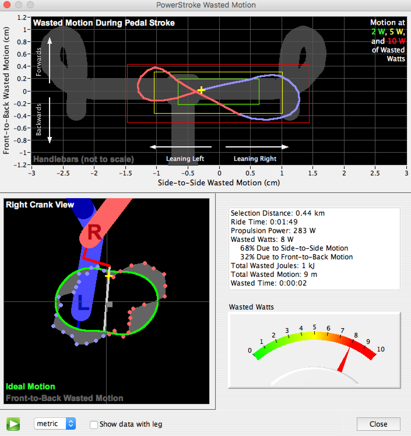

1) In the saddle, your PowerStroke looks good: 3 cm side to side, 1 cm front-to-back, 8 wasted watts
In-the-saddle PowerStroke
Screen Shot 2017-08-13 at 2.51.25 PM.png (209.4 KiB) Viewed 23381 times

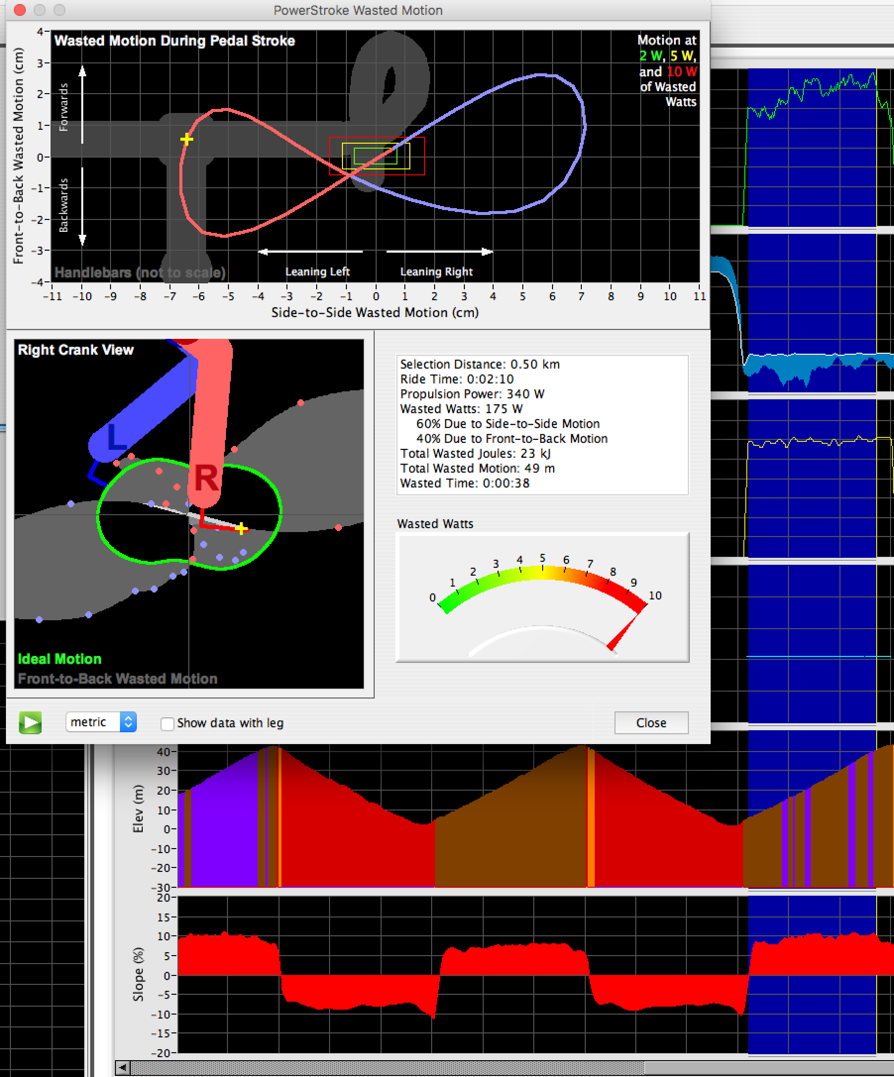

2) When out of the saddle you have a huge 14 cm side-to-side sway and 6 cm front-to-back sway; honestly, the largest sway I've ever seen in a ride file, by at least a factor of 3.
Hill 3
Hill 3
Screen Shot 2017-08-13 at 2.24.53 PM.png (362.01 KiB) Viewed 23381 times
The impact of such a large sway on accelerometer readings is something we have not previously studied, but obviously it is having a material effect. Such a large sway may also be having an adverse effect on your riding efficiency. PowerStroke is estimating 175W of wasted watts (I don't think it is really that much, but it is definitely something to look at)
3) When using PP for slope measurement comparisons, it is extremely important to pick locations where the slope is not changing, and where bike speed is constant. You have some good data available that satisfies both conditions. You can see a clear break (reduction) in watts near the top of the hill. This is where slope goes down slightly. However, for the prior 430 meters, slope is nearly constant, and you've done a great job of holding constant bike speed (no bike acceleration effect). So, this section of the hill is perfect for slope measurement comparisons. (The data in hill 1 is OK, but nearly perfect for hills 3 and 5). Of course, the out-of saddle data on hills 2 and 4 is not used... :-)
Out-of-saddle PowerStroke
Screen Shot 2017-08-13 at 2.09.13 PM.png (320.91 KiB) Viewed 23381 times
For your three, In-the-saddle efforts (hills 1,3 and 5), PP measures:
Hill 1: 30 m climb, a 7.57% slope (note there is some bumpiness in watts near the top of the climb).
Hill 3: 30 m climbed, over a distance of 430 m, or a 7.39%. Very smooth watts
Hill 5: 30 m climb, 7.38% slope. Very smooth watts
Hill 1 has some variation in watts near the end, but hill 3 and 5 are very, very smooth. So, for PP, I've used 30 m rise (from baro sensor), 430 m length (from speed sensor), and 7.385% slope (from accelerometer, hills 3 and 5)
Using the baro sensor and speed sensor data, you climbed 30 m over 430 m, which yields a slope of 7.0%, somewhat lower than the 7.385% slope measured by the accelerometer.
But here's the thing: if the distance climbed were measured to be 31.7 m, instead of 30 m, PP and baro slopes would be identical.
For baro elevation readings to be precise, the pressure inside PP case needs to be identical to the outside pressure. Under conditions of rapidly changing pressure (which happens on any steep climb), it takes about 5 seconds for internal and external pressures to equalize; consequently, the baro sensor elevation will lag behind actual elevation changes.
You climb 30 m in about 107 seconds. Each 5 seconds you climb about 1.4 meters. So, what may be happening here is that the baro elevation/slope readings are not updating fast enough to keep up with the accelerometer slope readings.
I think we agree that your out-of-saddle riding is causing high accelerometer readings. And my view is that the in-saddle accelerometer, slope and power readings are correct.

This evening I got out on a ride which included the Bear Road hill. I was a bit slower this time, but the result is essentially the same as previously. I have attached two ibr files, one for the whole ride and one for the Bear Road section only (which occurs at 24 km in the ride).
Interestingly I was looking around the software and found the 'Tools>Power Meter Comparison' feature and that within this you can select an equation of motion to compare it to. Selecting 'speed, wind & elev' option gives the following chart (it seems the elevation used to calculate power is based on the barometer data rather than the calculated slope). Usefully this shows the overestimation at the beginning when I am out of the saddle, the middle flatter section where the two are much more closely aligned when I am riding in the saddle before the final steeper section where they diverge again.
I also looked at this for the whole ride and generally the two align quite nicely, although the equation of motion tends to be always be a bit lower, particularly on hills of all gradients and whether I rode them sitting or standing, although the difference is always higher when standing.
2017_08_16_1830_1_km_HiDef.ibr
(322.97 KiB) Downloaded 564 times
2017_08_16_1738_36_km_HiDef.ibr
(777.67 KiB) Downloaded 486 times
