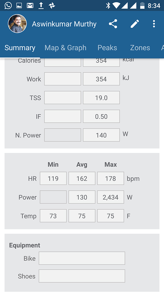

2. There was a peak in power which showed 2434 W and then it settled down to 100-200 ish watts. I dont know where it came from and i dont know if the other watts were correct
3. Despite me doing a 31.3kmph average over 25kms and and with a average HR of 162 my TSS in Training peaks was only 19 :( and my IF was 50 :(
TSS / IF/ NP / Calories burnt were all wrong

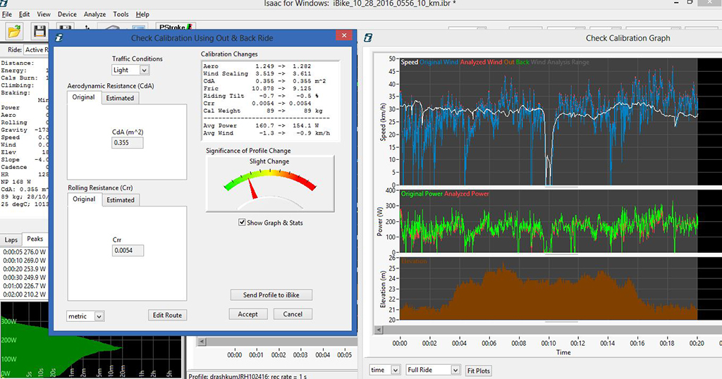

1) I used the "File/Combine-Split File at Cursor" command to get rid of the first 5 minutes, where PP was calibrating itself.
2) I used the "Analyze/Check Calibration" command to correct your wind settings. The constant tail wind was caused by an incorrect setting. The tweaked profile is located in the Edit/Edit Profiles menu
3) I changed the CdA of your profile from 0.359 (road bike) to 0.27 (TT bike)
4) I used the command "Tools/Switch Profiles after the ride" to see how your ride looks with all the correct parameters.
5) Modified profile and ride file are attached. Load the profile into your PP and you should be ready to go (the next ride may take 8 minutes for PP to readjust itself).

Velocomp wrote:No worries:

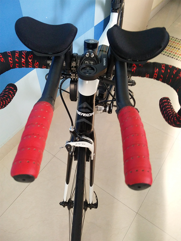

1. You have edited CdA to 0.27 even though I havent used the TT bar for the ride and i have rode only on hoods, May i know why is it so?

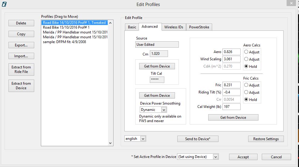

I saw you commenting that wind scaling for handlebar mounted PP is 1.4 whereas in the profile you have sent me "14/10/16 tweaked" the wind scaling is 3.061. may i know why? just that i want to understand the whole thing thats why asking you.
3. I have to import this drashkum.ibp through edit profile and then send it using send to device tab on the same page? should i do this after doing a factory reset?

Your PP is mounted on a pretty crowded cockpit, so I think it is getting a bit less wind than usual. This is nothing to be worried about.
I thought you were riding with your TT bike setup; if not, use the attached profile, which now has a CdA of 0.359
Yes, you import the profile, then click the Send to Device button on the Edit Profiles page. Your PP will be updated with the correct profile. There is no need to do a factory reset before or after the profile change.

The bike was loaded with TT set up Aerobars but just that i didnt choose to use it. Thanks for the update
Ill do a Ride today and get back with the newer ride file. After everything falls in place my coach has instructed me to do a FTP and Vo2 max test, so im just waiting for it
Yes it is a crowded cockpit. Will it serve the PP good if i remove the aerobars for now?. Anyhow i dont have a TT scheduled in next couple a months. Just the training for next 2 months

For now, I would keep the TT bars on. Do a few rides so you get used to things. Afterwards you can try removing the bars, though this may require a recalibration.

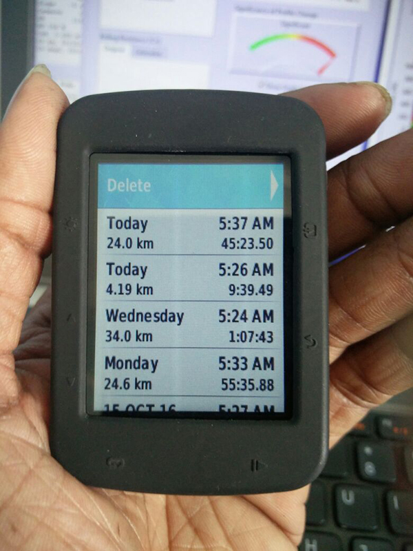

Things didnt go smooth today.
I started the ride today for FTP assesment and for close to 20 mins i didnt not get power values from PP to garmin. Even before start of ride I spun the wheel and cranked manually to see the symbols of cadence, speed n HRM on Garmin an then connected PP to Garmin. PP also showed stable green light. No power values came though. And green light too went off and there was no light on pp. on pressing PP button each time it was stable green light. I thought something was wrong and had to stop my ride 2 times and i tried to re pair my sensors and garmin again and still in the final ride for 10 mins i didnt get power values and all of a sudden the power values show up on the garmin and from there it was showing for full ride....Any idea on this weird behaviour?
I am enclosing 3 ride files here first 2 are ones where power values dont show up at all where i had to stop and repair the garmin and 3 one is 34km ride where after 10mins powervalues show up in issac. Still the wind info says i predominantly rode in tailwind which is not the case. It was a solo ride to estimate FTP and i rode only on hoods of my bike
Kindly Please help me
iBike_10_19_2016_0506_0_km.ibr
(13.58 KiB) Downloaded 431 times
This one is from where i started and then stopped to check why power was not shown
iBike_08_18_2016_0000_0_km.ibr
(16.44 KiB) Downloaded 401 times
This one again the power did not show up despite reset by holding 10sec the button
iBike_08_18_2016_0001_34_km.ibr
(196.34 KiB) Downloaded 454 times
Third one i again reset and paired the sensors again but still power didnt show up on garmin and down the line after i rode for 10 mins the power abruptly shows up. I don't think it was recalibration get as last time it showed me power on recalberation. This time it was no power
I did a fast ride to estimate my FTP for 20 mins after the power showed up and i dint know how accurate it is after all this fiasco
Can someone help me on this weird behaviour

Patience is what is needed here. Your PP recalibrates itself during the first 8 minutes of each ride.
Your "0km" ride files show zero power for the first 8 minutes of the ride.
Your "34km" ride shows proper power after the calibration period. HOWEVER, your unit is struggling "hard" with its internal slope correction algorithms. This needs to be corrected by resetting your device and doing a new master calibration.

1) Attach PP to your mount, following the instructions that requestyou gently rotate it forward so that it is locked into position. Tighten the screw so PP cannot rotate.
2) Loosen the mount screws, and rotate your mount so that the word "PowerPod" is reasonably level (+/- 10 degrees) to the ground beneath it. Eyeball estimates are fine. Tighten the mount screws, and confirm that the mount and PP cannot rotate.

1. I mounted the tripod on the mount and fixed it by rotating it forward to maximum and tightening the screw
2. I loosened the mount screws and fixed the powerpod in such a way that word powerpod on the device is parallel to the ground

Ride information I did 2 rides
First one 4.19 Kms for calibration and it was out and back ride to same spot. Solo ride, No drafting. But calibration finished just after i "U" turned to return back to the starting point
Do i have to make a strict OUT and BACK calibration ride in such a way that it finishes at 100 at the start point when i return back?...Please let me know if i have to do that
The second ride was for 24kms, Solo ride, no Drafting Predominantly in Zone 3 and 4 of my Heart Rate which was also a Out and Back ride to same spot.Rode predominantly on hoods very marginally on return on drops due to head winds.
The powerpod unfortunately recorded both rides as one file despite me saving 2 separate rides in garmin and clicking on powerpod button( probably i did not press it enough)
So the ride file shows 29kms ride. Here is the file below for your use

You need to load a corrected profile into your unit, attached. Do another ride and then post. All should be well.
By the way: as you discovered, PP records one long ride file, even when you have two files in your Garmin. Making multiple files in the Garmin does not change PP file structure.
drashkum102316.ibp
(525 Bytes) Downloaded 372 times

Re: Newbie to Power Can someone help me set up PP correctly
I used the "Analyze/Check Calibration" command to correct your wind scaling factor.
PP records one long ride, unless it is asleep for 20 minutes, after which it automatically starts a new ride. So, you'll have to split things in Isaac.

I highlighted a symmetric portion of the ride, centered where you turned around, used the "File/Combine-Split/Keep selection only".
I then used "Analyze/Check Calibration" to get a new wind scaling factor.
Your new profile has a bit lower wind factor. In fact, this factor is nearly identical to the one I sent originally.
I think you will be good to go with this factor. The other good news is that your recalibration appears to have fixed the tilt weirdness I saw with your original file.

:) ill tell you what i did first to arrive at my decision and then my decision. i did the same thing what you did. i selected a part of the ride with a symmetrical elevation centered around my u turn point . i selected File -> Combine/split-> Keep selection only-> check calibration. the result was this
The calibration meter is in green. so the profile looks to be ok and so the power readings are accurate enough i think.
Am i correct Mr.Hamann?
