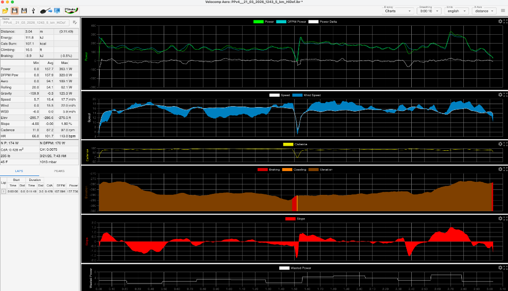

With a new ride i believe i managed to correct the profile,
activity_22247626329.tcx
(503.93 KiB) Downloaded 65 times
PPv4__21_03_2026_1243_5_km_HiDef.ibr
(131.42 KiB) Downloaded 82 times
Re: Calibration issue
albafar wrote: Wed Mar 25, 2026 5:37 am With a new ride i believe i managed to correct the profile,
Looks good!
