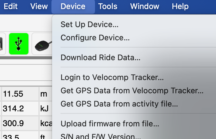

Re: Velocomp Aero software for Mac
narkose wrote: Sun Jul 07, 2024 1:39 am I am now able to connect to the device using Device>Connect>Dropdown to usb port. There is confirmation message saying that the device is connected, but the USB icon does not turn green and the only ride shown is the demo
DO you have any advice or thoughts on how to solve this problem
There is no "Device>Connect>Dropdown" menu item in VA, so I don't know what you are talking about...
Screenshot 2024-07-07.png (179.62 KiB) Viewed 43359 times

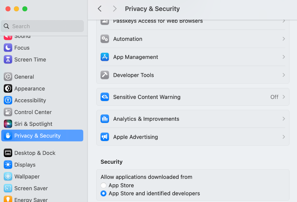

Reload the SiLabs driver, and make sure you check "System Settings/Privacy and Security/Security"...and allow the SiLabs driver to load.
Screenshot 2024-07-07.png (182.65 KiB) Viewed 43359 times
