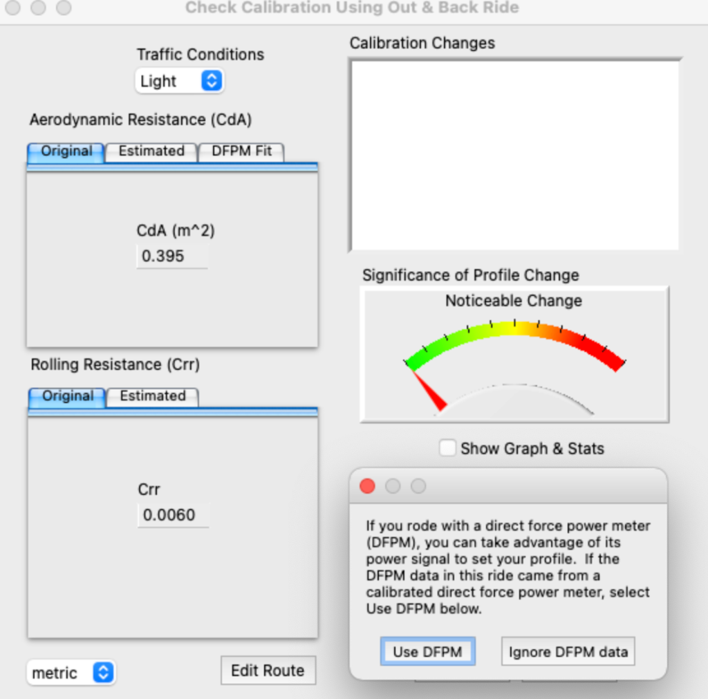

1) Use the command Analyze/Check Calibration
2) Click the box that says "Use DFPM"
Screen Shot 2022-06-04 at 3.27.56 PM.png (279.25 KiB) Viewed 6320 times

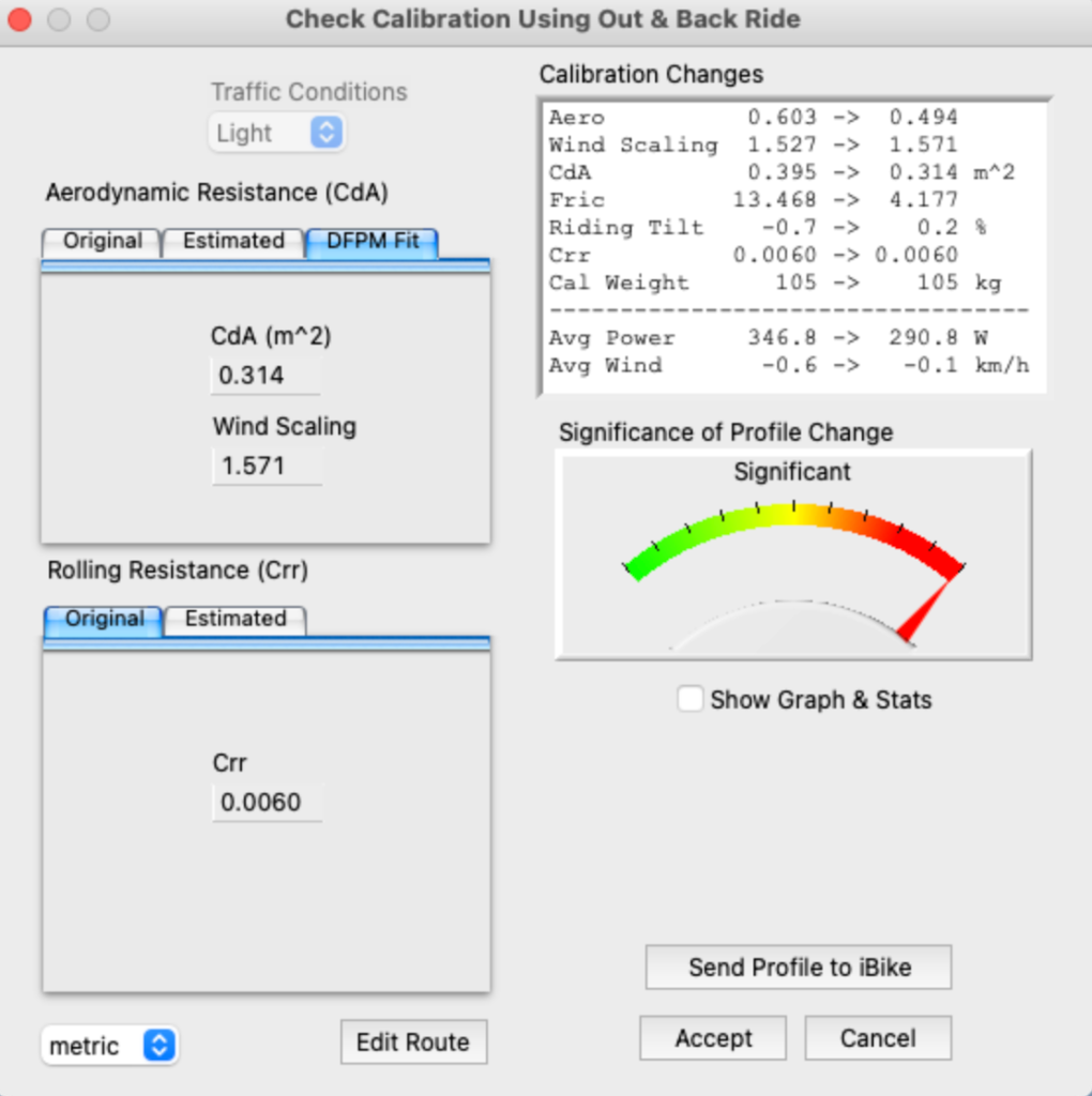

3) You'll get a value of CdA (0.314), with the original Crr value of 0.006 for Crr
Screen Shot 2022-06-04 at 3.39.11 PM.png (226.7 KiB) Viewed 6320 times

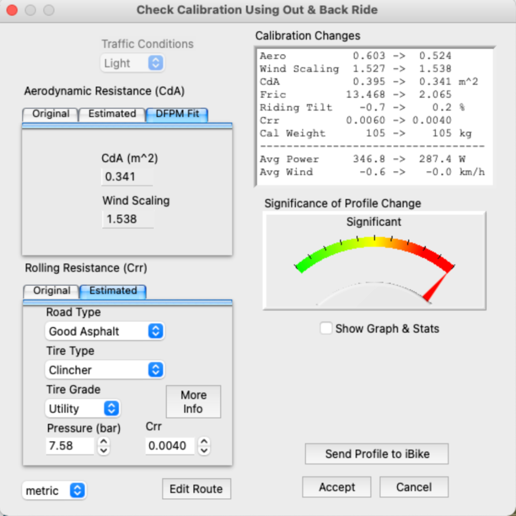

4) Click the Estimated tab in the lower left corner, and manually enter the Crr value 0.004. Then, click anywhere in the window. A new value of CdA will be computed, based on the Crr value of 0.004. In this example, the CdA value is 0.341
Screen Shot 2022-06-04 at 3.30.15 PM.png (270.83 KiB) Viewed 6320 times
So, reducing Crr from 0.006 to 0.004 INCREASES CdA, from 0.314 to 0.341--an increase of 0.027. This is logical; when your Crr goes down, frictional watts go down, and must be compensated for by increased aero watts. Increasing CdA by 0.027 will increase aero watts bye the amount "saved" by lower friction.
5) Your AP CdA, with a 0.006 Crr, is 0.285. With a lower Crr of 0.004, I estimate your AP CdA would be 0.285 + 0.27 = 0.312
Of course, the easy way to do this next time is to adjust your profile so that Crr = 0.004 :-)
