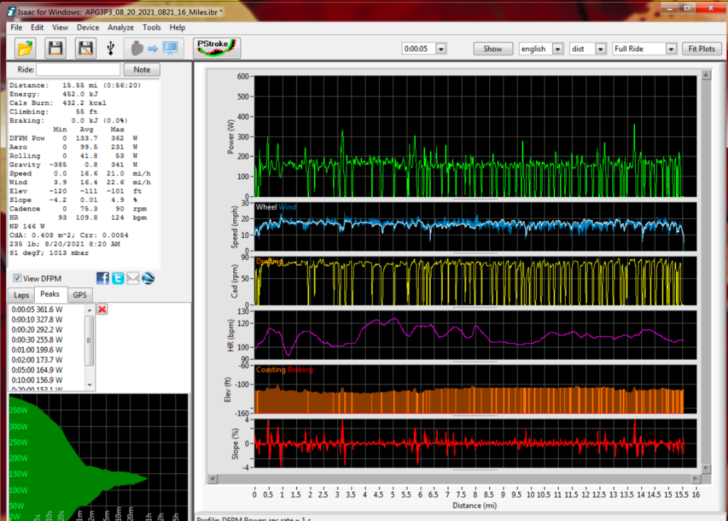

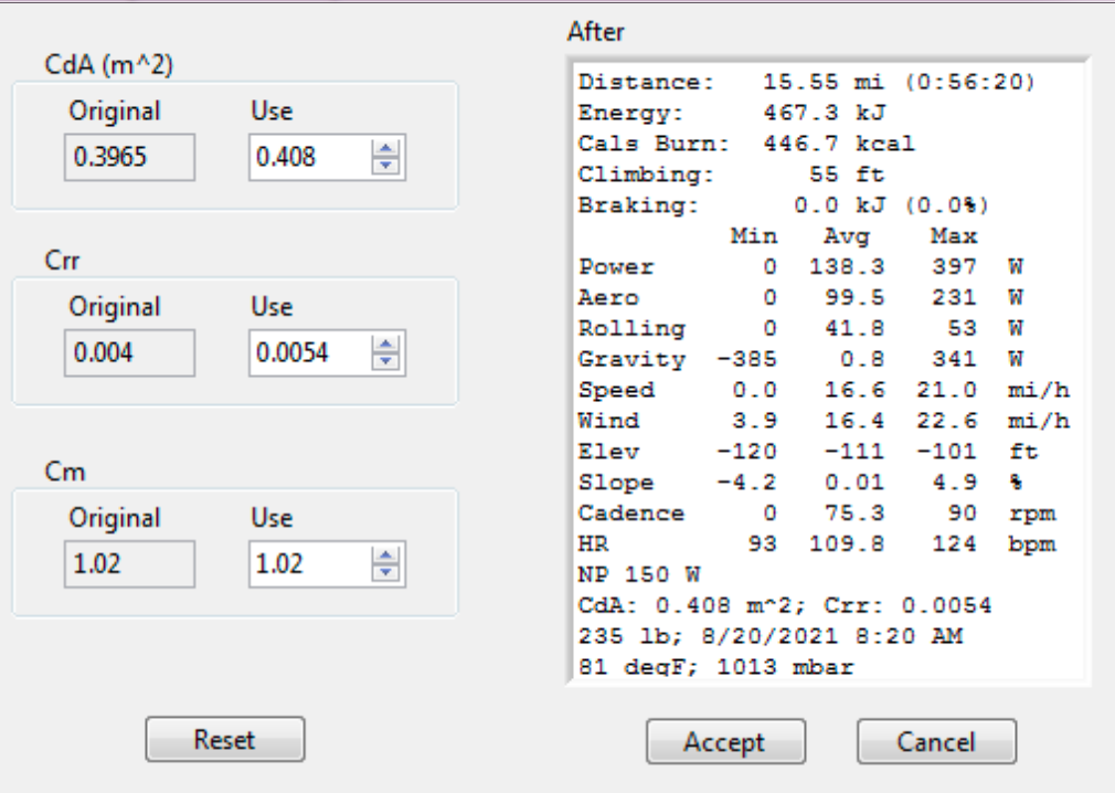

4) On the bike, with the higher tire pressure my on-the-road CdA goes DOWN. Why? My AeroPod is using the "soft" value of 0.0054 for Crr, causing rolling resistance watts to be higher than actual DFPM watts causing total opposing watts measured by AP to be too high. How high? For this ride, my average opposing watts were 138.W (yes, I know this is not world beating--that's another story :D )

and my average DFPM watts were 133.7W

AP therefore adjusts reported on-the-road CdA DOWN to get to the target of 133.7W.

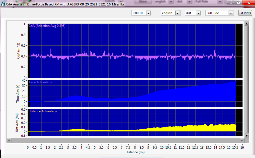

5) Isaac CdA analysis shows the same thing; for the condition of Crr = .0054, Isaac Tools/CdA shows a measured CdA of 0.395.
Screen Shot 2021-08-20 at 12.59.01 PM.png (161.48 KiB) Viewed 9465 times

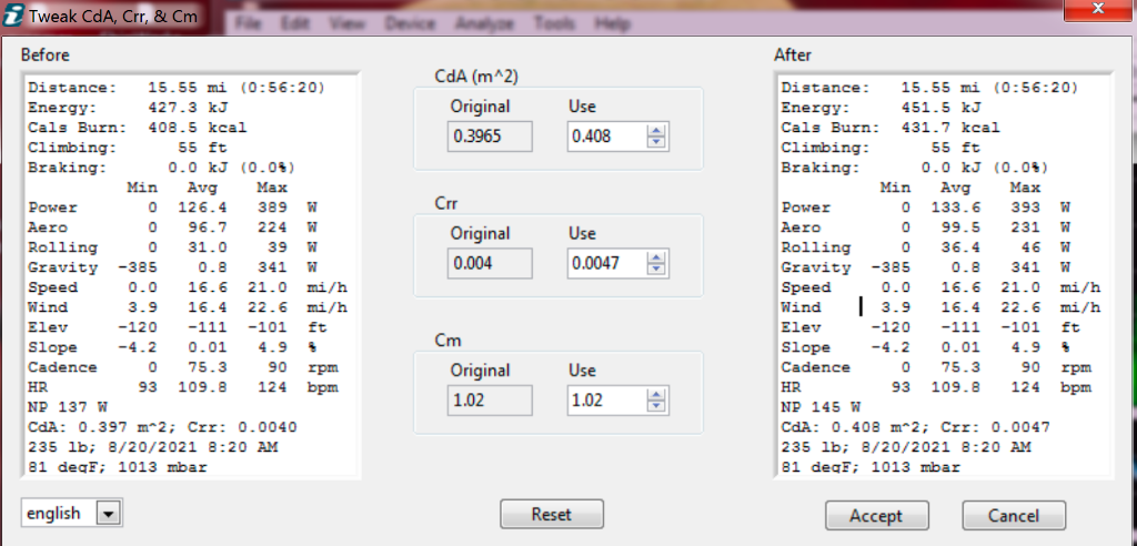

6) I use the command "Analyze/Tweak CdA, Crr..."
Screen Shot 2021-08-20 at 12.59.28 PM.png (66.85 KiB) Viewed 9465 times
to tweak the value of Crr (downwards, because my tires are at higher pressure). My goal is to find a value of Crr that makes total opposing watts equal to DFPM watts of 133.7W
7) After a bit of experimentation, I determine that a tweaked value of Crr of 0.0047 makes opposing watts nearly equal to applied watts.

So, for my tires and wheels, the benefit of the higher tire pressure is a reduction of Crr from 0.0054 to 0.0047.
