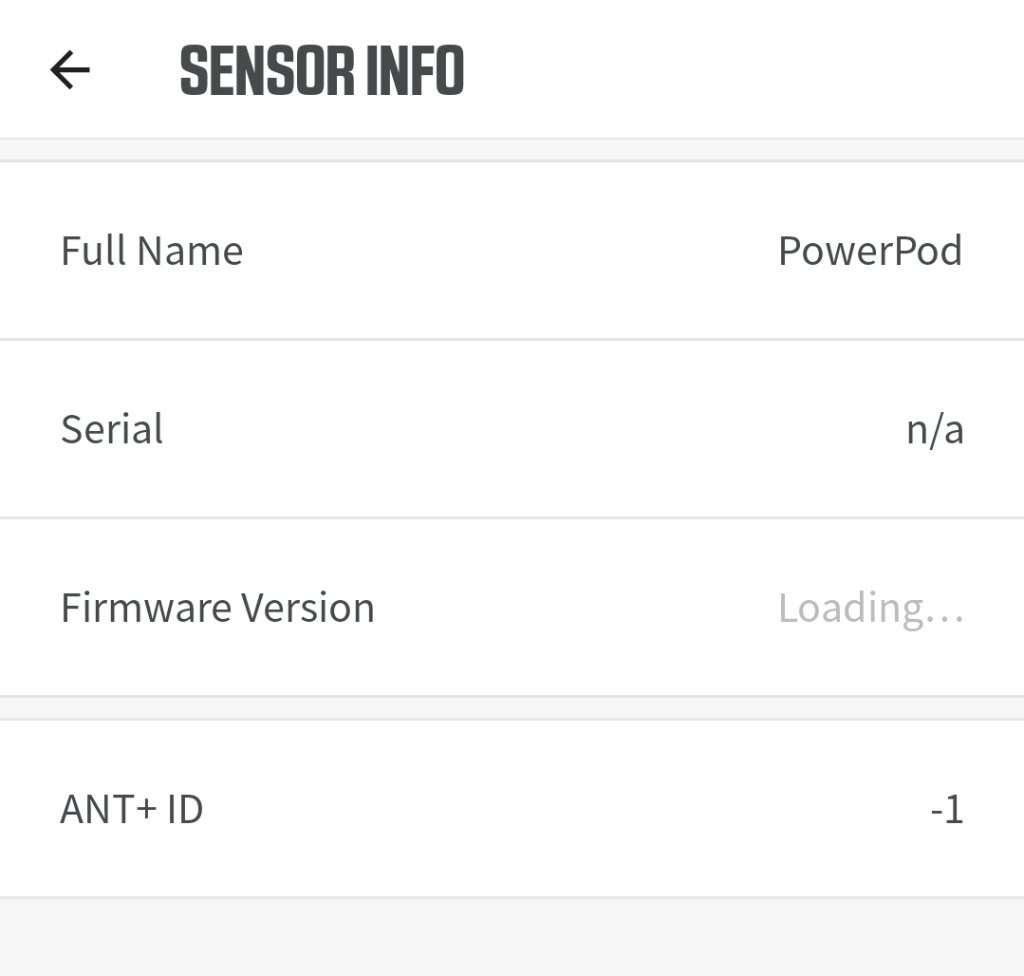

Thanks Tom,

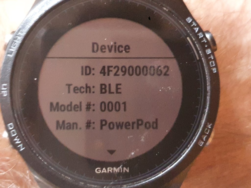

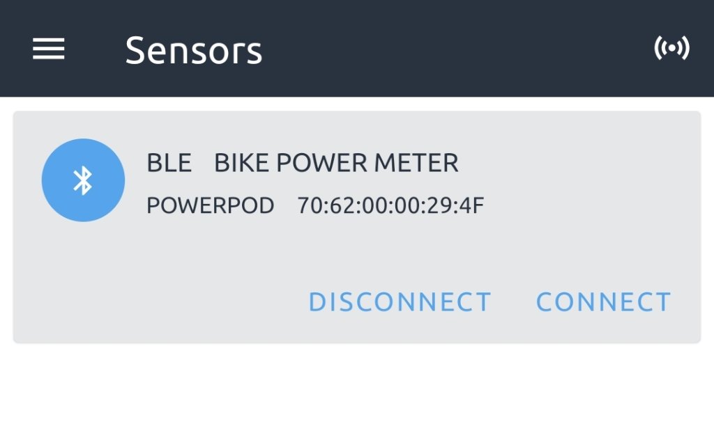

Yes the sensor is showing as connected by BLE under details, I also found out the Wahoo App on my phone now only uses BLE (even though ANT+ is supported on my phone) This explains why I can only view on one or the other.
1. I have tried disabling and or removing the PP on my Garmin and searching again hoping to pick-up ANT+ without success.
2. I have tried another cycling computer App that DOES support ANT+ I have confirmed by disabling BLE on my android phone and connecting my HRM - unfortunately it cannot find the PP
Both my Garmin and Android phone apps find the PP by BLE almost instantly. Is there a procedure for connecting ANT+? does the PP have to be transmitting Power?
Interestingly on my Wahoo App all connected sensors display a ANT ID, however, for the PP the ANT ID is - 1

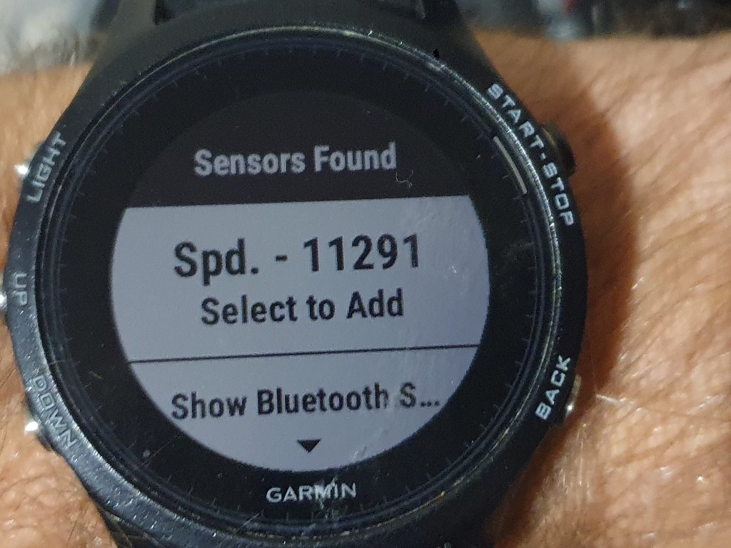

I just learnt that with Garmin both ANT + BLE sensors are shown simultaneously when searching. By default ANT is shown first then BLE. I have been unnecessarily connecting both ANT + BLE on dual transmitting devices.
Example for my dual transmitting Speed Sensor it first shows ANT then if I select "show bluetooth devices" I can connect BLE too.
I'll try mounting PP and ensure it's connected to speed sensor and try again

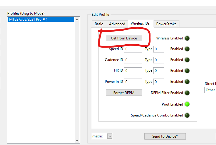

If I connect the PP to my PC then "Get from Device" under my profile--> wireless sensors it appears all connected sensors are now forgotten..
But if I hold the button down for 4 seconds to get flashing green light , it just stays flashing for around 2 minutes and never connects.... I'll try a factory reset again.

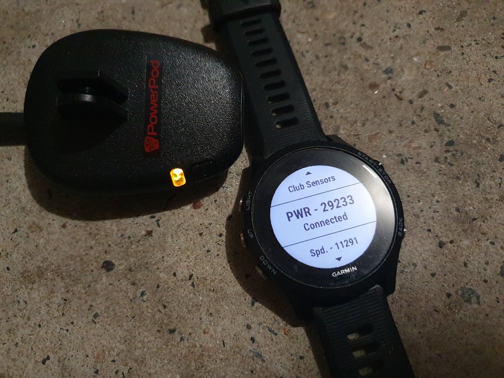

SUCCESS!!
No factory reset
1. I restored profile and sent to device (restored wireless IDs too).?
2. Woke up Speed Sensor
3. Clicked PP button Once. The light shows solid YELLOW
4. searched for sensor on garmin and there it is
No factory reset
