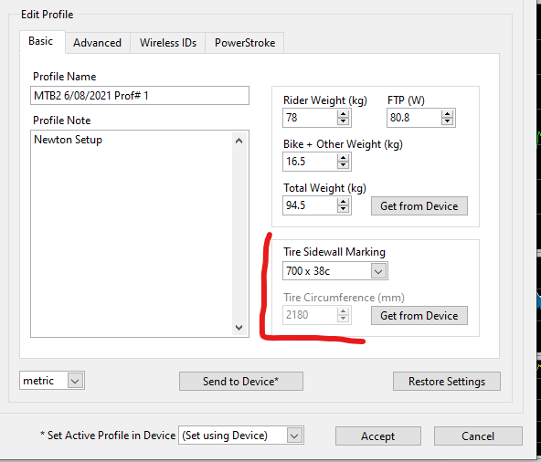

The option for editing the Wheel Circumference in Isaac is "greyed out" I only have options from the drop down list - these predefined values do not match
I am looking at my profile information
Screenshot 2021-08-07 071547.png (31.23 KiB) Viewed 6649 times
Re: First Ride Calibration Check
Thomas wrote: Fri Aug 06, 2021 5:15 pm Hi John,

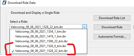

4. When I connect the PP to my computer and select Get Rides there are 2 available 1 x 400m ride? and 1 x 22KM ride = my 40min test ride. I was expecting to see a calibration ride?
download ride.png (18.18 KiB) Viewed 6545 times

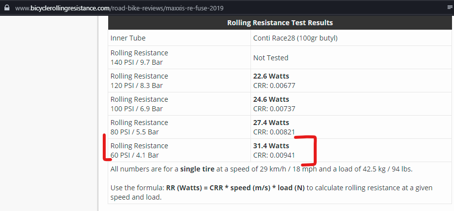

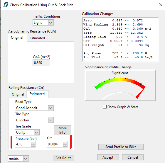

5. I then check the 22KM ride and adjusted the CCR based on the Model/Pressure I am running. I took the data from bicylerollingresistance.com I run at 4.1 Bar as opposed to the estimated 7.48 Bar would this be the right type of adjustment for me to make?
CCR Adjust.png (39.66 KiB) Viewed 6545 times
For the most part the displayed Watts seemed logical on climbs in a medium gear 300-400Watts, however, often once I had crested the climb, changed into a high gear and was (I felt) applying alot of force on the flat the power would drop into low 100-150Watts - is this simply the PP adjusting or a delay?
Not sure if I Calibrated correctly or not?
