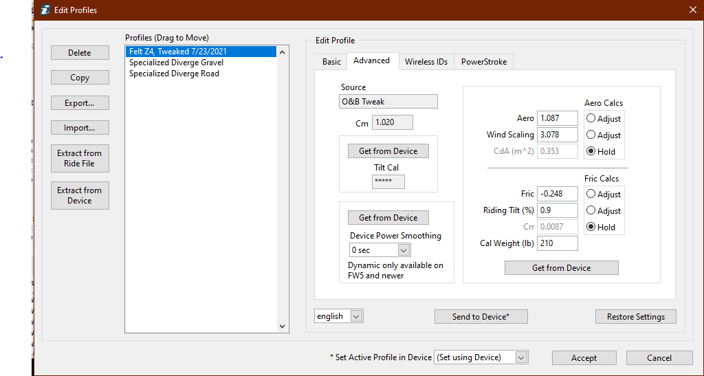

John could you take a look at this out and back after my calibration ride. My friction came back at a -0.248. When I tried to send the profile to the Powerpod I get a notification box saying that -0.248 is outside the allowable parameters 0f .10 to 100.00
Isaac screenshot.PNG (56.69 KiB) Viewed 11356 times

The problem is that you changed your mounting angle between the original cal ride and this ride.
Please post the original, "unrepaired" ride file, and I will fix things for you.

Your ride file shows that your unit did not complete a calibration ride.
Please check the instructions to learn how a cal ride is done.
In the mean time, I have used your 20 mile ride to correct your ride file and create a profile. You should be able to load this profile into your device and get good results.
dmwelk.ibp
(507 Bytes) Downloaded 522 times
dmwelk_corr_07_24_2021_1002_20_Miles.ibr
(251.26 KiB) Downloaded 483 times
