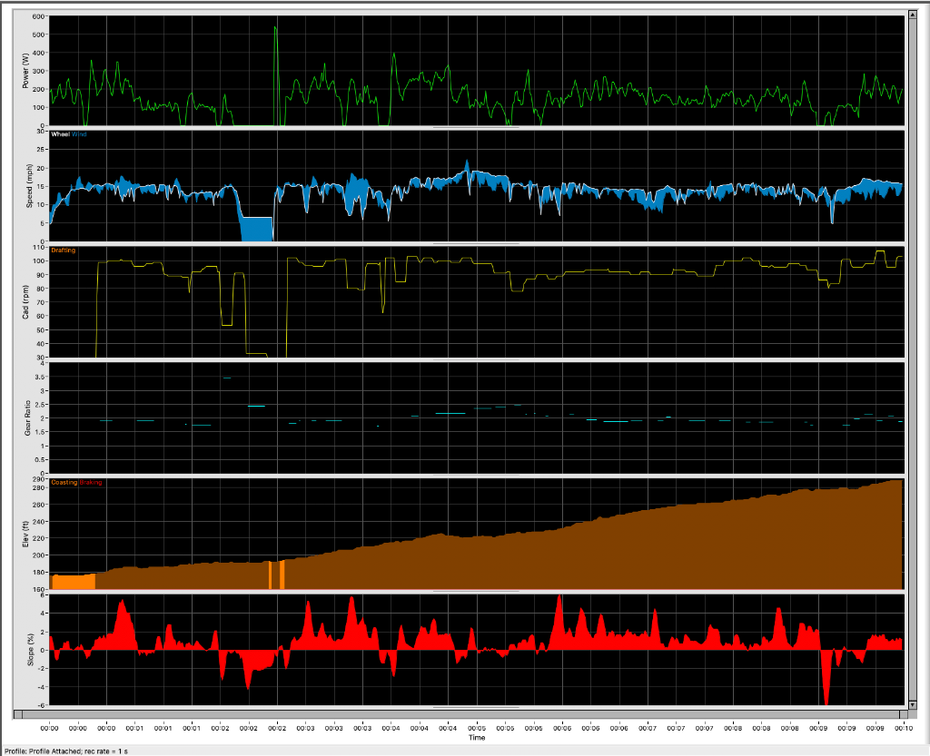

Your speed sensor data has spikes in it. What kind are you using? Where is it attached?
There is a very odd place in the file, at minute 2, where your speed is flatlined for about 30 seconds. This doesn't seem right...
I don't see anything else particularly odd in your short file (PPL records only the first 10 minutes of a ride file).
This could be a speed sensor problem.

My speed and cadence sensors are accelerometer based. I noticed the cadence sensor having some moments with 0 values without reason, this got solved with a new battery. The speed sensor is on the rear wheel, my front wheel has a dynamo and causes crazy interference, so I had no choice there. Will check if it also needs a new battery... However, today I got plausible readings, even on descents, still have some minor issues, but I think they could rather be related to the quality of the cadence sensor (when I stop pedalling it takes a few seconds before I get a signal again when it drops to 0). But this is ok, it is my commuting bike which I leave on the street some times, so expensive sensors are a no-go there.
