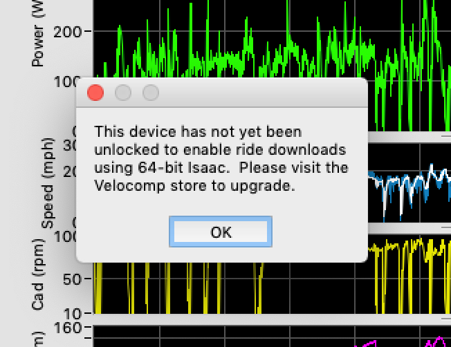

Brings me to my next question...when I tried that, I got this:

Re: Power Reading Low After Calibration
NRP79 wrote: Tue Mar 09, 2021 2:51 pm Brings me to my next question...when I tried that, I got this:
Have you been able to download rides other than this? When was the last time you tried to download? Try clicking the download buttons a few times, and let me know if you continue to get this message.

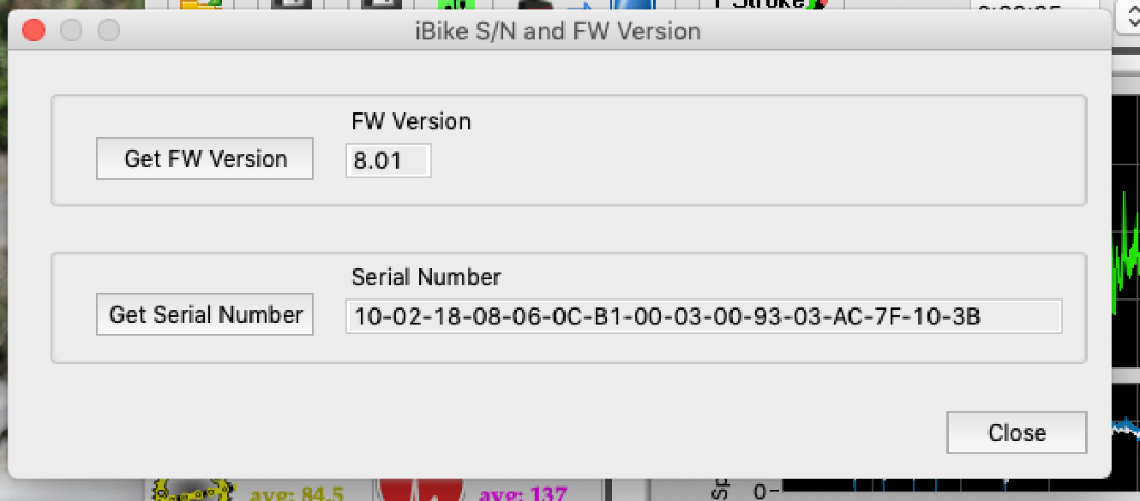

Also, go to Device/SN-FW version, and post a screenshot of that window

Hi, always says the same thing, only just started using in the last week and not been able to download anything as yet.
You have an older PowerPod, manufactured in 2018. You will have to purchase a key to make it work with Isaac/Mac. I won't explain why in this post this is a paid upgrade (short summary: Apple did it), but you can read all about it here:
