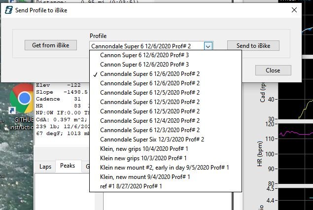

thanks for the quality answers. regarding the database sync to actual cal ride files in folder, i am referring to this in attachment.
many of those listed in the pull down do no longer exist.

Re: Slope offset from out and back calibration
Go to "Edit/Edit Profiles". You will see a complete list of all the profiles you have created and that are stored in Isaac.
Highlight the profiles you want to delete, then click the "Delete" button. Make sure to click the "Accept" button after deleting the unwanted profiles.
