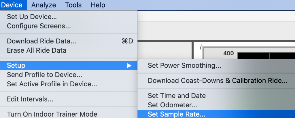

2) Go to Device/Setup/Set Sample Rate
Screen Shot 2020-04-20 at 1.56.24 PM.png (541.9 KiB) Viewed 41323 times

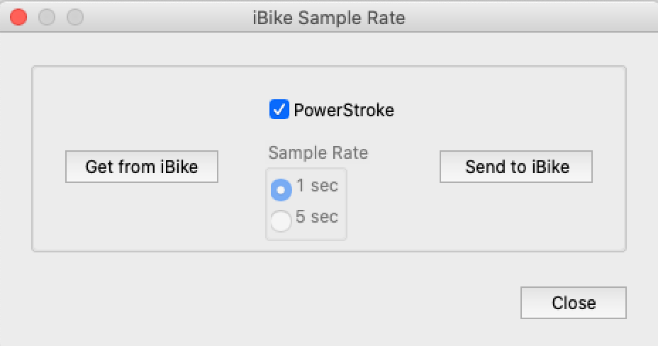

3) Uncheck the "PowerStroke" box
Screen Shot 2020-04-20 at 1.57.13 PM.png (27.31 KiB) Viewed 41323 times
4) Select "1 Sec" or "5 sec". "1 sec" increases record time to 155 hours; "5 sec" increases ride file recording time to 768 hours
5) IMPORTANT: Click the "Send to iBike" button
