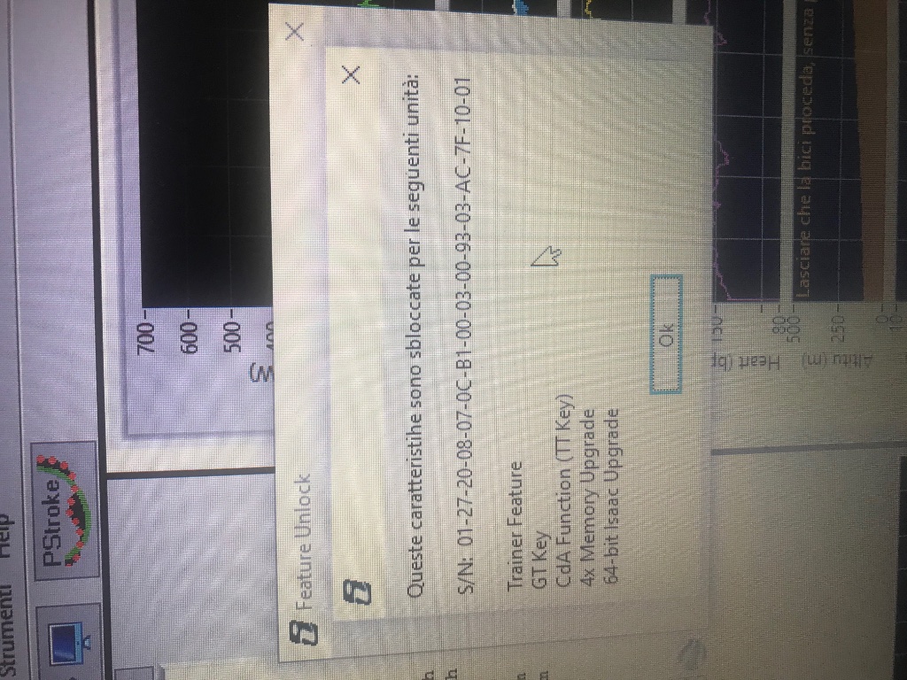

sandro2581987
Posts: 11
Joined: Tue Feb 04, 2020 9:25 am
Re: Nuove uscite aggiornamento cda e vantaggio
Post by sandro2581987 »
Ecco qui
Your AeroPod is calibrated and working properly.
Unfortunately, we have determined that there is an error in your serial number that is preventing the CdA Analysis and Power Meter Comparison features in Isaac from functioning properly.
Please email me at jhamann@velocomp.com so that we can provide you with further details.
In the mean time, I have corrected your ride files so that you can analyze them in Isaac.
AP_09_02_2020_1021_0_km.ibr
(143.12 KiB) Downloaded 600 times
AP_01_06_2019_0000_45_km.ibr
(617.36 KiB) Downloaded 585 times
