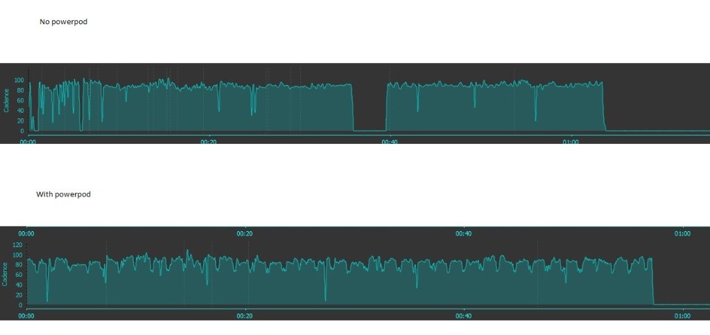

I have the powerpod V3 set up to my Garmin 530 edge with individual speed 2 and cadence 2 sensors. Before I set up the powerpod cadence measurements were consistent. However, when I use the powerpod cadence measurements keep dropping from 85-90 to 60-65 every minute or two for 5-10 seconds. I've attached a figure showing these drops. It's perplexing. I don't think it's affecting speed or power measurements but it is messing with both average cadence and estimated gear ratios.
I messaged Garmin about it and they told me it was due to the powerpod since it is overriding the cadence data sent to the garmin.
How would I go about resolving this? I tried removing and re-added all devices, using bluetooth and ANT+,
- cadence drops.jpg (40.84 KiB) Viewed 73981 times

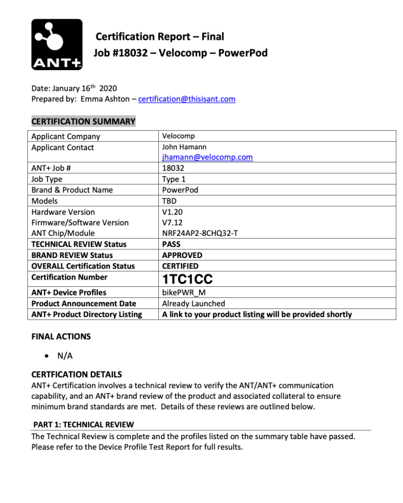

Our products are certified compatible by ANT+ (Garmin).
In other words...we are sending the data in accordance with the ANT spec. Why the 530 is having problems I cannot say.

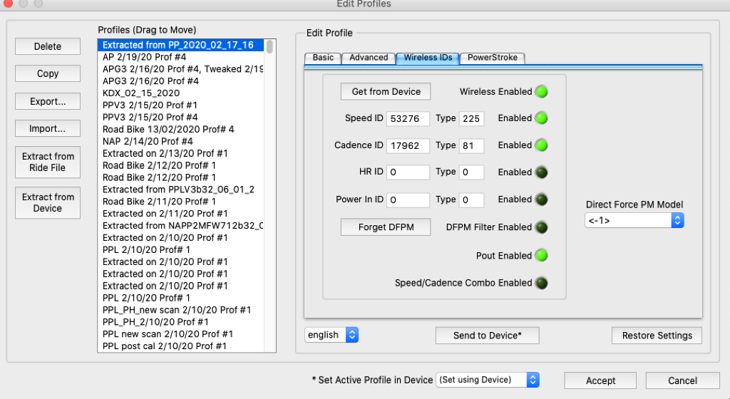

The only thing I can suggest is that you pair PowerPod to your speed sensor, with your cadence sensor turned OFF, so that PowerPod does not pair to your cadence sensor.
- Screen Shot 2020-02-04 at 6.01.56 PM.png (201.07 KiB) Viewed 73976 times

I see the certificate states firmware version 7.12. When do you expect to release this firmware version?
Re: Powerpod V3 causing drops in estimated cadence
FW 712 is a minor update to 711 that is in production. It will be released soon but it has no bearing on this issue.

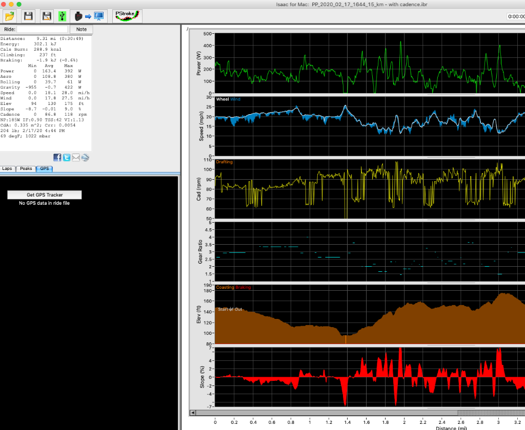

I see two problems:
1) your 1604 "no cadence" ride shows a paired cadence sensor in its profile (the same cadence sensor ID as in your "paired cadence sensor" profile).
So, when you did your no-cadence pairing, your cadence sensor was on (if cadence sensor was off, wireless ID would be 0). Please do another PP pairing, making 100% sure your cadence sensor is off. After you do this, you can extract the profile in Isaac, and confirm that the cadence sensor wireless ID is "0".
When PP has "0" for the cadence sensor then PP won't retransmit any cadence signals, and the cadence signal you see on your Garmin will come directly from the cadence sensor.
2) Your 1644 ride reveals the cause of your cadence dropouts. What's happening is that PP is getting intermittent signals from the cadence sensor, causing cadence dropouts in PP. You can see this in your ride file by setting ride file filtering to 0.
When PP is paired with your cadence sensor, PP transmits BOTH power AND cadence signals together in the power channel (this is an ANT+ standard). So, your Garmin is reading the intermittent cadence numbers transmitted by PP.
I don't know why PP is having problems receiving a reliable cadence signal; it seems likely that your cadence sensor is not transmitting a strong signal.
I have been using a Garmin cadence sensor, identical to yours, for 4 years now, without problems. You might want to see if Garmin will swap your cadence sensor under warranty.
In the mean time, the easy workaround is to do a PP sensor pairing, making sure the cadence sensor is off. In this mode you won't directly get cadence data in your ride file, but you won't see dropouts either. After the ride you can merge your Garmin .gpx data into your PP ride file to add both cadence and GPS data to your Isaac ride file.

Hi John,Velocomp wrote: ↑Sun Feb 23, 2020 11:13 am I see two problems:
Very strange, I don't understand why it would show the cadence sensor connected when the Garmin 530 showed it was inactive. It didn't collect any cadence data for the PP either, so it doesn't make sense. I will do it again with the battery out of the cadence sensor. I will also check in with Garmin about this. At this point, it does seem like it might be a sensor issue.
Thanks for troubleshooting with me.

I've just ordered a cadence 2 sensor. I will see if I can replicate the problem.
For what it's worth, PowerPod has been ANT+ certified, which means PowerPod passes all of the ANT+ tests that Garmin requires of manufacturers.
