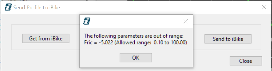

I've performed another calibration ride and then a solo ride.
After the solo ride (attached) I performed a check calibration, however when I try to send this to the PP I get a message saying that certain values are out of range (screenshot attached).
Could you check my ride file and let me know how I can send the profile to the device?

Re: Verification required
Your ride information looks perfect.
All that is happening here is that your PP position shifted slightly between calibration and actual ride, causing tilt correction to shift. As it so happens, the tilt correction causes, in Check Calibration, for the frictional value to become negative (which is not allowed).
There is no reason to change the profile. You have good numbers as they are; enjoy!
