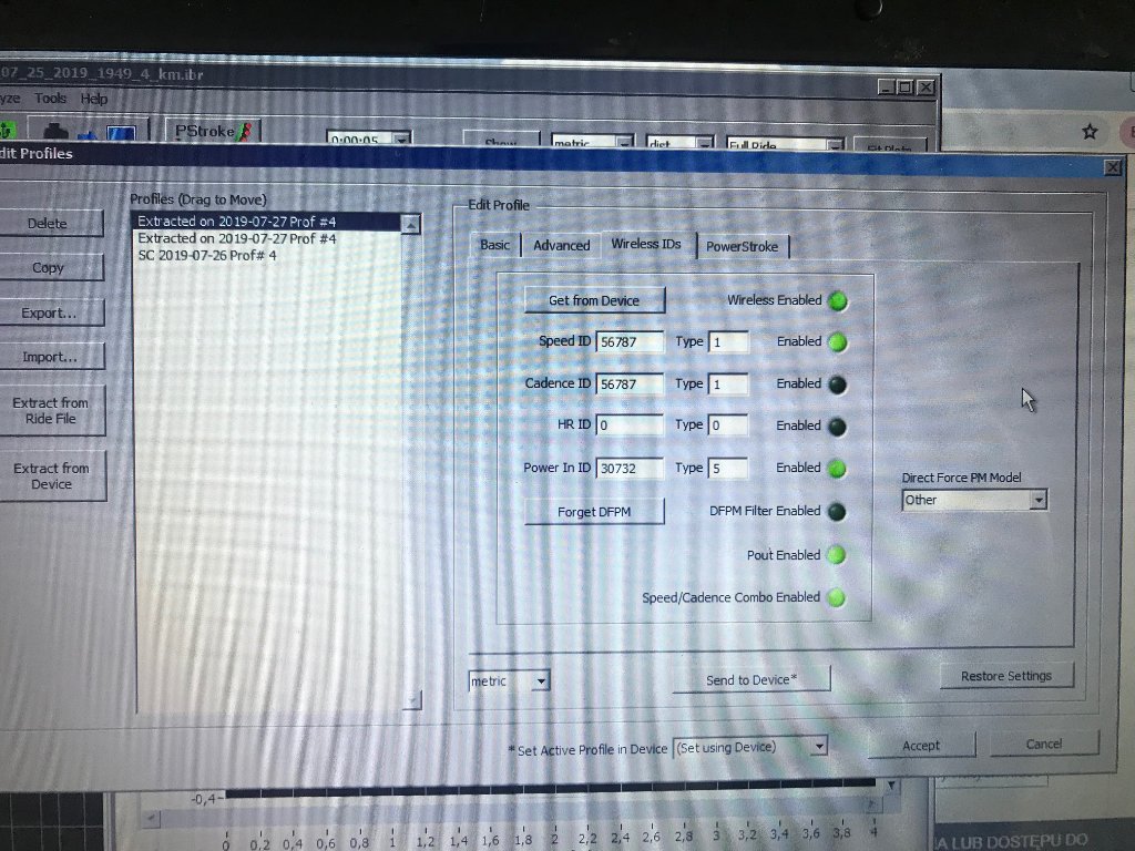

Re: Power not visible on Garmin after pairing with AP
I did new pairing anyway. Here is a screenshot from profile extracted from my AP as well as a short indoor "ride".
- iBike_07_27_2019_0825_0_km.ibr
- (5.17 KiB) Downloaded 334 times
- IMG-5397.JPG (172.87 KiB) Viewed 10977 times

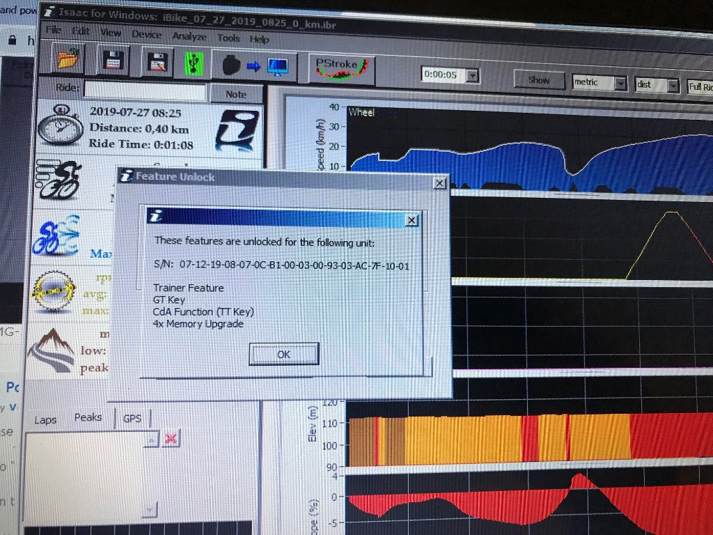

Please connect your AP to Isaac.
Go to "Device/Unlock Feature"
When the pop-up window appears click on "Unlock Status". Take a screen shot of the unlock status screen and please post it.
Here is the screenshot. After some adjustments I managed to get my DFPM numbers visible on Garmin through AeroPod. I'll keep you posted if I experience any issues. Thanks for swift replies!
- IMG-5397.JPG (172.87 KiB) Viewed 10963 times
I could not delete the previous post, so here is the proper screenshot
- IMG-5435.JPG (192.9 KiB) Viewed 10962 times
