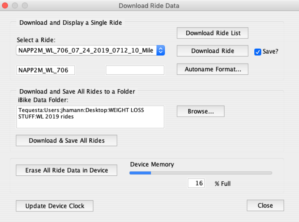

1) Attach PP to Isaac.
2) Click the Download button
3) When this window appears, click the "Show Download Window" button
Screen Shot 2019-07-24 at 4.04.33 PM.png (50.42 KiB) Viewed 3327 times

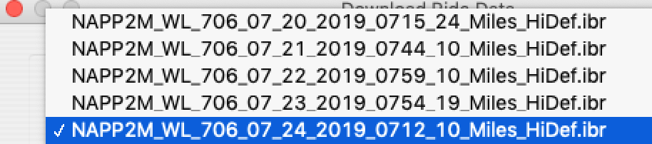

4) When the Download Ride Data window appears, click the dropdown menu next to "Select a Ride"
Screen Shot 2019-07-24 at 4.04.49 PM.png (121.43 KiB) Viewed 3327 times
5) The ride files stored in your unit will appear. The file checked is the most recent recorded (irrespective of the date shown), and ride files recorded earlier are listed above, in order of recording.
Screen Shot 2019-07-24 at 4.05.04 PM.png (39.89 KiB) Viewed 3327 times
If the ride dates are wrong it's because your unit was reset. After connecting your unit to Isaac the internal clock will be updated automatically.
