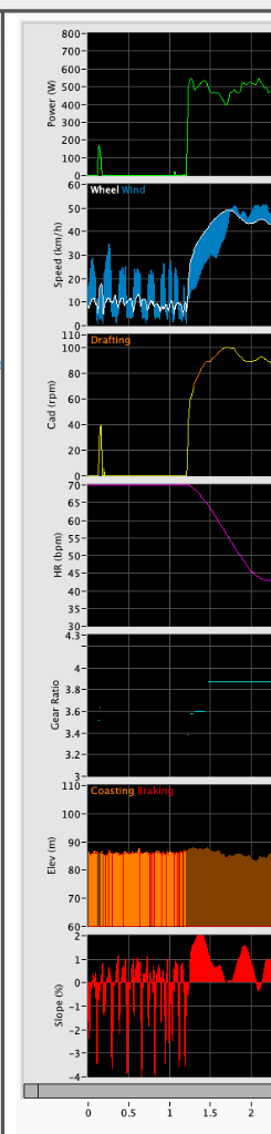

Your 17KM file has a serious problem. When using latest-generation FW, the first 5 minutes of any new ride are critical. You need to ride at reasonable speed (20KM/H +) at an even pace. At the beginning of your ride your speed was only 9km/h, and your speed fluctuated. The result of this is that your AeroPod was "locked in" with an incorrect tilt calibration.
Screen Shot 2019-07-23 at 3.47.34 PM.png (53.72 KiB) Viewed 5943 times

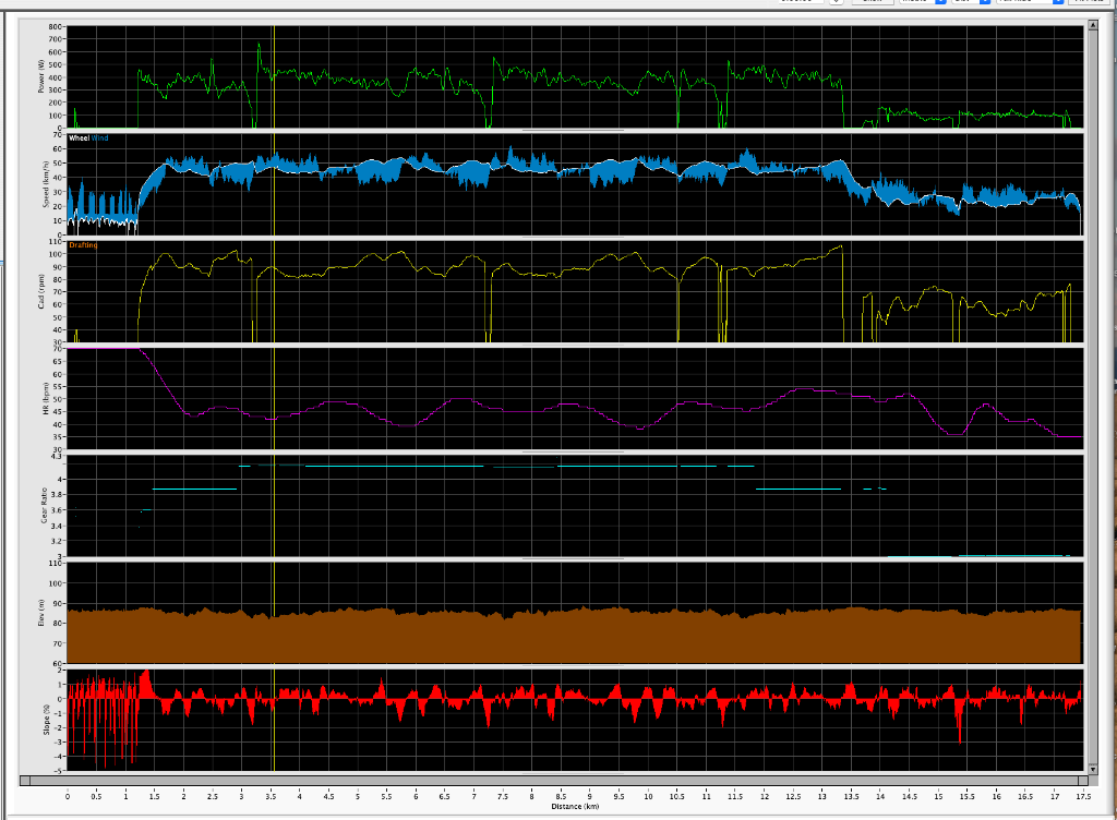

You can see the effect of the incorrect tilt calibration for the remainder of your ride file. Notice that, though your course is fairly level, you have a consistently positive slope (in red):
Screen Shot 2019-07-23 at 3.49.09 PM.png (133.59 KiB) Viewed 5943 times
When tilt is incorrect, CdA will be incorrect. In your case your AeroPod thinks you were going uphill during your ride (positive slope). So, opposing watts were higher, which forces CdA down.
Fortunately there is a way to fix this in Isaac: use the "Analyze/Analyze Route" command. Notice that, after applying the fix, that slope hovers around zero:

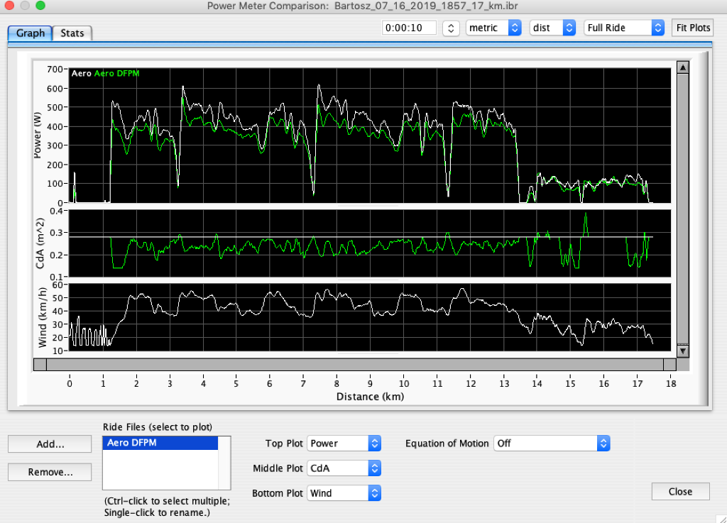

Once the tilt is fixed, you can use the "Tools/Power Meter Comparison" feature to view CdA of the repaired file (the Tools/CdA Analysis item does not work with repaired files)
Screen Shot 2019-07-23 at 3.55.06 PM.png (122.05 KiB) Viewed 5943 times
Your CdA is around 0.235. I see 3 laps:
km 3.5-7.5 CdA = .237
km 7.5-11.5 CdA = .233
km11.5-13.5 CdA = .241
Lap 3 is shorter, so that may account for the slightly different CdA.
For your 10Km ride, I get:
km 0-4.3 CdA = .236
km 6.6-8.2 CdA = .240
So, I think your results are much better than you think!

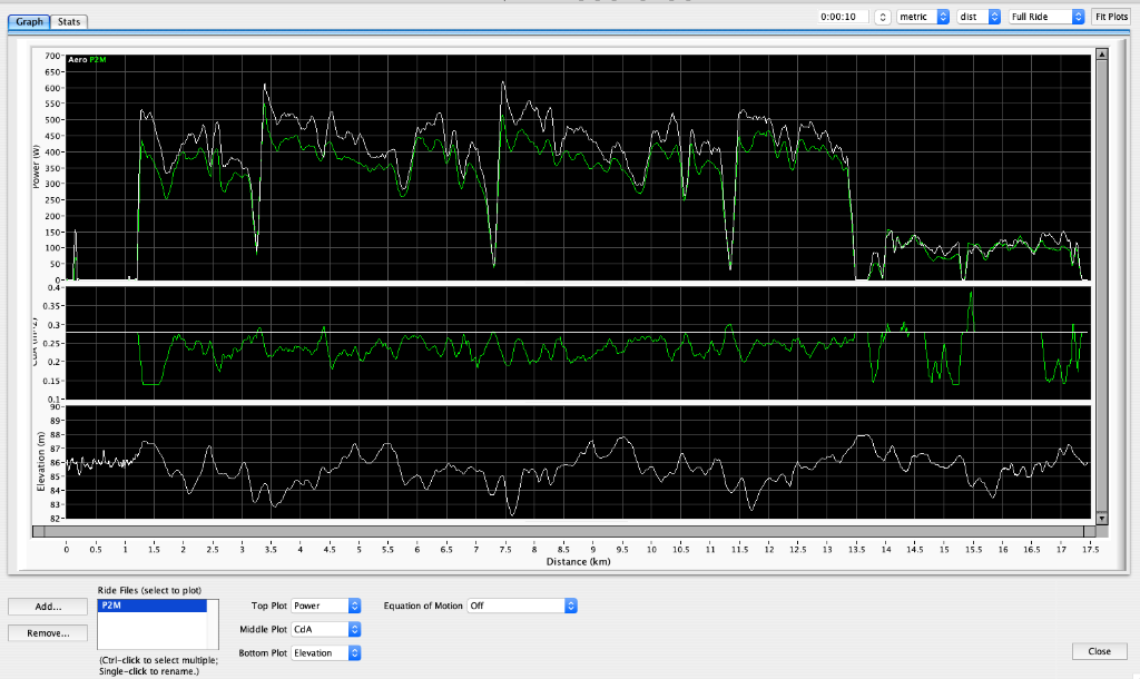

YouR headwind/tailwind sections are very short; about 1 minute. This is too short a time to get a stable CdA reading. However, once the files are corrected I don't see a significant CdA change that is a result of wind changes

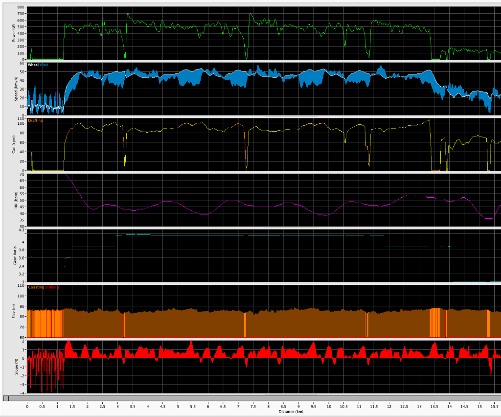

Hello John,
Before your first answer to my question I rode a time trial on the same racing circuit as my previous rides. Not knowing your request I hadn't done any hard reset before that ride, just turned aeropod on, paired it with my other sensors (exactly the same bike and equipment as with previous rides), rode first 5 minutes with even pace to let the device calibrate, did some >10km warm up and then time trial. I've just downloaded the file to my computer and could run CdA analysis without any problems. I attach that file to this post. Could you please take a look at it and check if it also has the problem noted by you with previous files?
Regards,
Bartosz Zbierajewski
iBike_07_23_2019_1802_34_km.ibr
(178.52 KiB) Downloaded 294 times
Re: Strange differences between CdA values
Good news; your DFPM data is there!
Your data looks great...good job with the calibration.
Your CdA is very stable at 0.254
