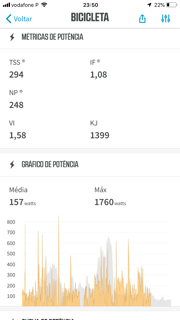

After a while it was reading power and I believed that everything was fine, since the unit always gathered credible power numbers for me. Nonetheless, a few minutes later in some efforts I've clearly saw that the power figures were all over the place. I was making 1700w in a sprint :o

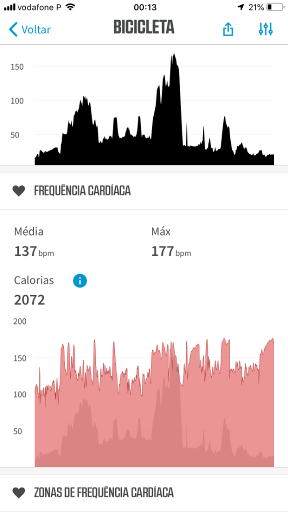

At home I've tried to download the data and the second issue appeared. No GPS data (I have the upgrade installed), and what it seems to be 2 ride files instead of one (I assume this because I've arranged files by date added and I see no data with the kms I've made today).

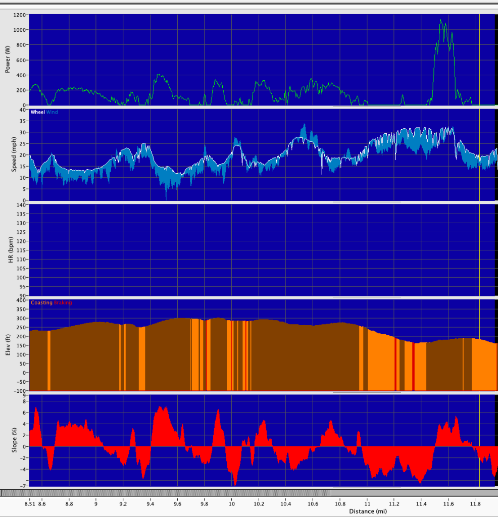

Yikes!
I see several problems:
1) Your HR strap is recording data only intermittently. This would not cause power problems but it makes me wonder about the quality of your pairing
2) There is the usual "noise" in the Wahoo speed sensor signal. This is not fatal, but...
3) There are speed sensor dropouts (where speed goes to zero). I suspect this is a cause of your wacky watts
4) I worry that your mount is not securely attached to the bike, or that PP is rotating on your mount. Either would also cause crazy watts
5) The dropouts in your speed signal may be causing the failure of GPS data to merge properly.
Other than that, everything seems to be OK... :roll:

I don't know what figures is the ride files showing, but I can assure things are not ok. I'm posting a picture here for you to see the power metrics exported from PP to the Elemnt app.
I wish I could but never in my life I can put out 1760 watts in a sprint or do an easy ride (like this was for me), with a Normalized Power of 248 watts!

I've combined the 2 files and it shows 74 kms. There's about 2 kms missing (when PP battery died). Nonetheless, Isaac tells me that the FIT file from my Wahoo don't have GPS data (which is not true), and won't let me export to Strava.
That and all the fields from "Use from other ride file" are greyed out, except Distance. But even that it won't let me import from the FIT file and if I try Isaac shows me all data at Zeros.
From the picture I'm sending you can also see that HR data is good on the FIT file.

I've looked at your ride file and I find it quite puzzling.
Where your watts go crazy there is a change in your tilt correction. But, you say, your mount is not moving at all...
By any chance are you riding on really rough roads?
I think you're saying that this is a recent problem. Please post some older ride files where you did not see this problem.
Your HR data remains weird. I don't trust Polar stuff very much; I don't think they do a good job of implementing ANT+ standards.
