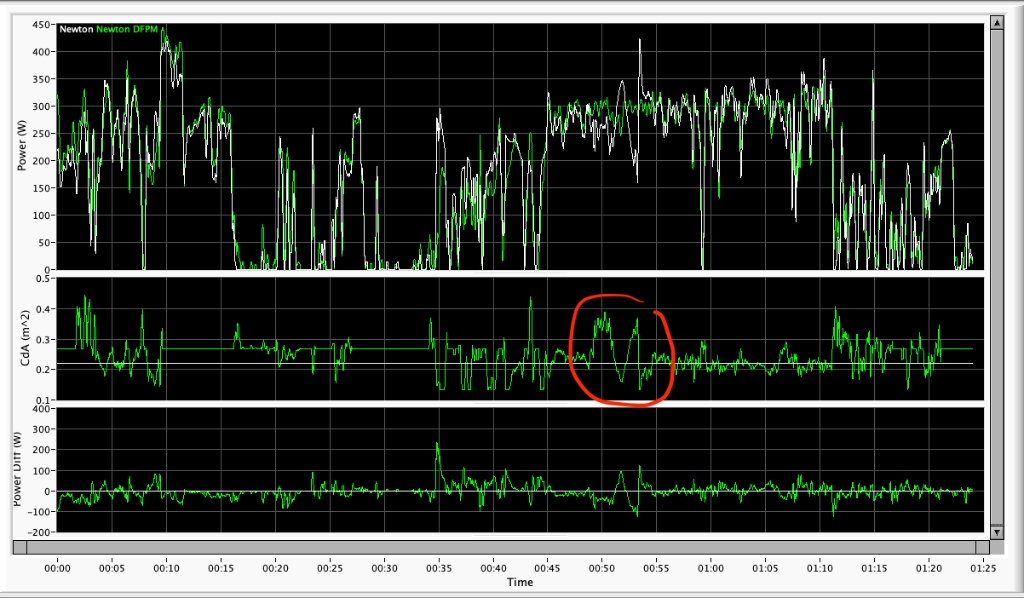

Speaking of Consistency. Today I had a strange CdA increase for about 5 min during my test ride, and then it went back to normal. Any idea why that could be?

Re: Aeropod data not consistent - velodrome environment - Blaine
I looked at your ride file. The file you provided had been processed through Isaac. I used the "Analyze/Return to Original Download" command to see the data that was actually processed by your AeroPod.
The raw data shows that your AP was knocked out of position around minute 27. At minute 54, where CdA returns to normal, it was put back into the original position.
Make sure your AP cannot rotate on your mount.
