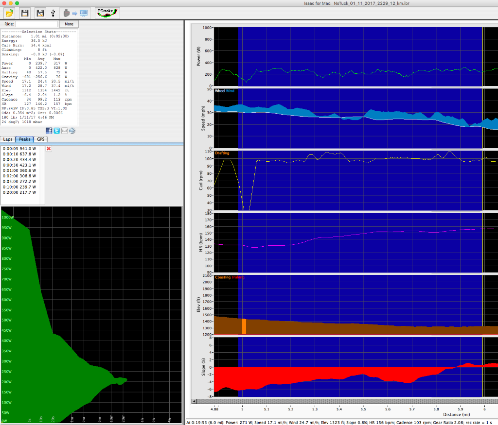

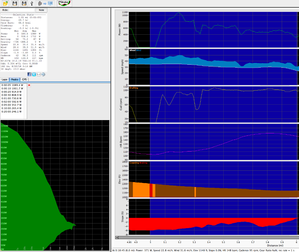

It is EXACTLY as I thought, and this is instructive for everyone.

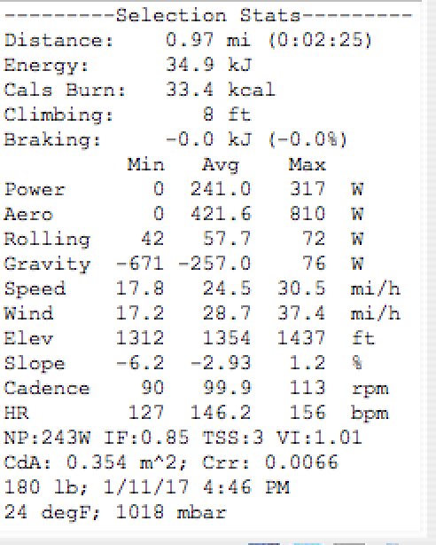

Your 1/11/17 ride shows "normal" 241 watts in the descent between mile 5 and 6
Your 8/20/18 ride shows "high" 580 watts on the same descent, between mile 5 and 6
You say that you did not pedal harder on your 8/20 ride. Why, then, is there such a large power measurement difference? The detailed stats provide the answer:
On your normal-watts, 1/11 ride, you descended at a speed of 24.5 mph, and your heart rate (directly related to your power) was 146
On your high-watts, 8/20 ride, you descended the same hill at a FASTER speed of 30.6 mph (6.1 mph faster) , yet your heart rate was LESS, 134, meaning that your body was not working as hard.

ON YOUR 8/20 RIDE YOU DESCENDED THE SAME HILL IN A TUCK; YOU WERE MORE AERO, AND SO YOU WENT DOWN THE HILL FASTER!!
As I said in a previous posting, PowerPod does not "know" when you become more aero; when you become more aero relative to your normal ride position, PowerPod attributes the extra speed to you pedaling harder (more watts).
It's also useful to note that "aero watts" increase as the cube of bike speed, so as you descend faster, aero watts differences measured by PowerPod will become GREATER.
There is nothing abnormal about your PowerPod readings.
