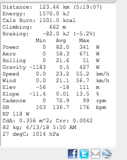

Regarding Elevation. I don’t see total elevation stats on Isaac. Only the highest altitude and maximum grade. Can you confirm on my 128km ride that PP registered a total elevation around 900m?
If yes, is it my Bolt again doing the wrong math? Again,it never happened before. Ca it be due to the same pairing issue?

Make sure you're looking at the advanced stats view in Isaac.
Isaac shows you gained a total of 662m on your ride.

Advanced stats. Thanks for the tip.
About gained elevation, that’s way off, hence my question on how it is measured. I can send you a Ride With GPS file with that route for you to confirm that elevation is around 900m.
Strava corrected it automatically to 912m. What can be wrong for PP to register such a different elevation gain?

I don't trust Stava elevation data at all. Strava uses maps to guess at elevation climbed information; we use actual on-the-bike measurement.
As an example of the kind of errors Strava produces: I live in south Florida, where it is EXTREMELY flat.
On June 2 I did a 9 mile ride ride, where my PP showed I gained about 72 feet (there are two short, 2% bumps; the rest is nearly flat) . Strava showed 161 feet gained for the same ride, over 2x the amount. The Strava guess is ridiculous. My consistent experience is that Strava overestimates elevation gained.

I understand that GPS elevation isn’t the most accurate as you say, but I’ve only resorted to Strava elevation estimation since I’ve found an enormous discrepancy between my past rides on this route and this one.Velocomp wrote: ↑Sat Jun 16, 2018 12:51 pm its don't trust Stava elevation data at all. Strava uses maps to guess at elevation climbed information; we use actual on-the-bike measurement.
Past rides were done with Wahoo Bolt alone that has a barometric altimeter, and data from it for the same route always showed a bigger elevation than 600m climbed for this route.
I’m only concerned about this because it’s a 300m difference. That’s a third difference!

I really don't have anything extra to add to this.
GPS elevation is inherently inaccurate.
Strava uses maps and, maybe, GPS information. More guessing.
We use baro sensor data.
The thing to do is to pick your preferred way of getting the data, then stick with it. Consistency is sometimes more important than absolute accuracy.
