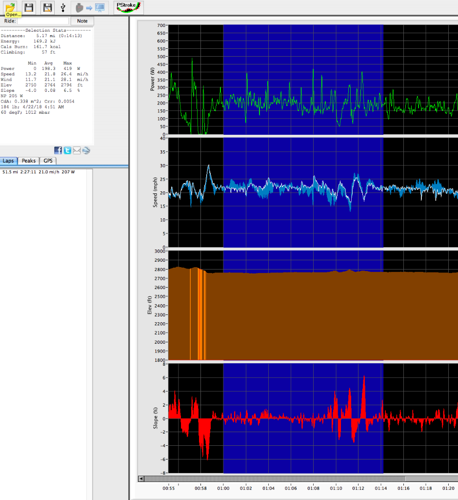

One other thing: you're thinking that your PP reads about 80W low.
I took a look at your ride files and I don't see how that can be the case
1) In your 87KM ride file you have a 23 minute section where your speed is pretty constant and you are riding on the flats
2) In that section you are traveling at 21 mph and your power is 193W
3) your PP is properly calibrated
It would simply be incorrect for PP to report 270W for riding at 21 mph on the flats.
- Screen Shot 2018-04-23 at 6.44.30 AM.png (181.96 KiB) Viewed 4119 times

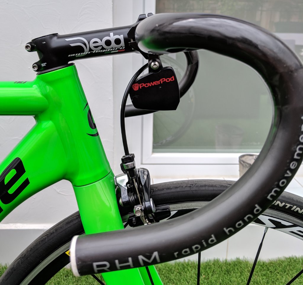

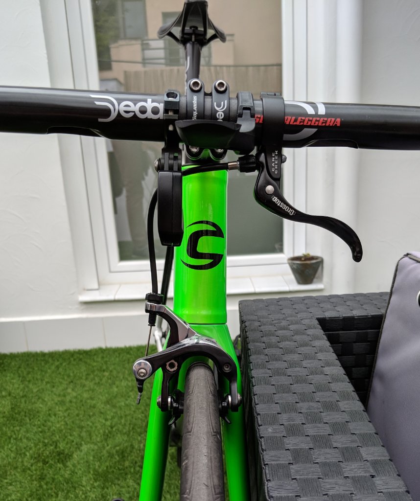

Bike is a track bike and the PP is on the handlebar mount... see pictures.
- MVIMG_20180423_143853 (1).jpg (133.59 KiB) Viewed 4113 times
- MVIMG_20180423_144052 (1).jpg (136.56 KiB) Viewed 4113 times

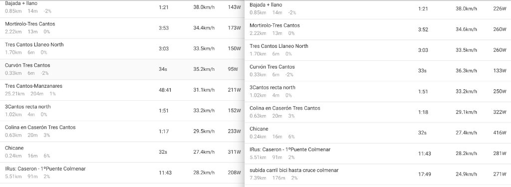

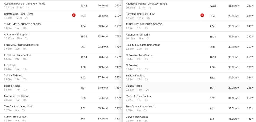

Here are some like for like sections with my friend... on Saturday's 115km ride.Velocomp wrote: ↑Mon Apr 23, 2018 6:45 am One other thing: you're thinking that your PP reads about 80W low.
- WhatsApp Image 2018-04-21 at 14.25.29.jpeg (64.27 KiB) Viewed 4112 times
- WhatsApp Image 2018-04-21 at 14.26.01.jpeg (49.8 KiB) Viewed 4112 times

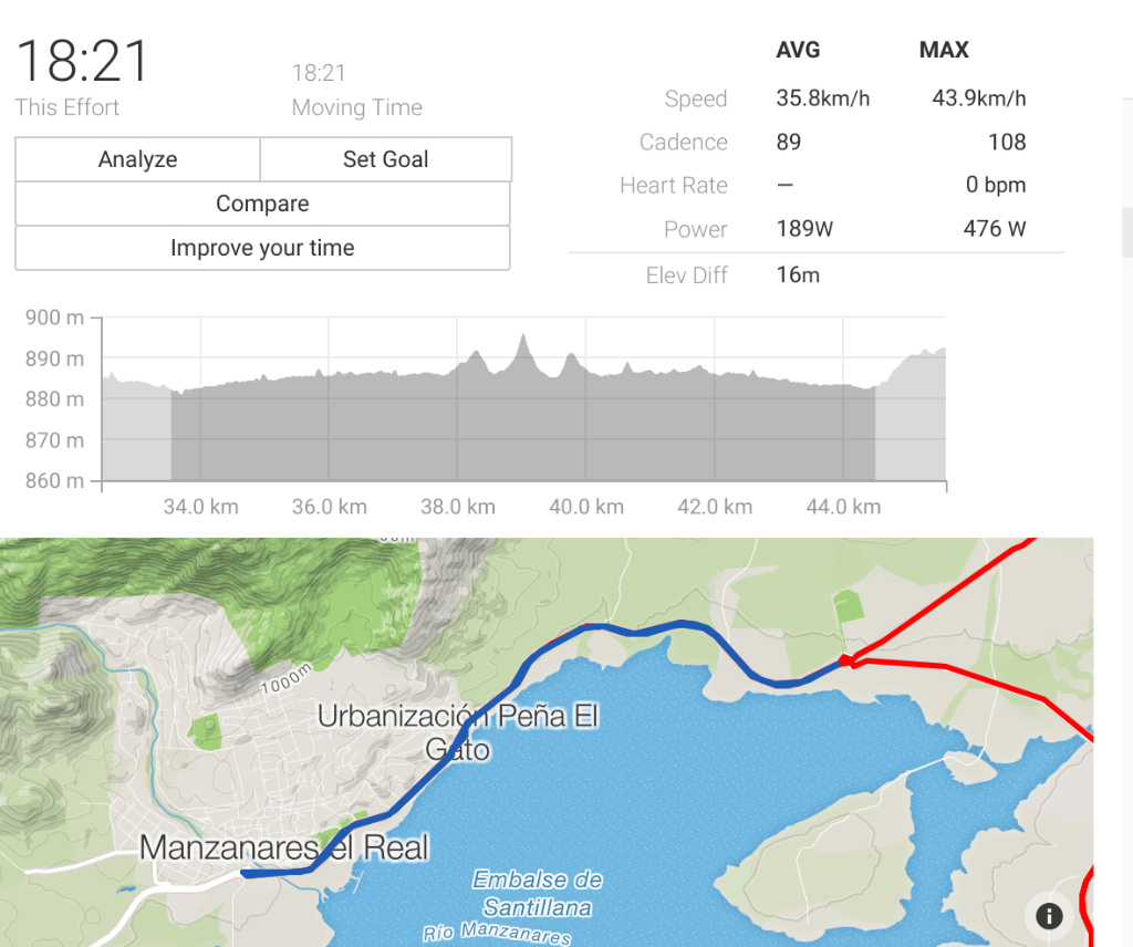

This is roughly the same section on Saturday out and back
Average 35.8kph Power 190w
My estimate it should be more like 240w here right?
- Screenshot 2018-04-23 at 15.22.26.png (508.41 KiB) Viewed 4102 times
Re: Help with low reading
The issue *might* be that your PP is mounted too far from level.
The word "PowerPod" should be approximately level. In your images it is mounted pretty high in the air; it looks to be pointed up about 20 degrees, way too high.
Re-attach your mount so that PP is closer to parallel, recalibrate, then send a new ride file.
