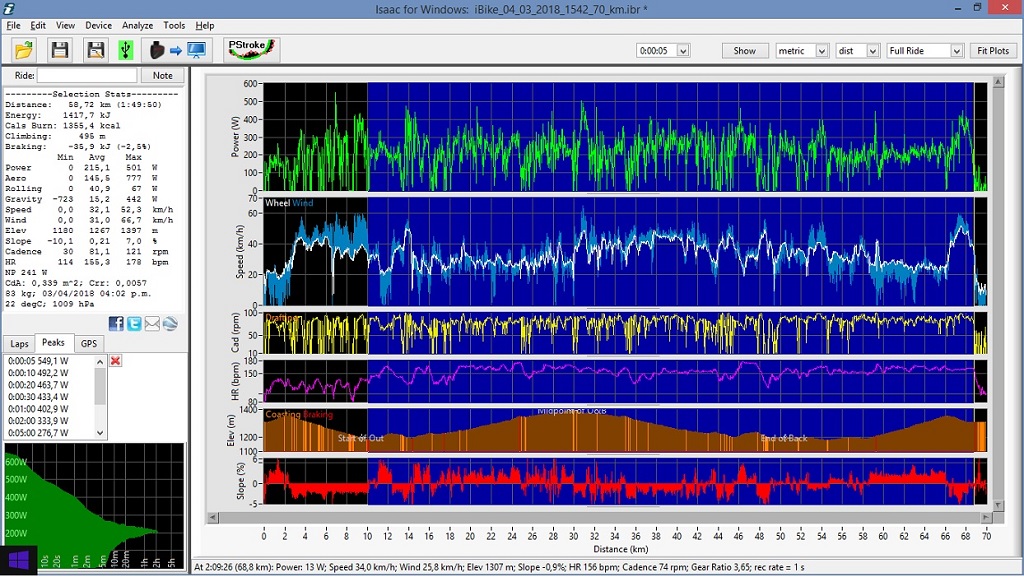

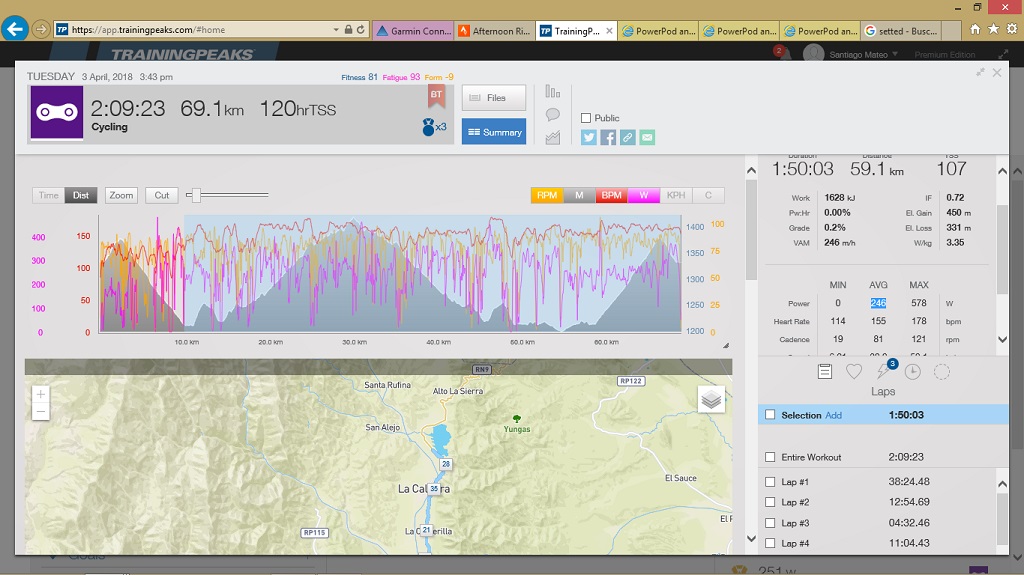

Hi. I`m still struggling with my powerpod since I set up the second bike with another speed but the same cadence and hr sensors.
This time the head unit shows me higaher power values than the ones obtained once I download the ride on Isaac
higher power on unit 1.jpg (171.28 KiB) Viewed 1878 times
higher power on unit 2.jpg (275.35 KiB) Viewed 1878 times
It seams that when transmitting to the head unit it takes a higher Wheel circumsference value and when download on Isaac uses the correct one? Please help!
iBike_04_03_2018_1542_70_km.ibr
(670.57 KiB) Downloaded 245 times

Check that when I analize device settings, It shows higher power values than in the main Isaac screen (230,6 vs 198,6)
higher power on unit 3.jpg (246.22 KiB) Viewed 1876 times
