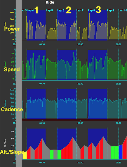

I've attached an O&B cal ride and a ride file for a 3x(5 minute Z3 + 3 minute recover) interval workout that I did yesterday. Intervals start at around 26.5 minutes.
The following image represents what I saw during my ride. During my intervals, I saw (on my watch) zero power for about a minute in each 5 minute interval. I never stopped during these intervals, and I did my best to put out power on the declines.
Three intervals representation
It's been frustrating because I've been experiencing these problems for approximately the last eight rides. Going forward, I'll be doing more zone training, and I need reliable data so that I can stay focused on my training instead of the sensor issues.

Yes, I do see dropouts in your speed data. These dropouts will also cause screwy problems with power and slope.
Presumably, Tom has asked you to "hard reset" your speed sensor and to install a new battery. Have you done both of these things?
If you've done both these things and there still is a problem, then it would appear your speed sensor is defective.
