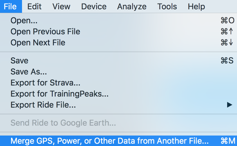

Re: PowerPod Ride Configuration
You can do just what you want, as follows:
1) Save your Garmin ride as a .gpx file
2) Analyze your PowerPod file as you wish
3) Use the command "File/Merge GPS, Power or Other Data from Another File..."
4) Select your Garmin GPS data and sync
5) Save the combined file.
6) You can then export the merged file as you wish to TrainingPeaks etc.

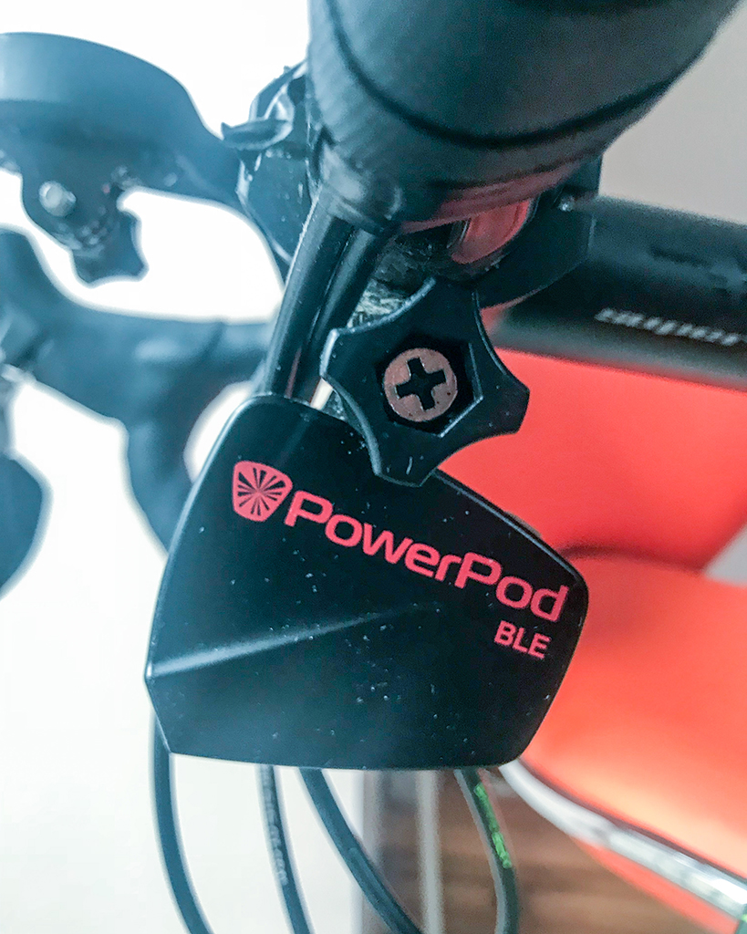

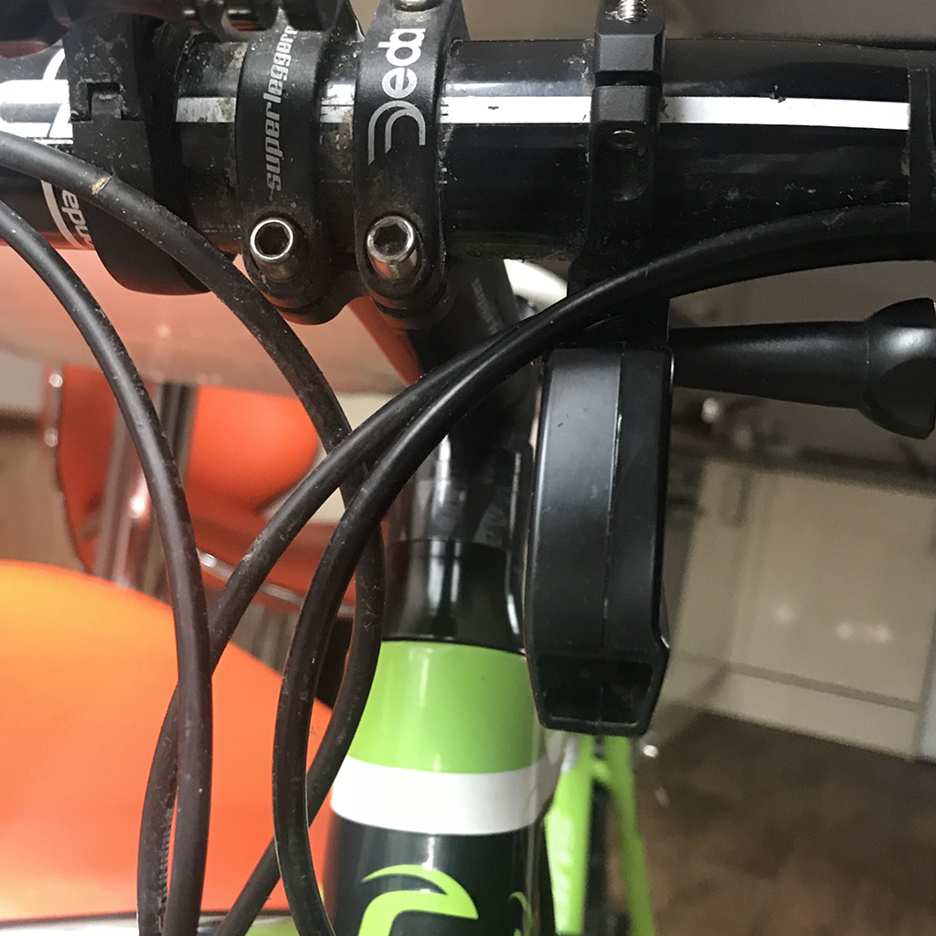

My PowerPod is mounted on the supplied handlebar mount, in the location and pushed forward as described in the user manual and Velocomp YouTube video: PowerPod Out and Back Calibration Ride. The pictures I’ve supplied illustrate this.
I keep trying to hold the faith with PowerPod because the concept of using opposing forces and drag to measure power, coupled with the cost appeals to me but, I am now worry that spray being kicked up from a rider in front of me can clog the wind tunnel which in turn sends the data ‘squiffy’ and other things such has the process of ‘cleaning’ the ride file via Analyze/Fix Route... to eliminate the 8 minute re-calibration data that is recorded is just too time consuming. I simply want to ride my bike, have faith that the recorded power is accurate and consistent, finish my ride and sync to Garmin and et viola! All my sycned accounts are updated and all reflect an accurate representation of the ride and effort.
Tim
I'm sure John will confirm but the mount angle of your PowerPod is right at the maximum. As a rule of thumb the lettering on the side should be parallel to the ground..
Shift you mount and the PowerPod will adjust over the next 8 mins of you next ride. As it is set up it the wind port is more likely to retain any water from the rider in front gravity can't do its thing..
Secondly, I'd also just check to see if you cables cross over your wind port when turning, again this will mess up the readings. check this by turning the bars..
Peter
Peter
With PP pointed up in the air, you are actually reducing the ability of the wind port to remove water from the wind port. Please angle your PP closer to parallel with the road, and do a new cal ride.
