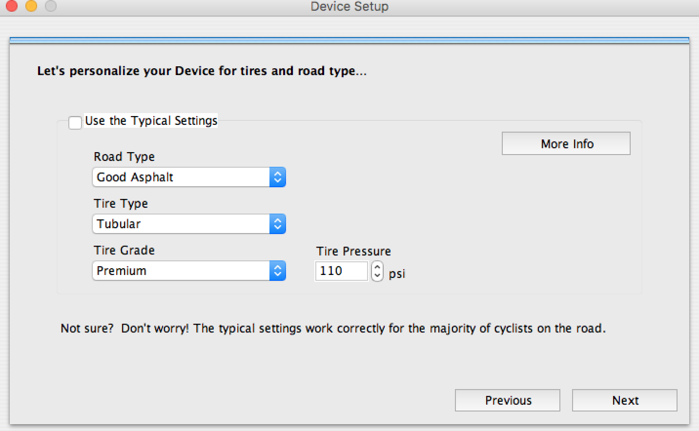

We are doing some additional checking.
In your TT setup (Device/Device Setup), what values did you select for:
Ride position
Road surface type
Tire pressure
Tire size
Tire Grade
In the tires and road type window, did you uncheck the "Use Typical Settings" box?
Ride position
Road surface type
Tire pressure
Tire size
Tire Grade

andrewkerr1991
- Posts: 17
- Joined: Fri Apr 21, 2017 6:59 am
Re: TT bike power pod check
Ride position = time trial
Road surface type = Good asphalt
Tire pressure =110 psi
Tire size = 700 x23c
Tire Grade = premium
In the tires and road type window, did you uncheck the "Use Typical Settings" box? yes i deselected this check box and entered the above i have tubs on my time trial bike this is why.
hope this helps.
Andrew
hope this helps.
Andrew
