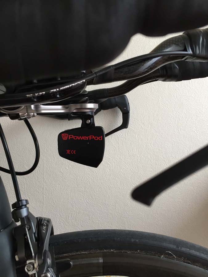

Please post images of your PP mounted on your bike: top side and front views.
I'm concerned the wind sensor may be obstructed.

Hi John
Many thanks for your reply... photos of the powerpod attached.
As far as i can see nothing blocks the air port and the unit is mounted to a metal K edge mount with a gopro adaptor underneath with the unit pushed against the stop so no movement there ... kedge is torqued up at the bars also.

Your PP setup looks fine.
Somehow your profile got screwed-up; your CdA is set for a cyclist riding on the hoods, and your Crr is for someone riding in sand! Both will increase watts.
Corrected profile and ride file attached.
Keep an eye on your wind values; I want to be sure these aren't too high.
