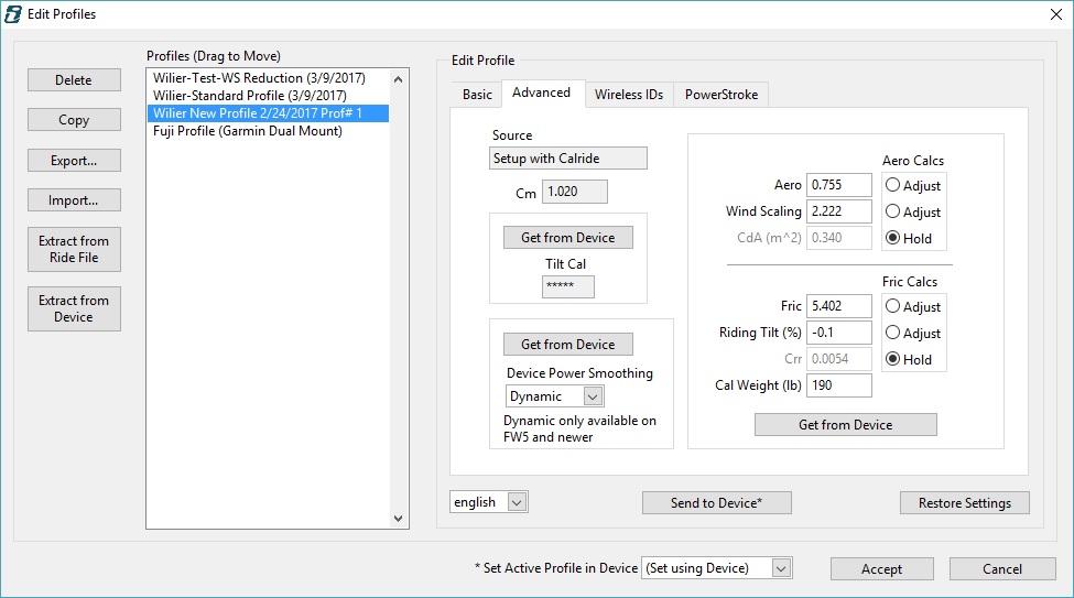

I used my O&B-calibrated ibr to tweak my profile, and now I'm seeing a wind scaling value that I believe may be high.
I have the dual mount from K-edge, which if I remember correctly tends to want a value around 1.7. Isaac is suggesting 2.054. The value *before* the O&B (the one generated by calride) was 2.222.
Is that within normal range of values, or is it indicative of something off?
Re: Calibration Ride Off; Fixed By O&B In Isaac; What's up?
The default values in PP are middle-of-the-road estimates for different mounting positions.
The O&B ride dials-in your PP. I would use the value it measured.
