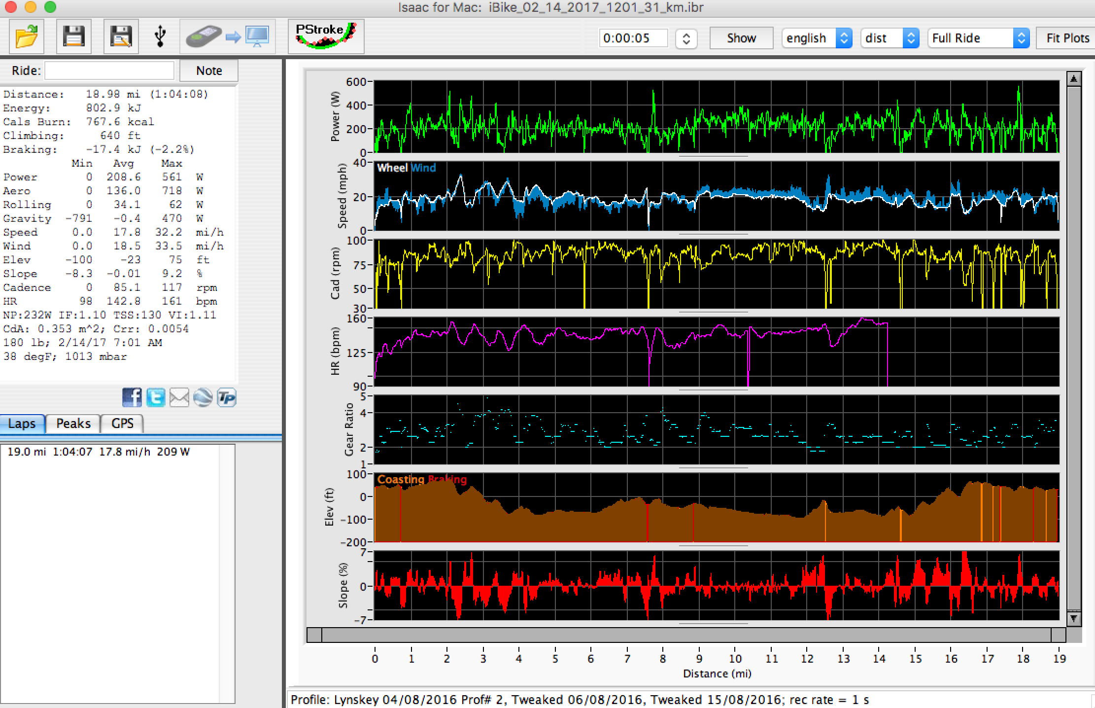

My winter wheels have been getting increasingly "crunchy" in the hub bearing dept so I decided to build some new ones (I had replaced the bearings a couple of times before so thought drastic action was needed) and quite apart from immediately noticing anecdotally the difference in smoothness and apparent speed the average power for the ride (according to Strava) was 220W versus 187W the last time I rode that route.
Now I doubt I've got *that* much fitter since last time (only a couple of weeks ago) so what should I do in terms of PP and its calibration? An out and back? Check calibration? Or is it possible that this new reading is actually the accurate one given how the old wheels must've been adding to unexpected resistances? They are comparable wheels in terms of width, weight etc, albeit completely different components.

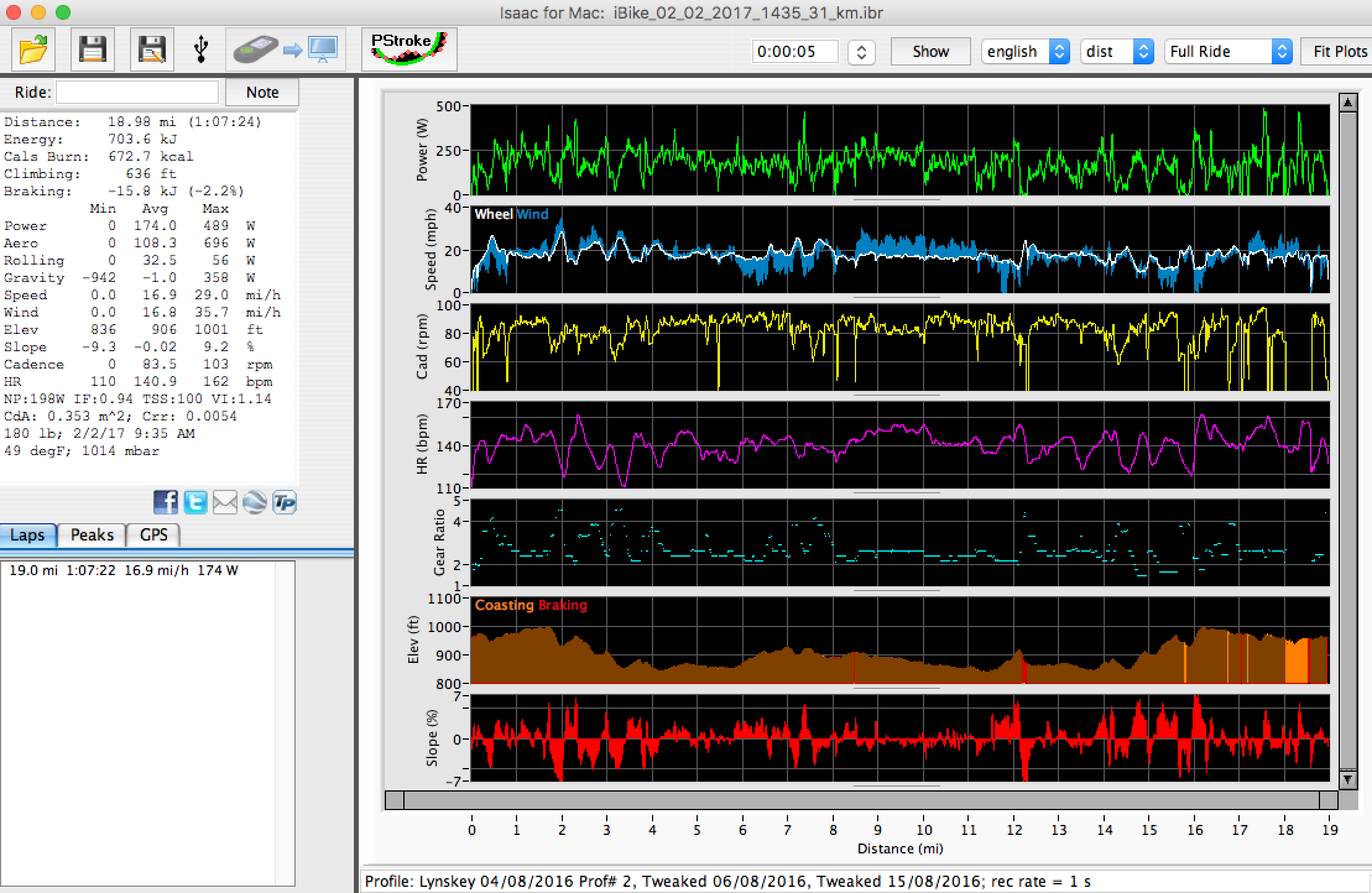

Ride files attached. The most recent one is from today (and if I do a "Check Calibration" it is suggesting a change hugely into the red, which is probably no surprise) and the older one is the last time I rode this route a couple of weeks ago.
nb - this is not technically an "out and back ride" although the first ~9km and last ~9km are effectively the same but in reverse.
- iBike_02_02_2017_1435_31_km.ibr
- Older ride on shot bearings...
- (228.23 KiB) Downloaded 355 times
- iBike_02_14_2017_1201_31_km.ibr
- Today's ride on brand new wheels, same talentless rider...
- (218.59 KiB) Downloaded 316 times

Your two files are revealing. I analyzed the first 7.5 miles, where your HR strap was working for both:
1) Your 2/2 ride file shows an average speed of 18.0 mph
2) Your 2/14 ride has an average speed of 18.8 mph
3) Your heart rate for the first 7.5 miles of your 2/14 ride is 140; for your 2/2 ride, 139. This means that (according to your heart) you were working equally hard (applying equal amounts of power).
So I think the answer is yeah, your new wheels have lower friction; this means that, for the same value of applied power, you'll go faster with the new wheels.
Have fun with your new wheels!

- Screen Shot 2017-02-14 at 10.52.39 AM.png (400.93 KiB) Viewed 5801 times
- Screen Shot 2017-02-14 at 10.52.24 AM.png (397.55 KiB) Viewed 5801 times

Leave your calibration alone. Your "old" ride files with the extra friction were too low in power.

For some mysterious reason Check Calibration is adjusting your riding tilt. I would not touch anything...
