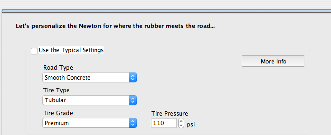

I'm using tubeless tyres, with sealant, on my road bike.
The setup in Isaac for tyres seems to need me to claim that these are standard clinchers with inner tubes, running at a lower pressure than standard.
I'm not sure if this is an issue or not in calculating power & Crr!
Re: Tubeless Tyres
It will have a minor effect on overall results.
In Isaac, in the "Device/Setup Newton" wizard, on the last screen use the settings below. This will get you very close to your configuration.
Screen Shot 2017-02-07 at 8.28.21 PM.png (52.97 KiB) Viewed 2293 times
