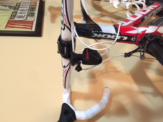

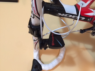

Your wind readings are really weird, and you have some dropouts in your speed readings.
Please post images showing how your PP is mounted for profile 4.

Re: Need a Little Help
I have attached a couple photos. Again this is for profile 4. I know the out front mount is suppose to be profile 2; but I was getting VERY low numbers from it. I assume the PowerPod is attached correctly. On profile 1 & 3 very accurate readings. Profile 2 and 4, weird power numbers.
