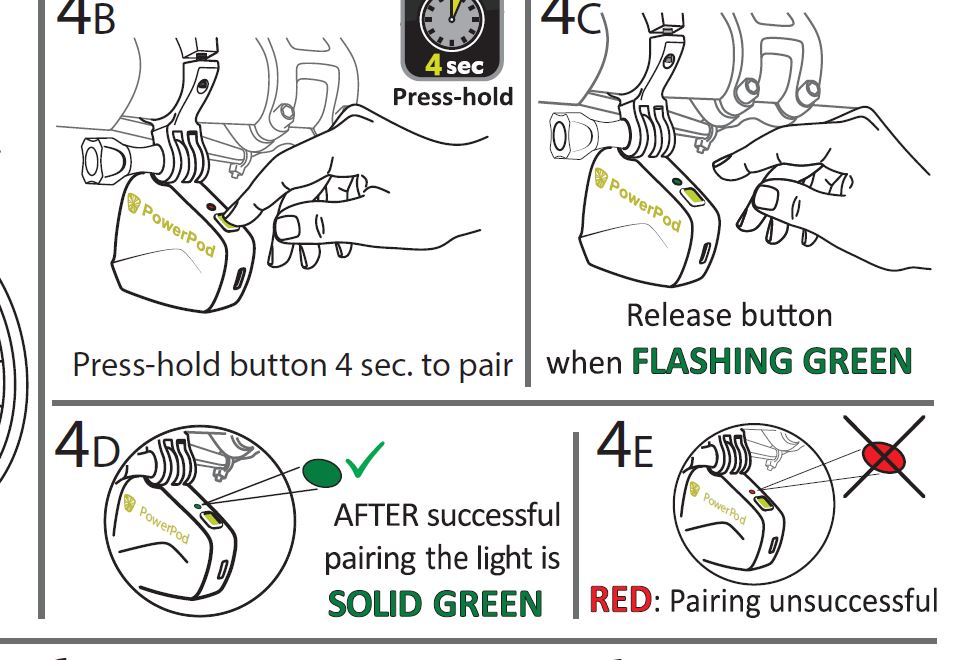

Solid green means the PP has paired with the sensors. See 4B to 4D
- PPod.JPG (116.69 KiB) Viewed 10301 times

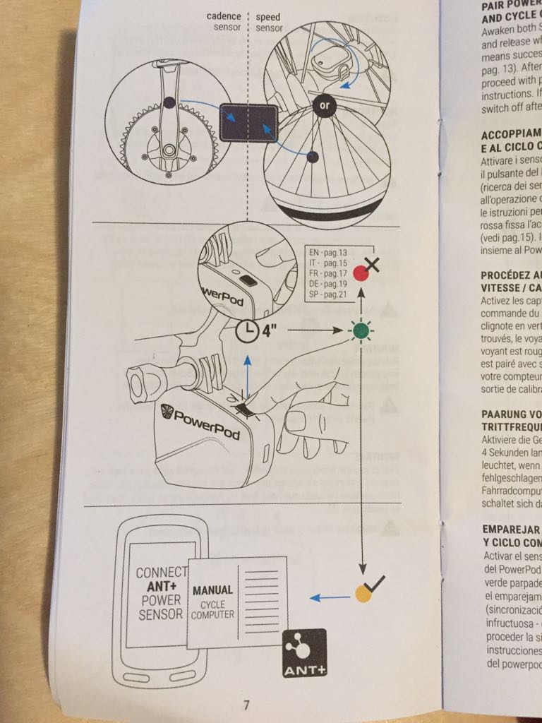

Solid green? Seriously? The documentation enclosed in my Powerpod says:
"Solid YELLOW light means successful pairing."
In addition to that, after my Powerpod displays a solid green light, my Lezyne Super GPS shows that it is searching for a power meter, but it never indicates that it has found one.

What instructions are you using? From where did you buy your PowerPod?the shovel wrote:Solid green? Seriously? The documentation enclosed in my Powerpod says:
Immediately following a successful pairing, the PowerPod light will show solid green. After a few seconds the light will go out. If you click the button again the light will show solid yellow, meaning that it is ready for the five minute calibration ride.
If your PowerPod shows solid red when you click its button then it has not been paired successfully.
If your PowerPod flashes green when you click its button, but does not turn solid green, then it has not successfully found the speed sensor.
Do the following:
1) make sure your speed and cadence sensors are awake
2) with the bike at rest spin the speed sensor wheel and confirm on your bike computer that you seed speed in the window
3) press-hold the PP button for about 4 seconds, until it starts to flash green.
4) when the speed sensor is found, the light will turn solid green, indicating successful pairing
5) let the light go out, then click the button. it should show solid yellow

I'm using the instructions that came with my PowerPod which I bought online from ProBikeKit.ca. The box says it's from Skopre, Exclusive European Importer and Licensee.
Just so you know I'm not crazy or colour-blind . . .
How does that change the instructions given that I get a solid green after it finishes going through the pairing process (and doesn't pair)?

We are not crazy about these instructions. They attempt to show that, after successful pairing, the light is solid green. Then, subsequently, when you click the button it is solid yellow.the shovel wrote:I'm using the instructions that came with my PowerPod which I bought online from ProBikeKit.ca. The box says it's from Skopre, Exclusive European Importer and Licensee.
After pairing, when you click the button, what color is the light?
