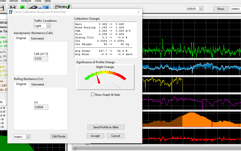

Edit: hmmm, I just downloaded the ride file (attached) and it is doing that thing where it loses the cadence (in this case for about half of the ride). The cadence stats are there in Strava.
Also, when I run "check calibration" is seems to be suggesting that my average power is only 85W or something (i've attached a screengrab).
"Help!!!"
"Help!!!"

Thanks... Our posts may have crossed there, not sure if you saw my second post with the screengrab?

Your lost cadence is causing average watts to drop in the Check Calibration feature.
The cadence signal in your PowerPod is very noisy. This should not be the case.

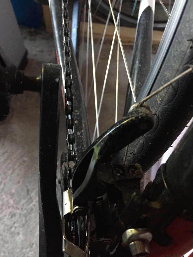

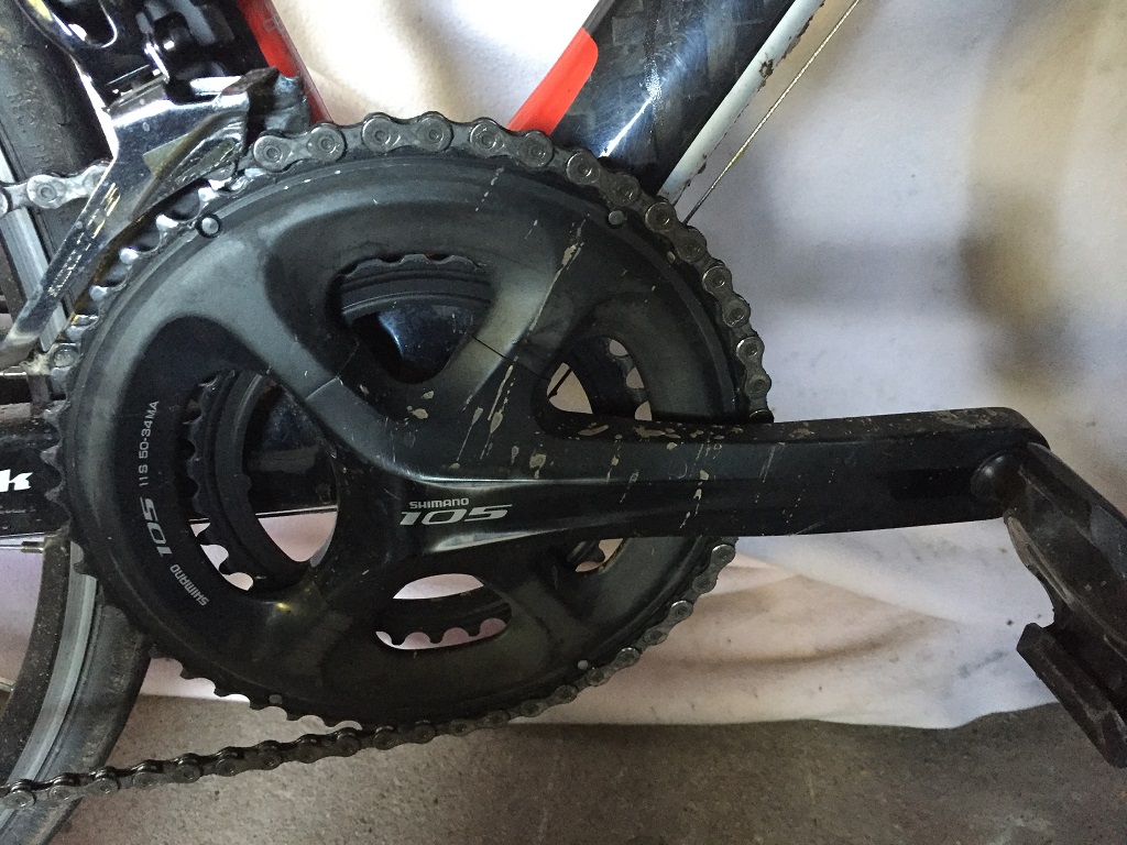

I am using the new style separate Garmin sensors. The green lights flash when spun up and the batteries weren't replaced that long ago.
Speed sensor is on front hub, cadence sensor is half way down the NDS crank arm.
PowerPod is underneath the Garmin on a K-Edge combo mount.
I can take pics later if you need more, thanks! FWIW there appears to be no dropout of any of the sensors in the ride on Strava.
Re: Profile numbers and second bikes etc
If you can, move the cadence sensor to the other crank arm.
Really? Isn't the cadence sensor meant to be on that side? Surely the chainring/spider etc is in the way and would either foul the chain itself or just not go round the arm? It is a 5800 Shimano 105 chainset. Attached are two pics, excuse the dirt/mud, this is now on my winter bike.
- IMG_1275.JPG (242.33 KiB) Viewed 14139 times
- IMG_1273.JPG (286.31 KiB) Viewed 14139 times

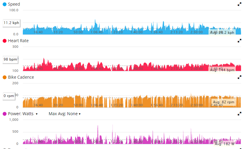

Would you looking at my strava trace help at all? i.e. Would you expect to see this "noise" there too if it was a problem with the cadence sensor?
I'm in the UK I'm afraid how would we swap it if came to that? Do you have a distributor over here? Hopefully won't come to that I'll try another reset and keep an eye on it. Strava seems to be reporting power ok from what I can see so it's only Isaac that is throwing a fit!
Strava data won't help because they so heavily filter everything. By the way: how are you getting cadence data into Strava? From Isaac ride files? From your bike computer?
Data is recorded on Garmin Edge 100 which is then uploaded to Garmin Connect which in turn is synced to Strava automatically.
I've attached what it looks like in Garmin Connect...
- connect.PNG (54.97 KiB) Viewed 14131 times
