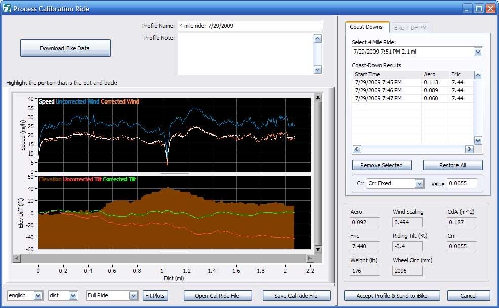

When I download my Cal ride and coast downs I get a grayed out screen saying "using cal ride calibration from unit for setting in iBike. Select Crr fixed or adjusted to analyze here." Which should I use? (Is this explained anywhere... I couldn't find anything on it.) I chose Adjusted (I think) and that ungrayed it and let me upload the cal processed cal ride back to the unit. The use setting from iBike has the tilt way off.

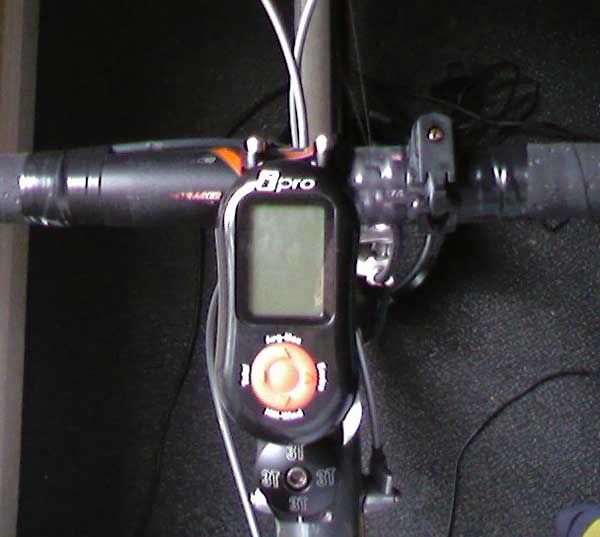

Unless you weigh 110 pounds or less, the aero and cda numbers are still way off. (For reference, my cda on my time trial bike, with zipp 808s and an aero helmet, is around .229 and I'm 5'9" and 154 pounds).
That wind scaling number is on the low side too. Part of the problem might be that you have the unit mounted too far back on the stem, but something is off.

Thanks for the info R Mc, very helpful. I'm a little over 110 lbs, 5'6" and 150 lbs, so Cda should be a lot higher. The road was a normal, wheels are semi-aero (Rolfs) and tires are new Michelin Pro 3s. So I guess I should move the unit further forward and repeat the cal ride and CDs and see what I get.
My current mount, looks fairly clean:

I have not changed anything and did a 63 mile ride today and the watts are reading low (probably the low Cda), obvious from the avg power of only 119w even though we did a lot of tempo. Tweaking Cda in iBike 3 overriding the 0.1045 with 0.275) gives a much more likely avg of 165w.
I'm considering doing a two step calibration process. Since my Cda is low and the Crr seems high, I'm thinking of using method 2 to get an accurate Cda (with Crr fixed at 0.0055). That will give me a pretty good Cda which I'll note. Then I'll try method 3 and see if I can get a reasonable number for Crr (and a Cda around the one from method 2). I can always override the Cda from method 3 with that determined in method 2 if it comes out significantly different using method 3. (I'm assuming there's no way to fix Cda at that given by method 2 and just doing CDs to determine Crr.)
