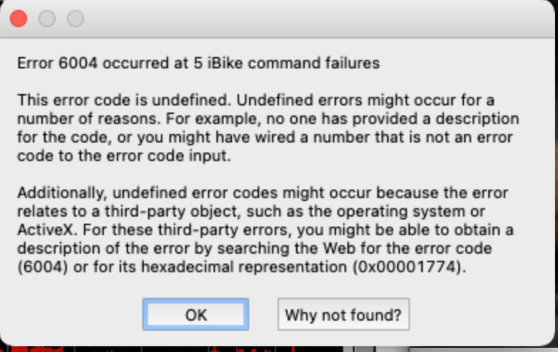

hello, I installed the Isaac software on my iMac and it everything looked ok. I can make contact with the powerpod v3.
Nevertheless when I tried to download a ride, I got an error message.
See picture
What can I do?
thanks
kurt
See picture
What can I do?
thanks
kurt

Re: How to install Isaac on an M1 Mac (or Intel Mac running MacOS 11 or 12)
Try another download.
If that does not succeed then it looks like the file structure in your PP has been corrupted. You will need to erase your ride files with the Device/Erase All Ride Files command, then do new rides.

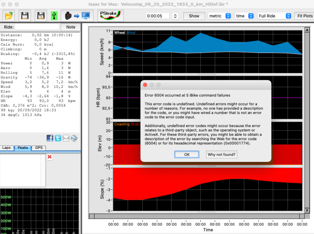

Hello,
I did a 74 km ride. The download worked on my windows pc but not on my imac. I got the following error ( see attachment). Did I do something wrong with the installation
Try downloading your ride file on your Mac one more time.
If that doesn't work then reinstall the NI and SiLabs drivers. Make sure you follow the installation instructions exactly.
