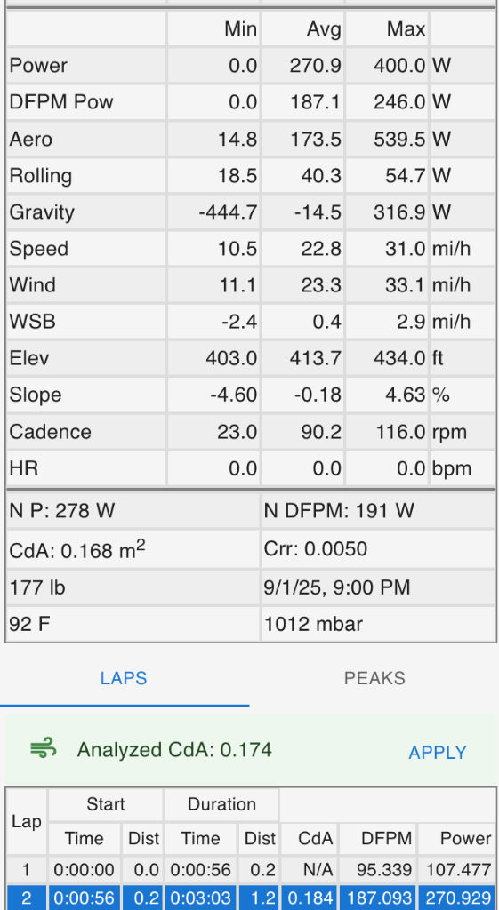

We just noticed that in your ride file 9/1 17:57, that you are not stopping the lap at the same physical location where you start the lap.
How do we know? Your starting elevation (404' for these laps) and stopping elevation (433') are DIFFERENT.
Here is lap 2 (the other laps show the same elevation difference between starting and stopping point).
You must start and stop each test lap at the same physical place. When using profile 4, if the start/stop point is different, the CdA measurements will be incorrect.
Your Garmin .FIT file includes GPS information, and you can merge GPS data into your AP data. Please do this for future rides. It will help us see where you are starting/stopping your test laps.

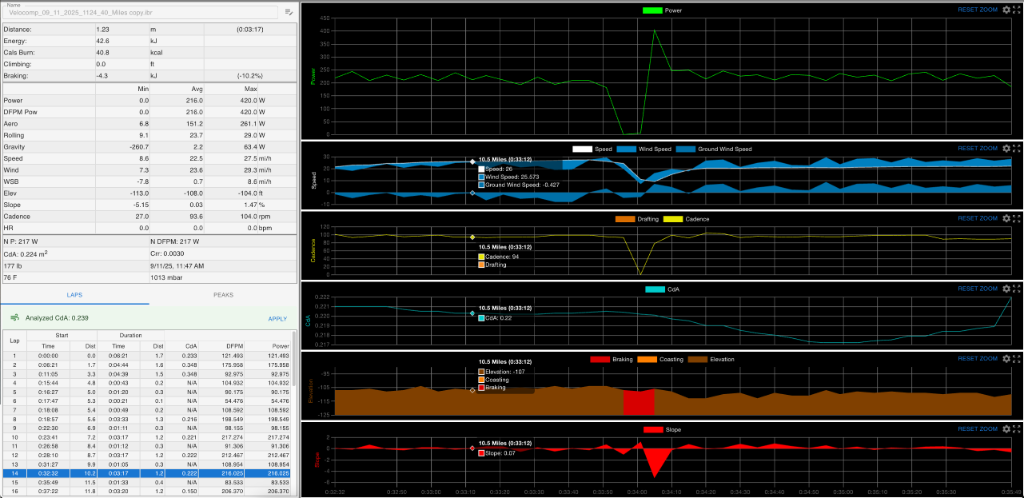

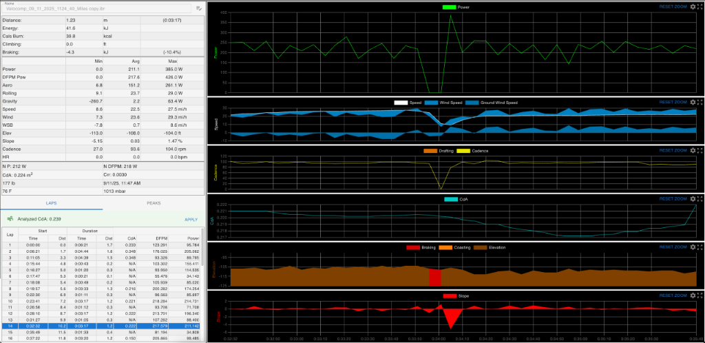

^ In addition to that, I just noticed that the power graph shown in the .ibr file fetched from the device is different from when I import power into VA from my bike computer's .fit file. The latter has much less fluctuation. I wonder if this is contributing to some issues?
Here are two screenshots comparing that for Lap 14 (I've noticed this behavior across all laps)

nikshar wrote: Thu Sep 11, 2025 10:03 pm ^ In addition to that, I just noticed that the power graph shown in the .ibr file fetched from the device is different from when I import power into VA from my bike computer's .fit file. The latter has much less fluctuation. I wonder if this is contributing to some issues?
I'm looking now at your 40 mile ride data.
The likely difference between the .FIT and AP data is your Garmin has some kind of smoothing factor set for power sensor data. The data the Garmin receives is identical to the power data received by AP. AP records raw values; smoothing is done in VA.

The smoothing of the power data can be configured in the AP profile, if I remember correctly, by default it is dynamic. If it is set to 3s or 5s, then Garmin will receive the smoothed data, won't it?

And Garmin can be configured to smooth Power data, too.

HDPWR wrote: Thu Sep 18, 2025 1:59 am The smoothing of the power data can be configured in the AP profile, if I remember correctly, by default it is dynamic. If it is set to 3s or 5s, then Garmin will receive the smoothed data, won't it?
Good catch! Yes, power transmitted by AP to Garmin will be affected by smoothing setting in profile. However, the data recorded in the AP file is not smoothed.
