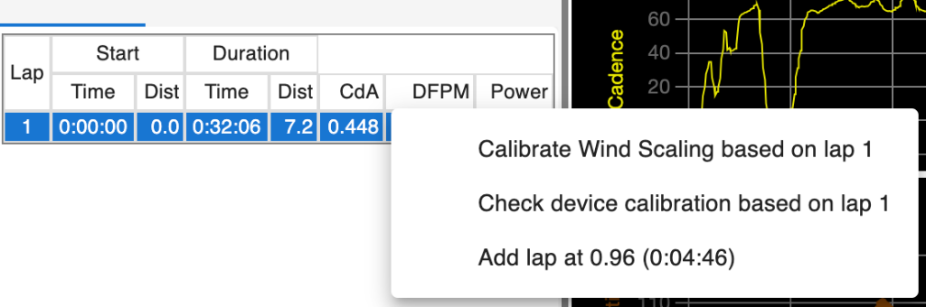

You can add laps to any file as follows:
1) Click on the lap tab. The data will turn white
2) Select where you want to add a lap
3) Hold the Option key and click on the white data. You'll see something like
this:
drjohnson@innovationsmedical.com
4) Select "Add lap..."to create a lap marker at the location you selected

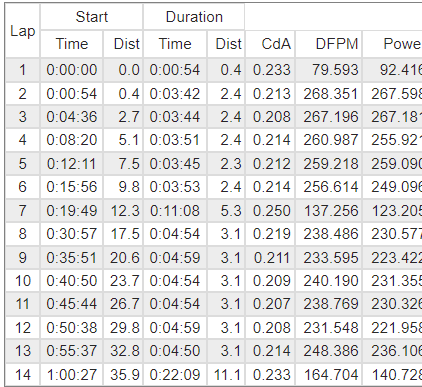

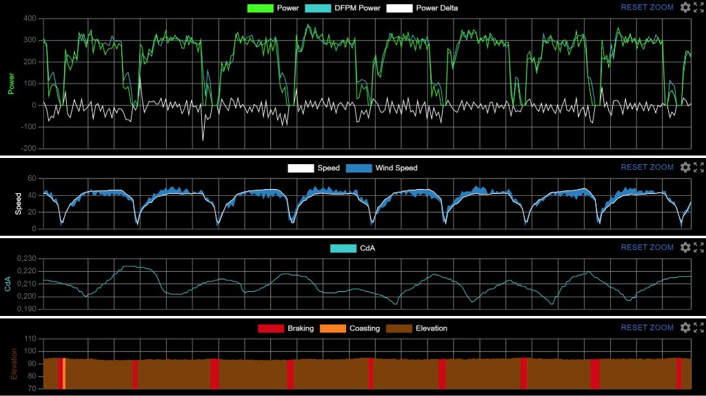

So I did my first test yesterday and I am a little bit disappointed.
I used Profile 3 with no Garmin device to mark laps and the test route was a straight and flat approx. 1.5km long bike path segment. It is not too wide, in order to turn back I have to really slow down.
First I did 5 laps with a focused middle 1km part where I was fully in position with a target of 300W. For these laps I added approx 100m to slow down and turn around. This means usually to brake intensely from 48km/h to almost 0. As you can imagine, I completely changed position for the braking and also reduced the power output dramatically.
Analyzation: the great thing is that the calibration seems to be perfect and data is good. However, I can see a huge moving average with a window of approx. 2 mins. My laps look like these:
A significant rise in CdA at the turning point, but clearly averaged over a wider span. This makes my data unusable because as soon as my CdA would settle, there is again a turning point and the moving average gets into action. I also tried cutting out the 1km-long legs and put them together, but then I could clearly see that the CdA data was already averaged by the Aeropod and not by the VA software.
After the first 5 laps I did 6 other with extending the length of the braking phase to 250m. So basically 250m accel - 1km focused leg - 250m decel. This was way better, I had more time to brake, turn, accelerate and get into position. As you can see, the situation with the moving average was the same here, too.
I attach the laps table and the advanced data of the first 5 laps.

I attach the cut-out of my first lap, the out and back 1km legs combined. Here you can see again that the CdA would settle in the middle. Side notes: my position was not fully fixed, hence the big difference in the min CdA out and back.

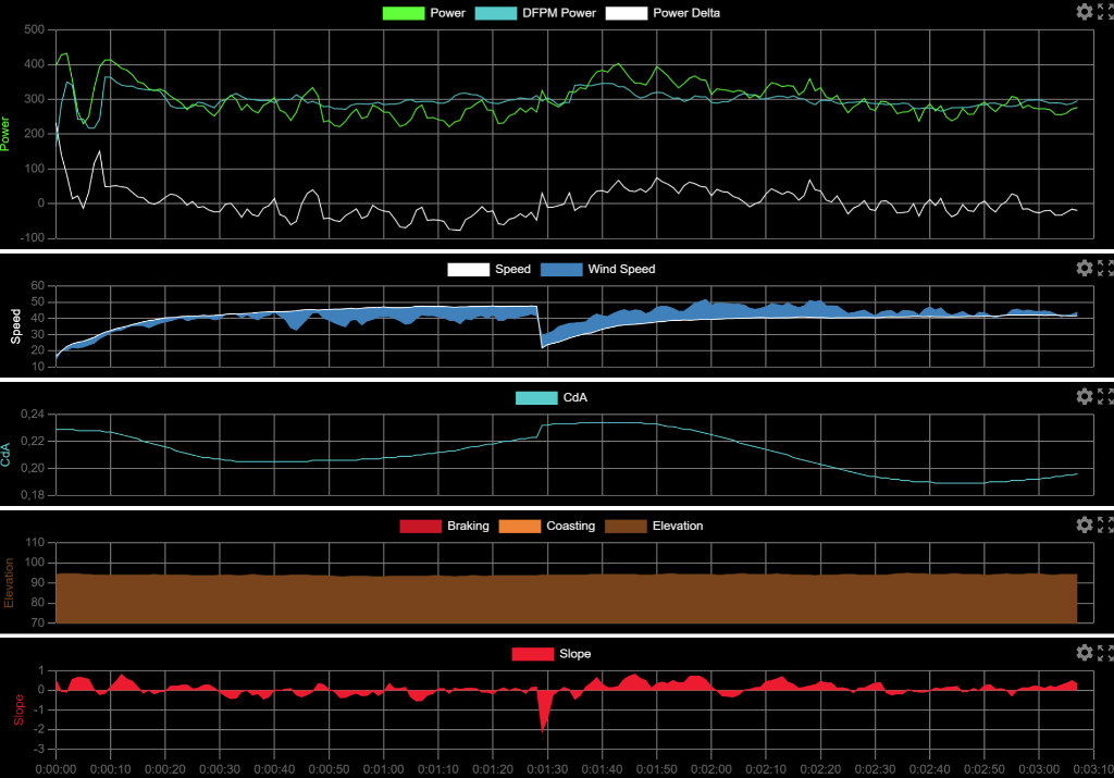

For some reason the forum doesn't let me add more than 3 pics.

With respect, I think the problem is that the data is not being interpreted correctly.
The whole purpose of the out/back test is to provide enough data to average out second-to-second changes as the route progresses. You seemingly are expecting the data to be exactly the same, with no CdA change during the test. If that were really the case then there would be no need for extended tests or repeated tests.
More data is better--that is the central principle guiding CdA analysis.
So, let's take a look at your data from this perspective. You have 8 laps (good!) where you repeated the same configuration. Here they are (lap number and CdA for the lap):
3 0.208
4 0.214
5 0.212
6 0.214
8 0.219
9 0.211
10 0.209
11 0.207
Lap 8 is a bit of an outlier (that can happen); discard it and the average CdA of these other 7 laps is 0.2107. Call that 0.211. The standard deviation of these 7 laps is 0.003, so you can say with 95% probability that your CdA is 0.211 +/- .003. This result is with profile 3, which does not have quite the precision of profile 4. Profile 4 can reduce the standard deviation...
Outdoor CdA measurement is really difficult because of natural variations in wind, slope and road surfaces. This is why velodromes are used (they mostly eliminate these variables). If you go to other alternatives such as wind tunnels or even other aero sensors in velodromes all of them will give you a number, but none of them will offer this kind of detailed analysis or ability to review and understand. And frankly I'm not sure any of them would deliver you a meaningfully more useful CdA measurement (though they might claim it).
I think you've done a good job, and you did it without the extra precision offered in profile 4. Well done!

Yes, I expect only a very minor change in CdA during the 1km leg, where position, power, conditions, etc are all constant. Let's say between 0.2 and 0.205 for example with 3s moving average, but of course the longer the leg, the better it is for calculating an average. However, when I calculate the average then I want to take into consideration the segment only where the conditions were constant, in my case it is the 1km leg and not the entire lap, because I cannot guarantee and control all the factors for the braking and turning around phases. Plus, after more than 30 mins at race pace, it is really hard to fully focus on keeping the same position and timing for the braking and turning.
By the way you just nicely avoided my question regarding Profile 4. :) Previously you mentioned that in Profile 4 there is access to raw data from FW. Could you say something about that and my assumption about the window of moving averaging in Profile 3? Perhaps in a private message or email?
With respect, I think the problem is that you don't try to understand my case. I am a fairly good amateur racer and would like to fine tune my position on the bike. Just like any professional, I am not expecting huge gains in terms of CdA. Let's say my initial CdA is 0.2, if I can make it to 0.19 then I did an amazing job. At 300W input, that would save almost 15W. So during my test runs, I am not expecting more than a 0.005 difference between the average of two sets of laps with different positions. During the braking and turning, I guess I have a CdA around 0.3, huge difference and it influences the average pretty badly. In my opinion it would be absurdity to expect one to lock in and out from the TT position with utmost precision in order to have the exact same timing and position for braking. Maybe with a 5km long leg it would be acceptable, but there is no such option around my location plus in that case a maximum of 3 laps (3x10km) could be performed on the same day at race pace and well-maintained race position.
Regarding my test, I didn't attach the picture of all laps, here it is:
As I wrote, I first did 5 laps - lap 2 to lap 6. First 2 with position A, last 3 with a different hand and head position (position B). Averages are 0.2105 vs 0.2137.
And then some rest in lap 7, then 6 another laps - lap 8 to 13. First 3 laps again with position A. Last 3 laps with position B. Averages are 0.213 vs 0.21.
Can you tell me, which position is faster? :) Based on this data, it would be just guessing, but I am pretty sure there is difference, it is just blurred by the braking the turning.
