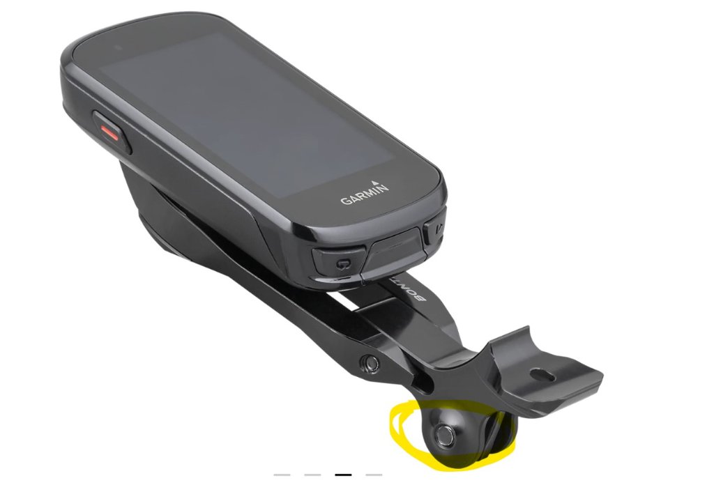

I have a new Trek Speed Concept Blendr Duo Base and Computer Mount and wanted to know what to select for Profile 4- Device Mount Location (Handlebar, Stem, Remote Wind Sensor, or Front Mount)?
Below are some pictures of the mount. On the bottom you can attached the GoPro mount to attach the Aeropod.
https://www.trekbikes.com/us/en_US/equi ... t/p/42018/
Pick of mount w/ highlighted gopro mount location
Some good pics of the mount-
https://www.bespokecycling.com/build-ga ... -concept-3
Also- do you think this mount will be stable enough?

I think this mount will be fine; where your PP/AP attaches is very close to where the mount connects to your handlebars.
You can select "stem" for the location; when you do your calibration ride everything will be corrected as needed.

Thank you John. I have the Trek Speed concept mount all setup and working now. See the 3 photos below. I will start working on collecting data with this setup soon-
Re: new Trek Speed Concept Blendr Duo Base and Computer Mount and Device Mount Location
I can't tell from the photos how the mount is attached to the handlebars. If the mount is stiffly attached the handlebars this is fine; if the mount is attached to the aero bars this won't work correctly, because the aero bars flex.
Please show photos showing how mount is attached to bike handlebars.

The mount attaches to the aero extensions. See the two photos. Do you think this is ok?
You can try using this setup, but because the mount is attached to the aero bars, it is very likely that the aero bars flex, and will cause problems for AeroPod.
The best place to attach AP is underneath the stem. We have a mounting solution for this configuration; email technicalsupport@velocomp.com for details.
