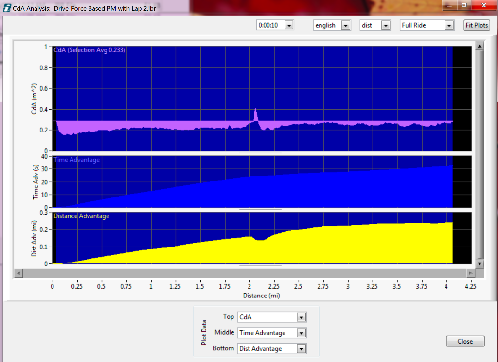

3) For each lap, I used the Tools/CdA Analysis command to determine the Isaac-calculated CdA for the lap. For example, for lap 2, the Isaac-measured CdA is 0.233

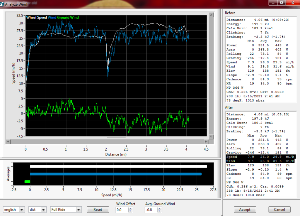

4) I then used the “Analyze/Analyze Wind” command to adjust wind speed. When I open this window for Lap 2, it shows that average ground wind speed for the lap is -0.7 mph less than average bike speed (25.3 vs 26.0, highlighted in black).
Screen Shot 2021-08-16 at 1.04.20 PM.png (289.3 KiB) Viewed 5025 times

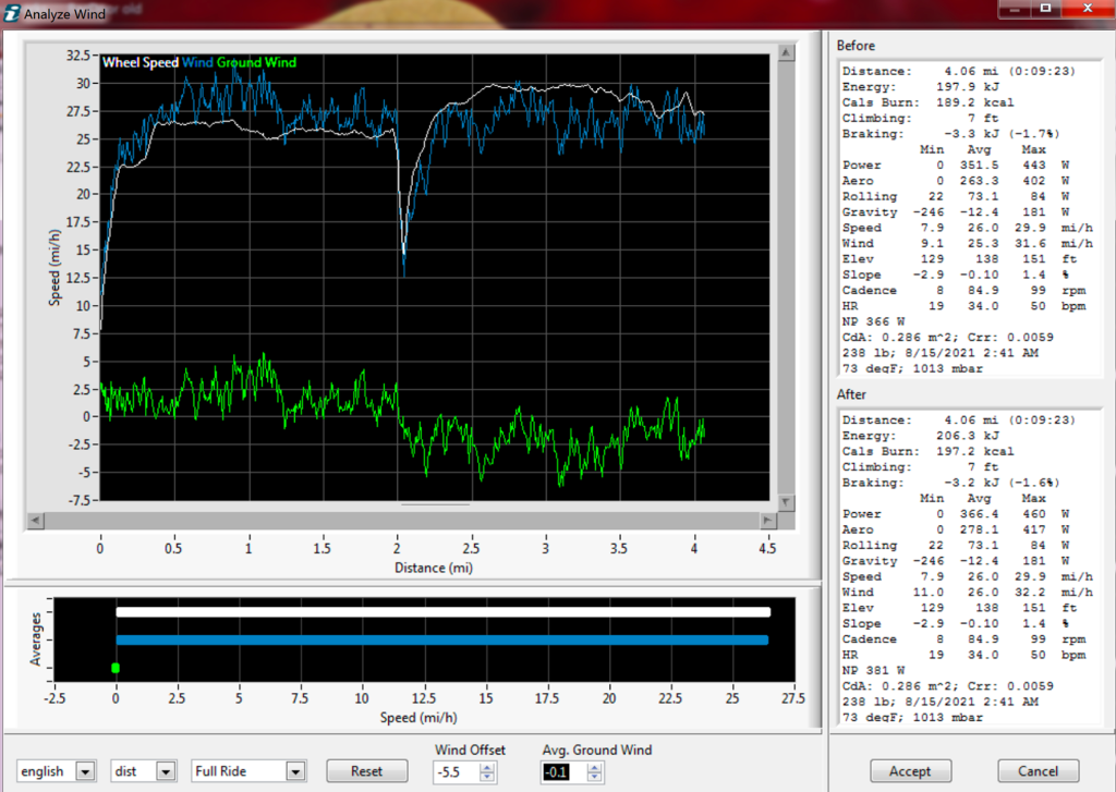

5) In the Avg Ground Wind window at the bottom of the page, I adjust the offset from -0.8 to -0.1 (increase wind speed by 0.7 mph). Note that Average wind speed is now 26.0, and watts have increased from 351 to 366
Screen Shot 2021-08-16 at 3.24.03 PM.png (348.19 KiB) Viewed 5025 times

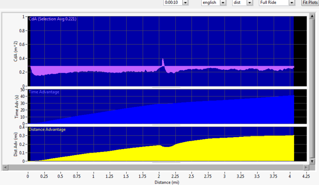

6) I click Accept, then go back to “Tools/CdA Analysis”. CdA drops from 0.233 to 0.221. Why? The average opposing wind is higher, forcing opposing watts to be higher, forcing CdA to drop accordingly.
Screen Shot 2021-08-16 at 3.25.51 PM.png (96.53 KiB) Viewed 5025 times
7) So, the CdA effect of the wind speed correction is to reduce the CdA by 0.233 to 0.221, or by 0.012

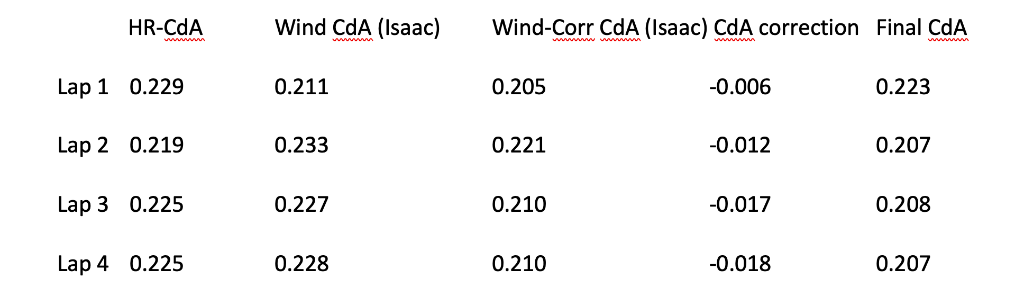

I applied the above steps to all four of your laps. Here are the results:
Screen Shot 2021-08-16 at 3.31.45 PM.png (45.65 KiB) Viewed 5021 times
As you can see, the only outlier CdA is lap 1. Why is this? When doing CdA testing, the first out-and-back lap may have more tilt correction than the subsequent laps. In other words, for the first test of any day, it’s best to do two laps, before changing things. So, laps 2-4 are the ones to investigate.
Laps 2-4 show a very consistent CdA of 0.207. Maybe lap 3 is 0.001 higher (different helmet) but more data would be needed to zero-in on the difference.
The wind correction feature will soon be implemented in a firmware update, getting rid of all of this manual manipulation.
But in the mean time, you can see the kind of consistency that is possible!
