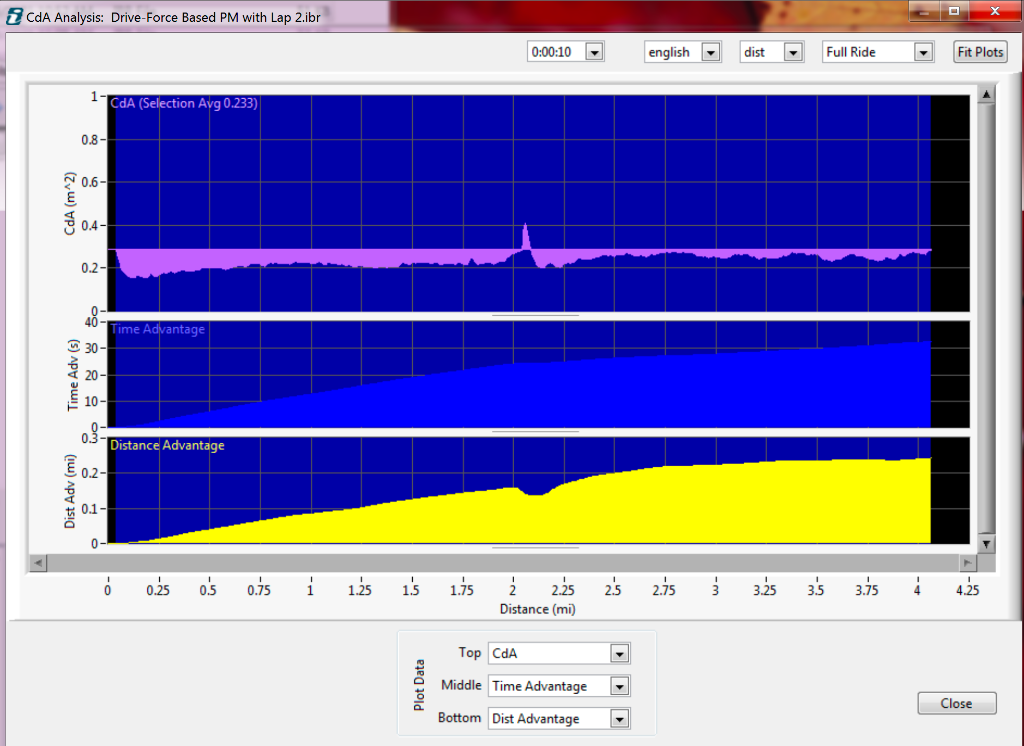

3) For each lap, I used the Tools/CdA Analysis command to determine the Isaac-calculated CdA for the lap. For example, for lap 2, the Isaac-measured CdA is 0.233
Screen Shot 2021-08-16 at 12.56.54 PM.png (155.46 KiB) Viewed 4992 times

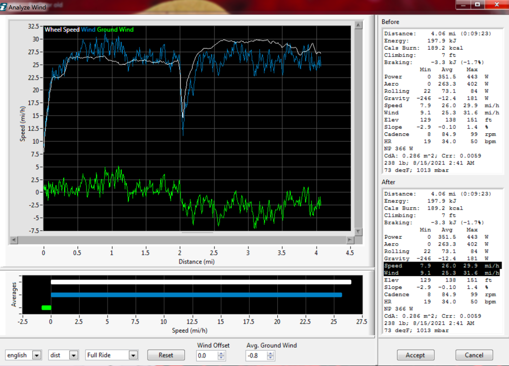

4) I then used the “Analyze/Analyze Wind” command to adjust wind speed. When I open this window for Lap 2, it shows that average ground wind speed for the lap is -0.7 mph less than average bike speed (25.3 vs 26.0, highlighted in black).
Screen Shot 2021-08-16 at 1.04.20 PM.png (289.3 KiB) Viewed 4992 times

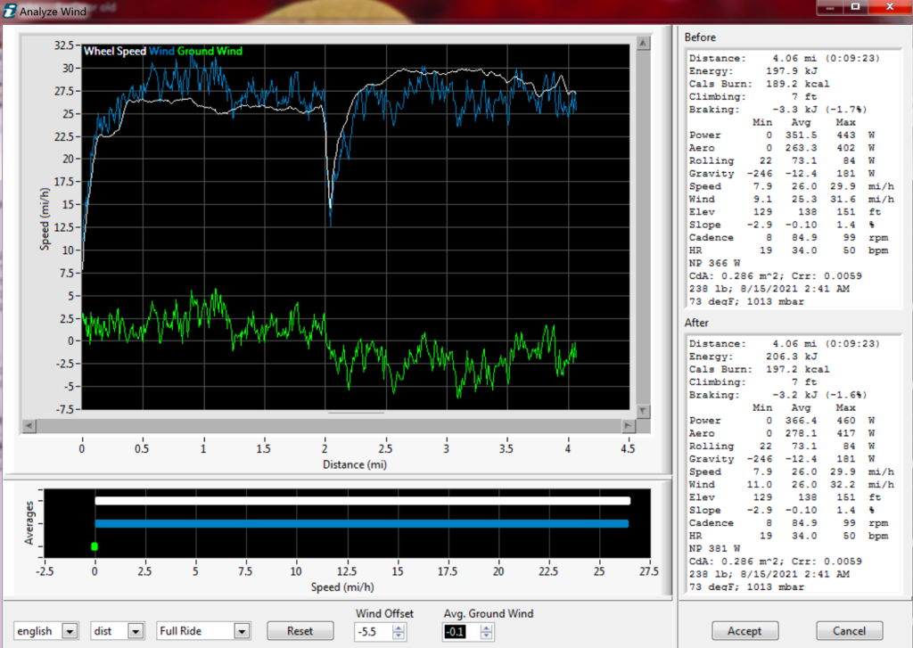

5) In the Avg Ground Wind window at the bottom of the page, I adjust the offset from -0.8 to -0.1 (increase wind speed by 0.7 mph). Note that Average wind speed is now 26.0, and watts have increased from 351 to 366
Screen Shot 2021-08-16 at 3.24.03 PM.png (348.19 KiB) Viewed 4992 times

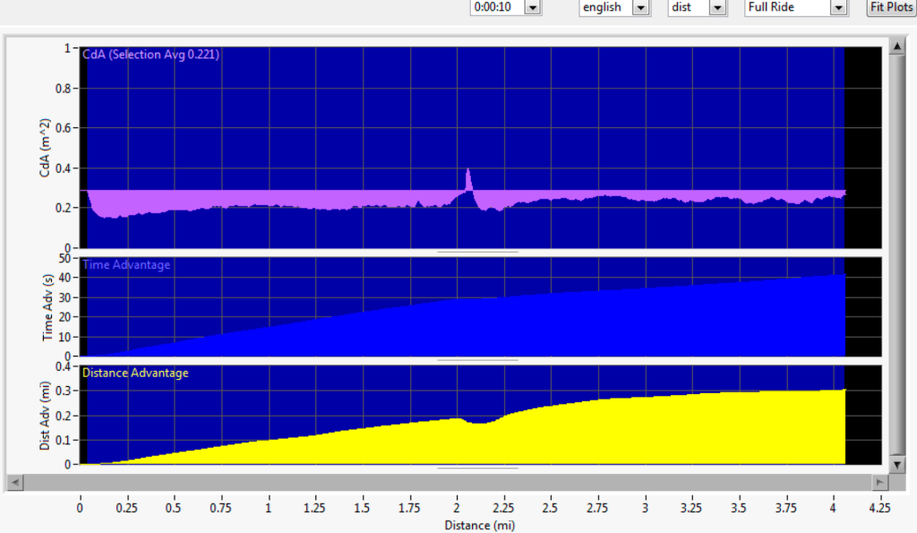

6) I click Accept, then go back to “Tools/CdA Analysis”. CdA drops from 0.233 to 0.221. Why? The average opposing wind is higher, forcing opposing watts to be higher, forcing CdA to drop accordingly.
Screen Shot 2021-08-16 at 3.25.51 PM.png (96.53 KiB) Viewed 4992 times
