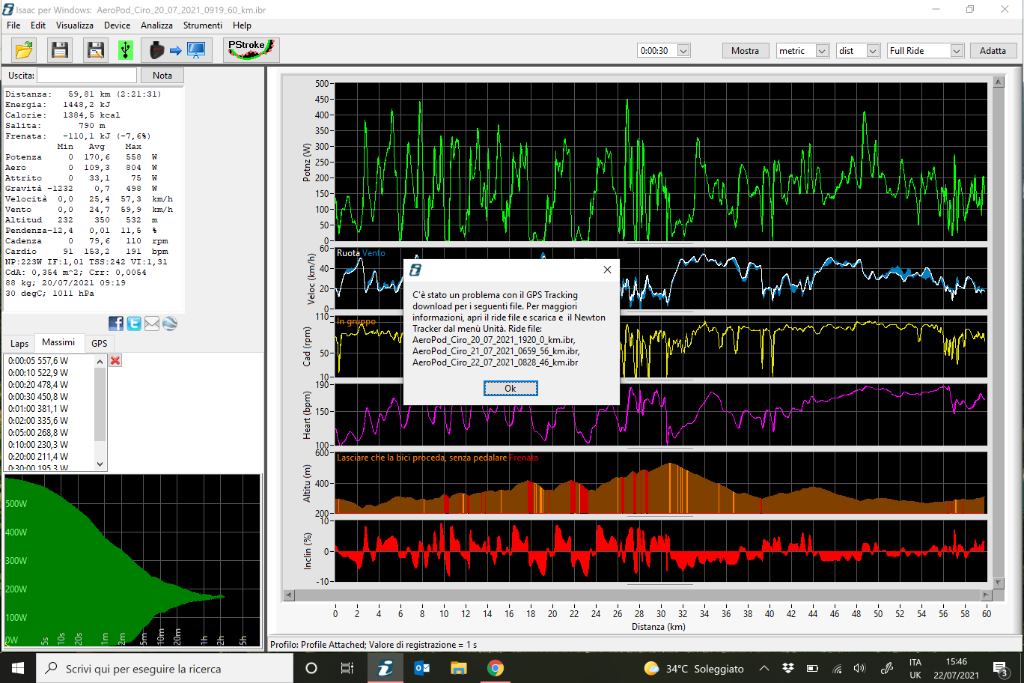

Good afternoon, the AP seems to work fine but when I download this message, can you tell me how to fix?

- Screenshot (9).png (288.37 KiB) Viewed 8794 times
Re: Nuovo AeroPod
The error message is in Italian so I can't translate.
From what I can guess, it appears that you are using the Newton Tracker app and that the GPS files associated with your rides can't be found.

Re: Nuovo AeroPod
Yes, this is coming from Isaac looking for a GPS file.
In my Power Pod 4 I can get the same error message if I am logged in to the GPS tracker application - VeloTrack - while in Isaac - and did not enable to collect ride data - or never started the mobile app on the iPhone.

Re: Nuovo AeroPod
Today I downloaded the last 3 or 4 races ... First I logged out from one of the first ISAAC menus regarding GPS tracking and the error did not occur. I'm typing from my cell phone and possibly post a photo from my PC if needed. Greetings Ciro
