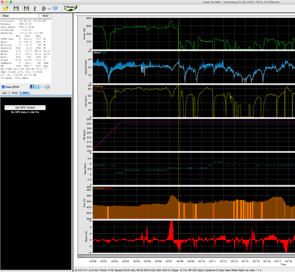

Click on the AP, roll down to start of calib ride. Stop. Go. Watts go to 50. Stop. Turn around. 70 W reached where it should be, finish should by 100W.
In theory calib ride finished - but as Garmin switches to "live data" power seems to be twice as it should be.
Frustrated (I know how 600W feels) I finish the ride. As I plugin the AP - I get 3 files. Attached.

The power numbers you see on your Garmin are the DFPM numbers. So, it's your DFPM that is incorrectly reporting 600W!!
This is confirmed in the ride file.
What kind of DFPM are you using?
In your ride file, at the 7:51 mark, you stop pedaling briefly, then resume. When you resume pedaling your DFPM watts become normal. My guess is that, during the zero pedaling, your DFPM's calibration was corrected in the DFPM sensor. AP does not "touch" DFPM calibration.
AeroPod is working properly but, as we say in the instructions, your DFPM has to be calibrated too.
Let me know what kind of DFPM you have. That might suggest an approach to get things working.
